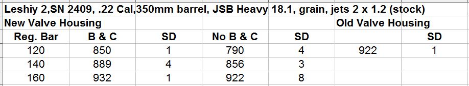

I found the non-EAR old style valve housing to do a bit better than new edition, be it with or without the dog bone and collar

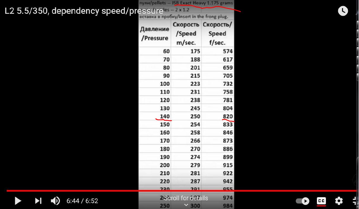

FWIW, my REPR .22 250mm L2 @140 BAR shoots 18.1s to ~840 FPS and 15.9s to ~870 FPS
20 fps better than Ed's test with the 350mm at 140 bar!

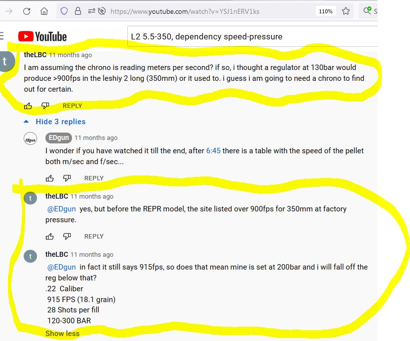

I really don't understand how Ed got those low numbers, and I'm not the only one, theLBC from the comment string get 915 fps with reg at 120 bar
Ed also did same test the 250 mm barrel but did not post the exact numbers in a chart but 140 bar was 768 fps (234 m/sec)

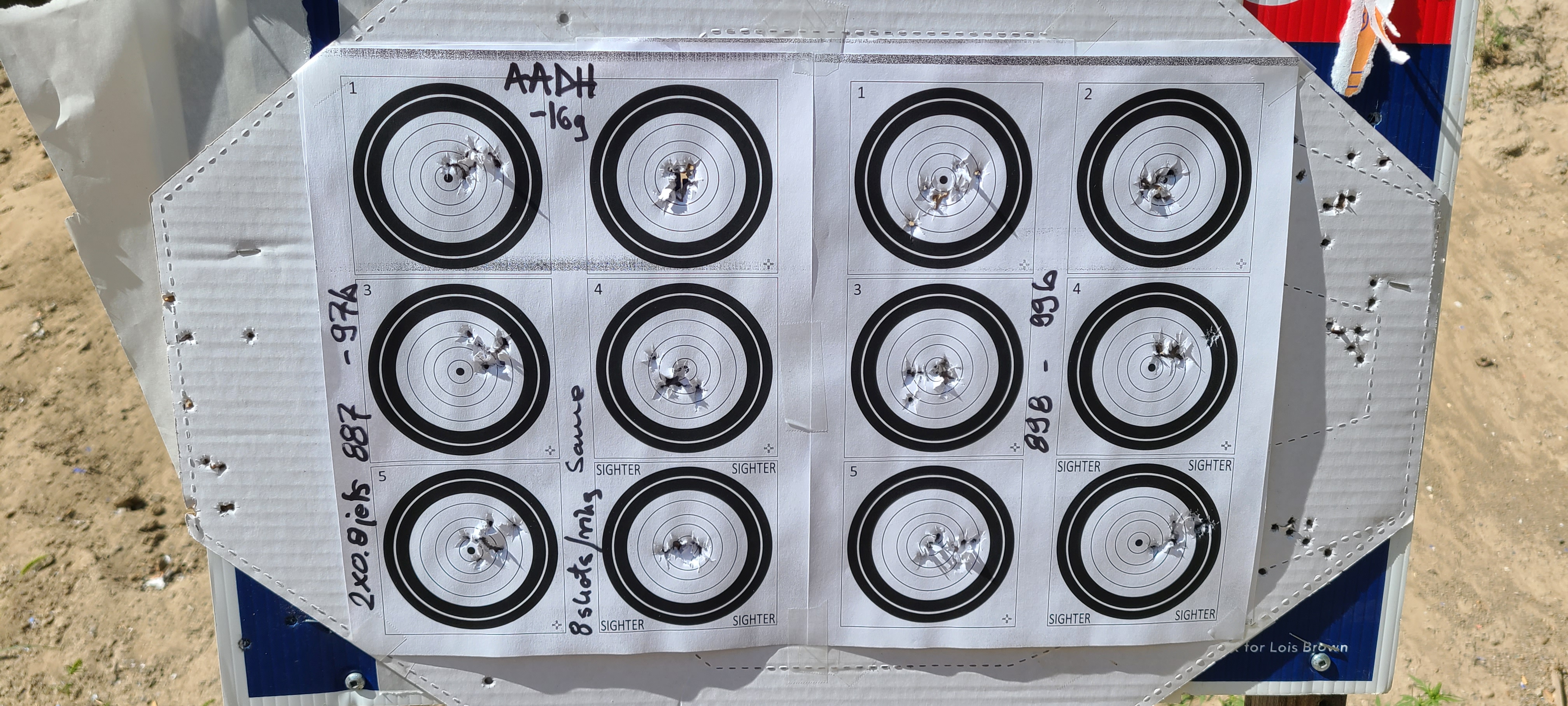

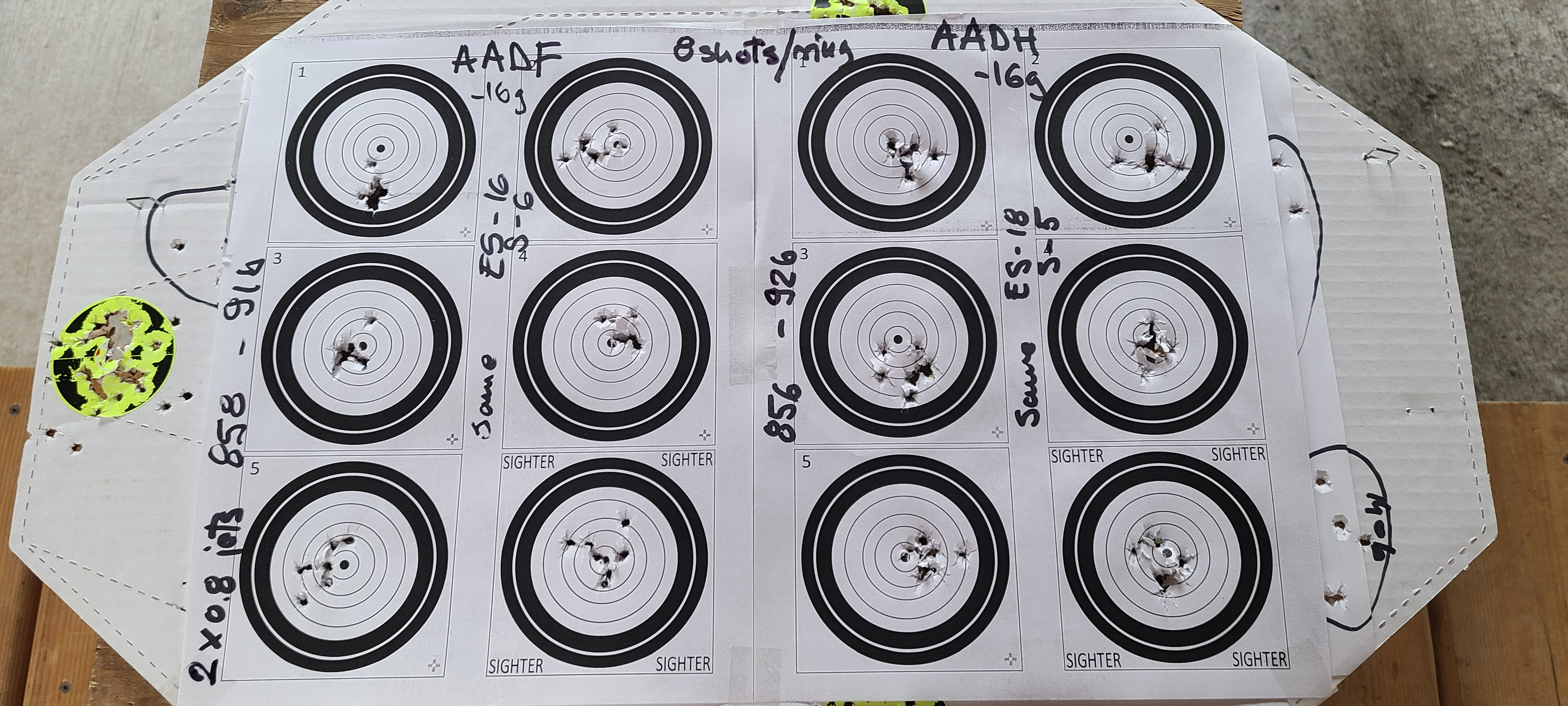

These are only my sample rings from 50 meters = 55 yards, and I have dozens more, the evolution how I got here without flyers.
The current setup is with HN FT and Hunter 16gr pellets, 91 bar on REPR, 2x0.8 jets, the speed is in range between 860 and 930.

So to recap, short barrels (350-450) generate and release a big amount of air blast coming out of the muzzle and that will make the pellets tumbling. Look at the lower picture (that was the oldest I cannot reorder)...the most left column was shot from a bare barrel, next to R I mounted a shroud (with internal rear facing stripper), the next R I added an airstripper... and the next R was just a test with different LPVO scope.
