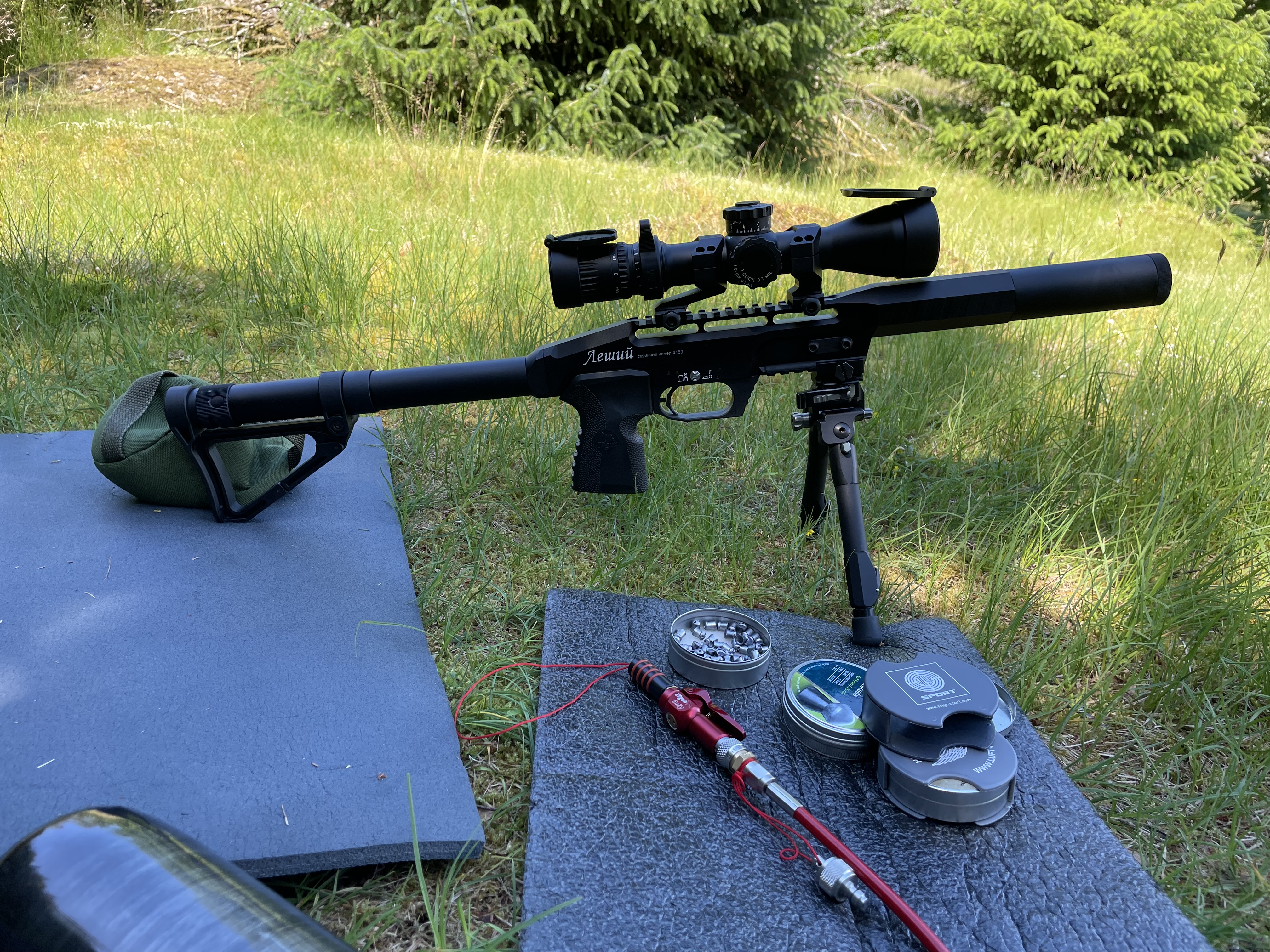

Anyone tried shooting slugs out of their .25 calibre Leshiy Classic?

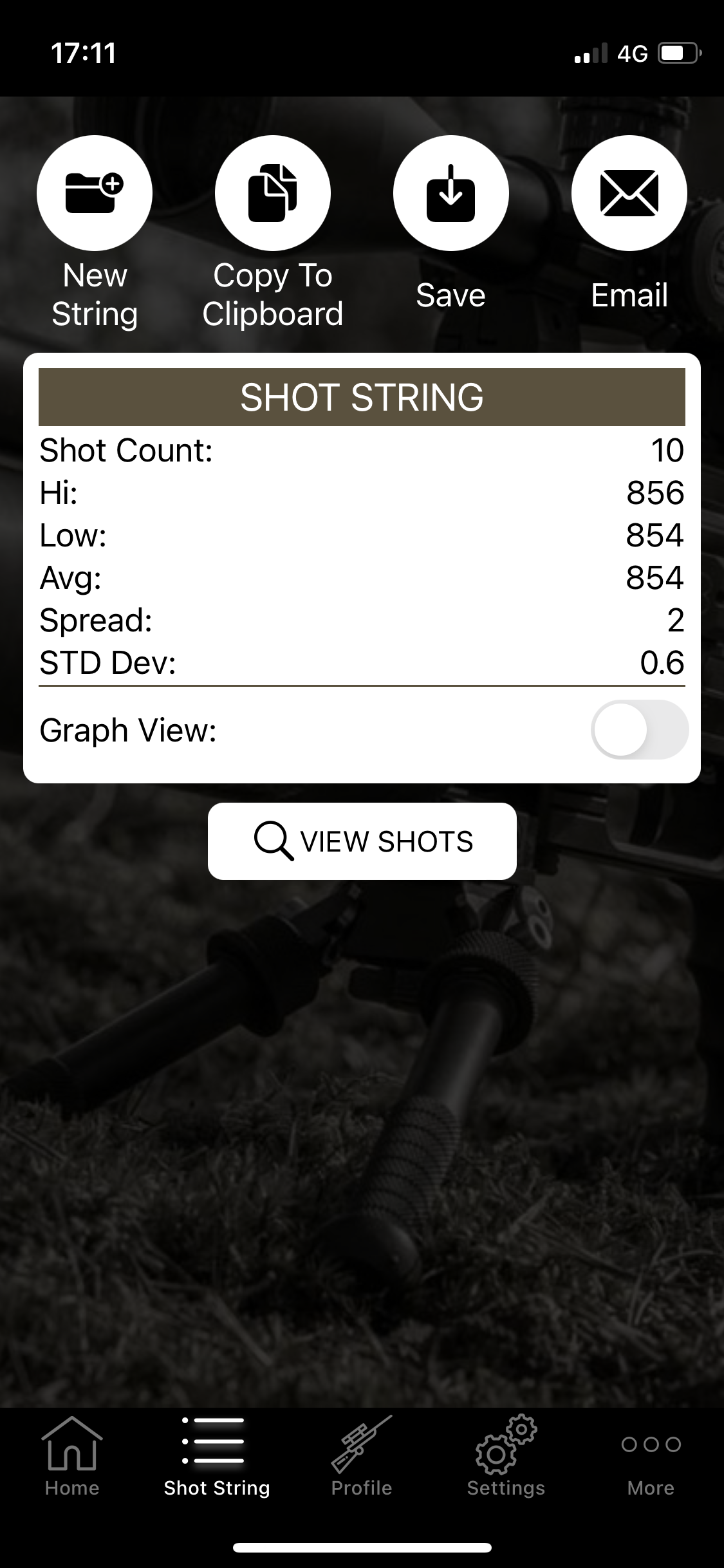

Mine is shooting the JSB Kings beautifully at ~850 fps, but I’m a little tempted to try the lighter Zans at this setting.
