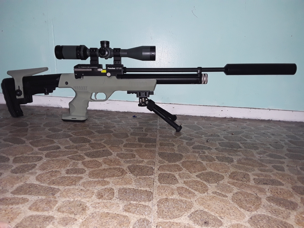

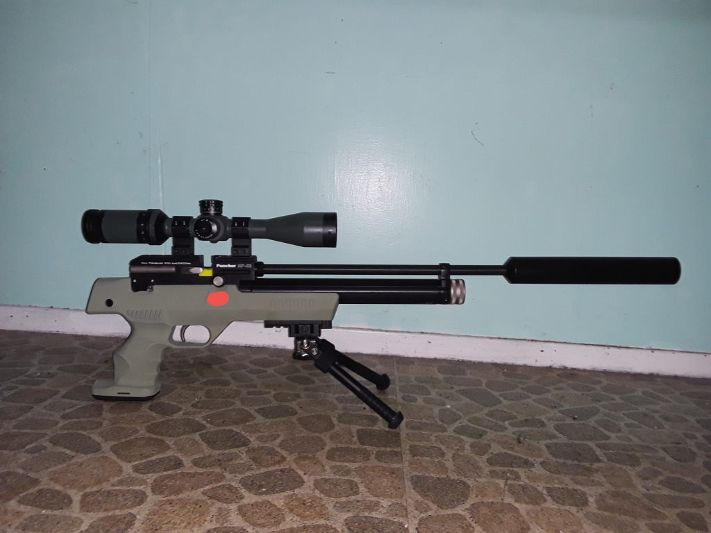

Picked up a Kral NP-03 in .25. They had been on backorder since Black Friday, which meant I had plenty of time to plan out what I wanted to do with it.
I ordered a Huma regulator plus I ordered a non shrouded barrel band for it also, and every thing arrived at the same time.
So I opened up the valve and barrel ports not for maximum power, but I wanted consistency over everything else.
Regulator set to 130 bar I have it tuned to 30 fpe with .25 Hades. Added a Neil Clague moderator to keep it quiet, topped with Bushnell 4.5 -18x40
