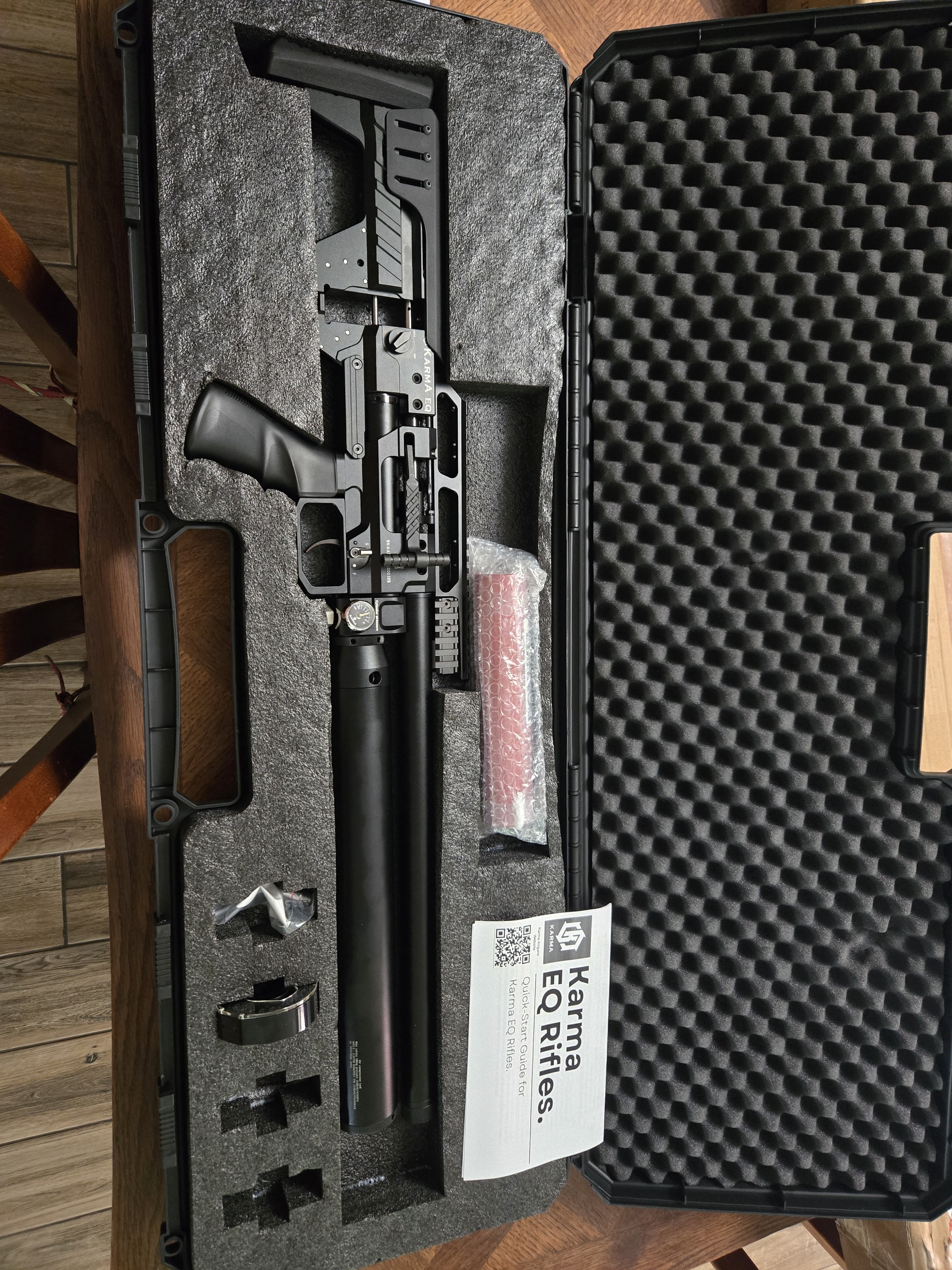

Karma .25 Karma EQ has arrived!
trapdoor2
Apr 20, 2025
200
447
Frankly, I think this thing is beautiful. My second job (10yrs, 1980s) was at a NASA/Military machine shop...the workmanship in this thing looks amazing. I ran the plating shop for a few yrs. I wish we could have done such lovely anodizing!
As yet, I haven't been able to do anything but handle it. Scope is on the way, slugs too. It is fairly heavy...but comfortable to shoulder. Feels solid. My BSA Martini is way heavier (oof!).
I like the cocking handle. I have no comparables...the Mrod's bolt is crude/caveman in comparison.
The magazine appears well made, easy to fill. I've watched the videos...but will have to actually have it in action to further comment. Although breech access is good, I can see a need for a flip out single shot loader, like the Maple I have for the Mrod. Might have to make one.
There's no manual, no parts list, no details beyond the "quick start guide". This is not something for the beginner or the clueless, it will take hours of careful "figuring out"(which I'll enjoy). Thankfully, the tech team at DonnyFL is only a phone call away (nice folks too).
I'm an old-school PB competitor, reloader, bullet caster, etc. No equipment is ever perfect out of the box. Everything requires testing, tweaking, adjustment, massage...lather, rinse & repeat.
I don't have all the tech (or the smarts) to do videos but I can write and take pictures. I'll try to document my progress here...I bought it, so expect personal opinion. I only get hyperbolic when I'm excited... :LOL:
I'm looking forward to it all!

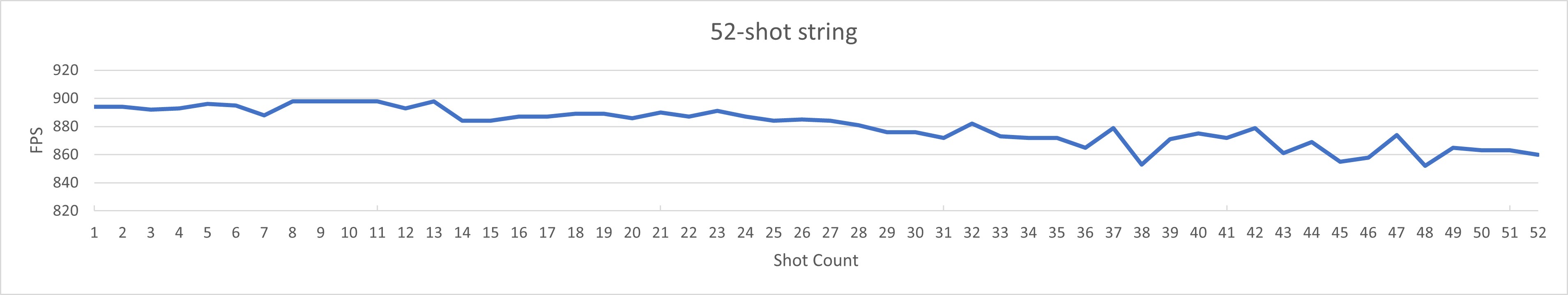

Tuning has been both easy and a struggle. It arrived with the regulator set at 1900psi, the Hammer Spring (HS) backed all the way off and the Xfer port at Max. I suspected that was a pellet tune, and it was: 750fps with the 25.39g diabolos. I was getting three magazines, no problem (78 shots starting tank pressure 3800psi). I futzed around with the HS. Even a single click stiffer brought less velocity. Getting the indicator off the Zero mark took 10 clicks and velocity dropped well below 700fps. Groups at 650fps were one-ragged-hole...and I think I could have shot well into a fourth magazine.
Having had all the fun I could with the HS, I tried the Xfer port. Just moving it slightly off Max dropped velocities again. No noticeable change in accuracy. I ran it incrementally from Max to Min and dropped about 200fps total.
So, as I'm planning on doing the slug thing, I figured I should push velocities up. I tweaked the reg up to 2000, dry fired a couple times and refilled the bottle to 4000psi. Velocity crept up to 870fps...but the reg didn't hold to 2000psi. After one magazine, it said 1950psi. So, I did a little exercise where I raised the pressure to 2000, dry fired 10 shots and rechecked. I had to do that 5 times before it settled on 2000 and stayed there. I dunno if that is normal...
With the reg holding at 2000psi, it now shot 877fps (average, 26 shots). I did it all over again for 2100psi. Pew, pew, pew...870fps. Ok, perhaps it needs some HS. One click, no change. Two clicks, no change. Eventually, 5 clicks: 850fps. Back it off and try the Xfer port. Same thing, anything off Max and it drops. I ran the HS up to ~20 clicks, Xfer port Max to Min no bueno.
Ok, on to 2200psi: Same drill, back HS to zero, Xfer port to Max. Get the reg to settle on 2200psi. Aha! First shot after refill (4300psi) was 902fps! That is the only shot this rifle has produced above 900fps. I did a 26 shot string that ran max 898, min 884. The first 13 shots were quite level, then a 5fps drop and another fairly level group. The next magazine (still without refill) started at 884 and dropped steadily to 852. Here's the graph.
Having no previous experience tuning, I don't really know what to expect. It appears that if I want 900fps, I'm going to need to get the regulator above 2200psi (and I have no idea of the regulator gauge accuracy to boot). Based on the various youtube videos of the EQ, they're getting 900+ well below that and with much heavier ammunition (at least 33g diabolos). I have the Zan slug sampler (up to 45g) and a tin of the AEA 49g slugs.
I did order a few tins of heavier pellets. 33.9g @ 904fps (2000psi reg) is what the .25 EQ is advertised to do. I'd like to see if I can somehow make it meet "as advertised". Based on what I'm seeing, I don't think mine will do it. Do heavier pellets respond better? Stay tuned!
