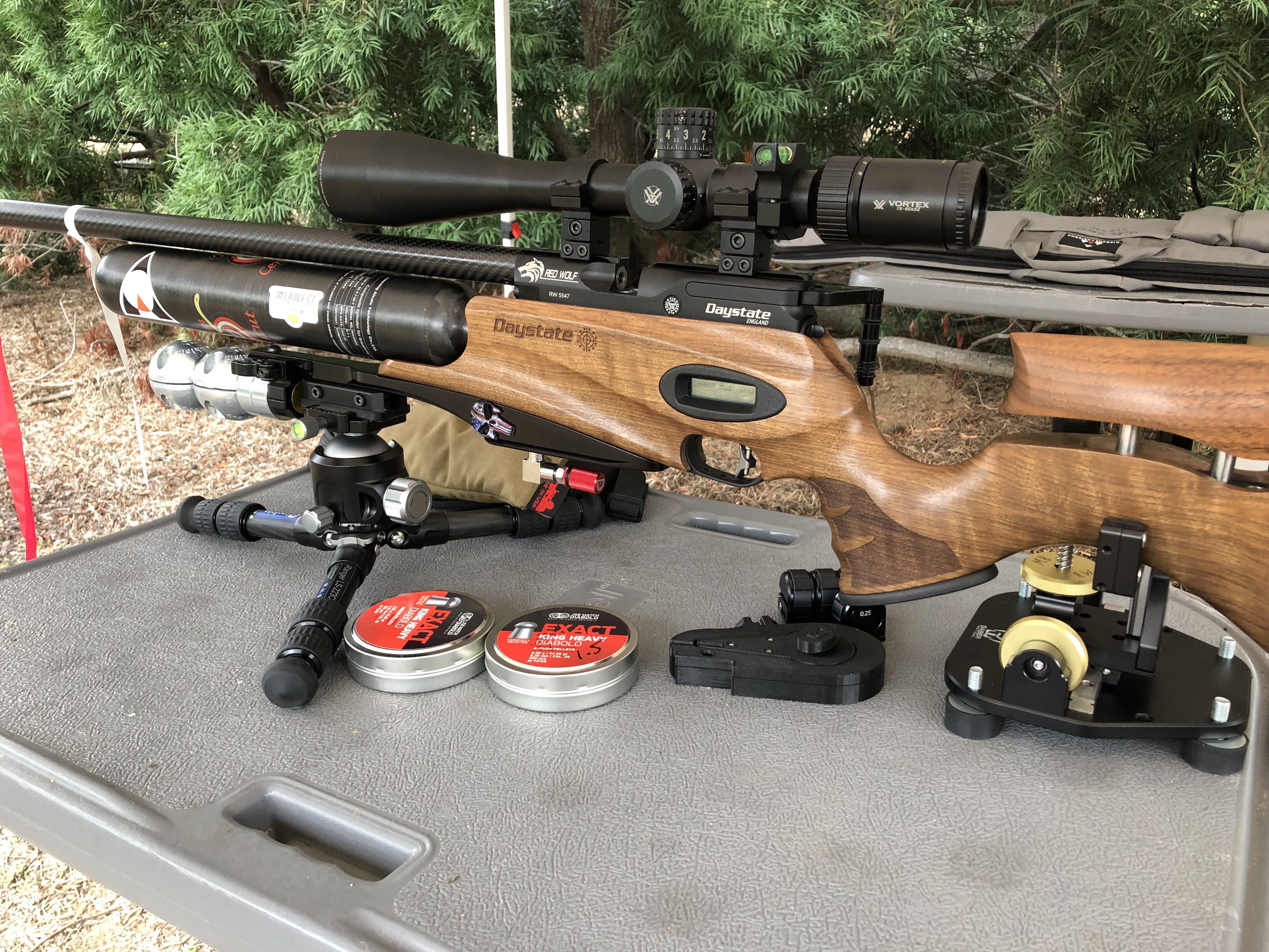

.25 Daystate Red Wolf ready for EBR2023
If you’re wondering about the Saber Tactical Pro Universal Bench Monopod - just get it. 😉 You can thank me later.

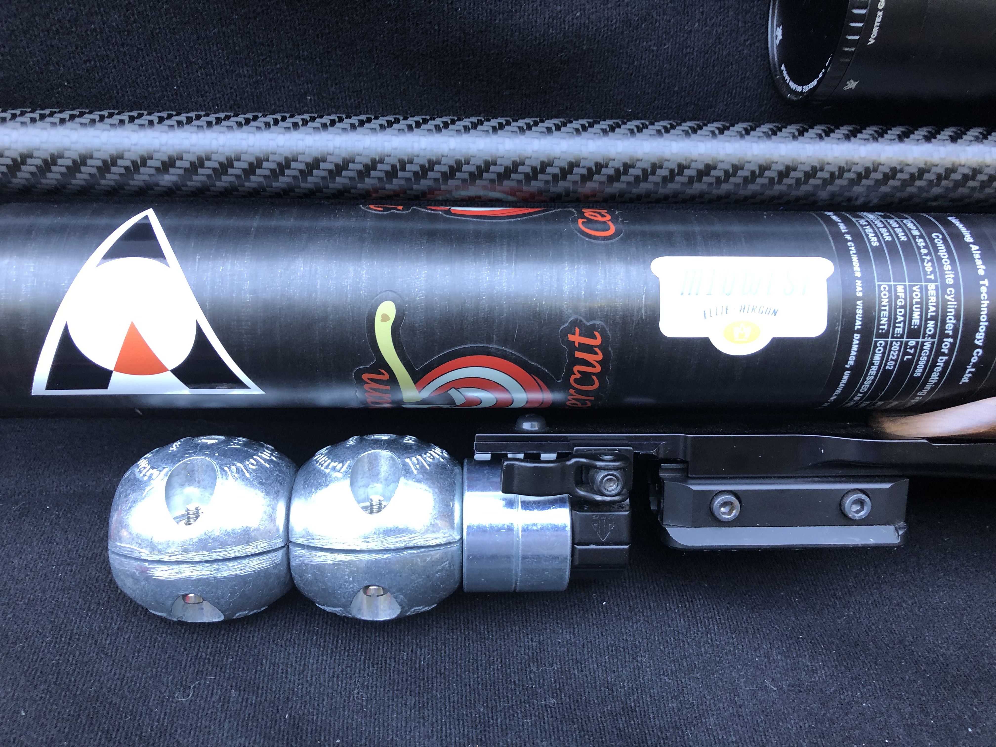

Good luck at EBR. What do you have attached to the front end of your ball head?
Thanks!
Additional weight.
1 inch brass round bar 6 inch long, 1 inch ID zinc shaft anodes (2), 1 inch ID steel shaft collars (2), 1 inch scope ring QD.
About 4 pounds total weight. It attaches to pic rail forward of the ARCA for the Tripod I’m using for BR this year.
