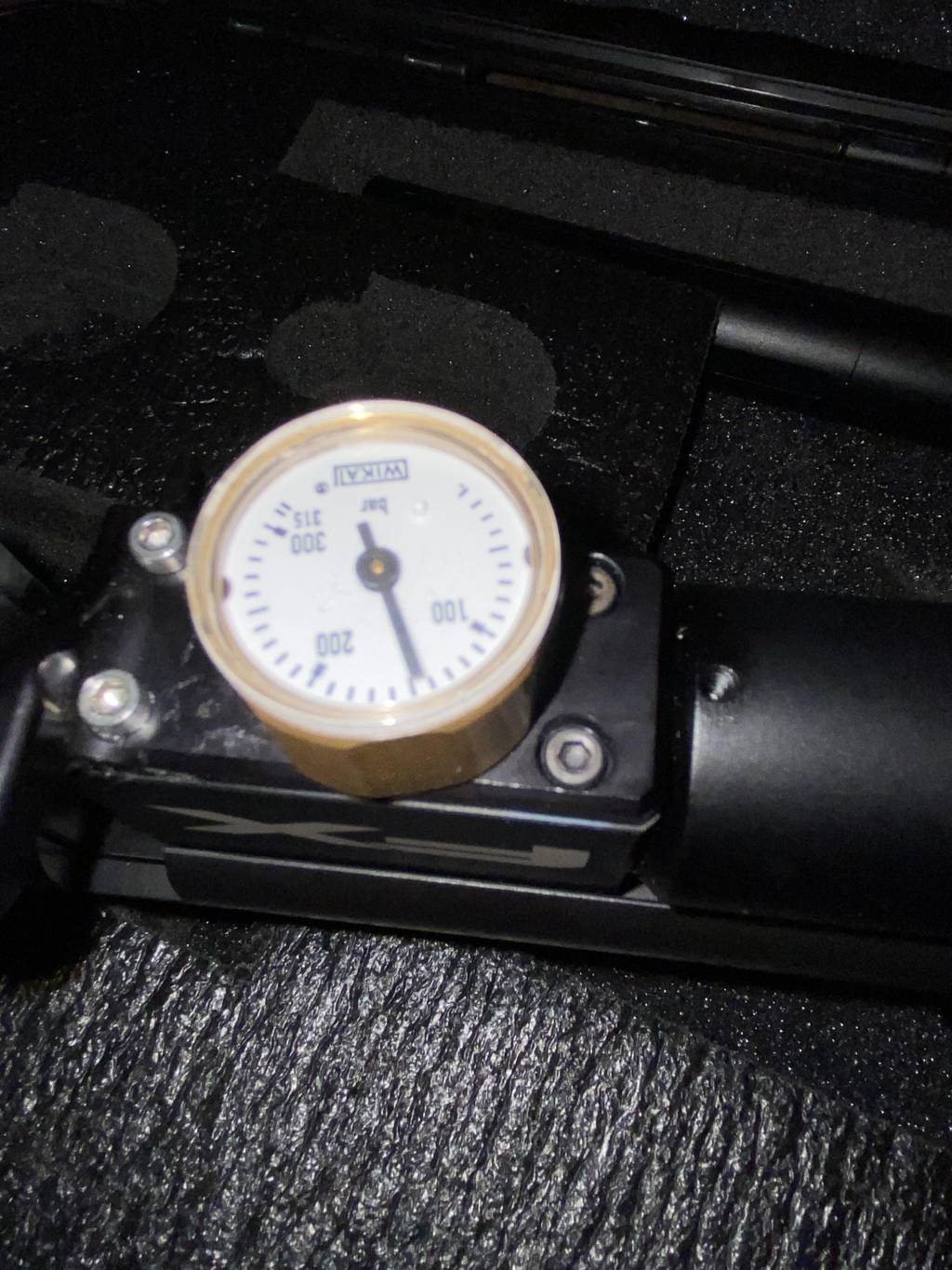

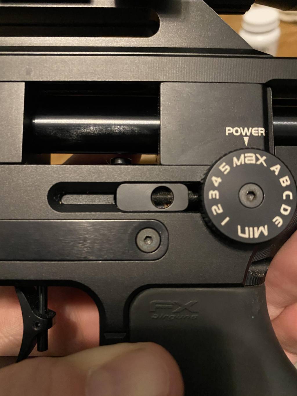

I did a good bit of shooting today got the BC to work out as advertised. However, I did have issue getting my 33.5 gr Nielsen’s faster than 860. They shoot good there, but I’d like to have them faster. I’m pretty sure I had them shooting at 890 as my original post specified, but I cranked up the reg pressure up to 160-170 bar (huma) and I couldn’t get any noticeable difference in FPS. Also the hammer spring is maxed out and I can’t adjust it anywhere. I believe the previous owner stripped it out because I’ve never got movement out of the hammer spring. Any suggestions?
Thanks again for your interest and suggestions!
Eric
Current reg pressure and HS adjustment.
Sounds like the hammer spring may be shot. My 700 mm .25 cal is shooting 860 FPS with heavy 41 gr noe boat tail hollow point slugs with my reg way down at 115 ish bar. Also has slug pin probe and slug a liner as well as Ernest Rowe dual transfer port. I’m also backed way off on my hammer spring tension and my valve is cranked down to around the 4th line.

I do have the power plenum, I really only jacked up the reg pressure to see if I could get an instant boost of FPS. The gun is stock as far as I know, it was upgraded from an x, now has the MKII fx plenum and the wika gauges. Also had a huma reg put in it functions well and is very consistent.
Also, the hammer spring is maxed out as far as I can tell, the block doesn’t slide at all, no side to side play.

Are you saying that the spring itself could be broken? Or the adjuster?
with the spring under that much tension for who knows how long, it could have taken a set and shortened itself. I had this problem on my jsar tuned gauntlet. it was shooting perfect then all the sudden my speed dropped off. found my hammer spring had taken a set and got shorter. Could be the same thing going on with the impact. I would pull out the hammer spring and measure it. I'm sure if you called FX or dug around, someone would know how long it should be from factory to see if this is possibly why you FPS is down.
Thank you all for the quick replys, I’ll do some calling around and see what I can dig up. I may tear into myself to check the hammer spring out to verify it’s in spec. I’m sure FX is backed up with work right now, I may end up sending it in for a check up/ diagnosis, just depends on the wait time. I’ll keep the thread updated with what I find out.
