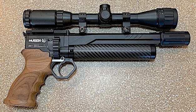

Huben .25 GK1 V3
Took delivery of a .25 GK1. Tuned it for a mag (17 rounds) on a fill. Settled on 310 bar fill which produces great results. This is my second GK1 and I’ve come to see these pistols are absolutely crazy good. I’ll be trying the 25.39gr Kings, 33.95gr King Heavies and the 29.32 JTS Semi-Dom pellets. Here’s the string with the 25.39gr:

👆🏻Awesome baby!!!
Same tune with 33.95gr King Heavies:

JTS 29.32 grainers will deliver Monday. I’ll then get to accuracy testing. Stay tuned y’all‼️Astonishing performance so far 😆

I tuned for one mag. Once you get past 17 shots with my tune, the speed begins falling fast. Accuracy testing is coming next week.
