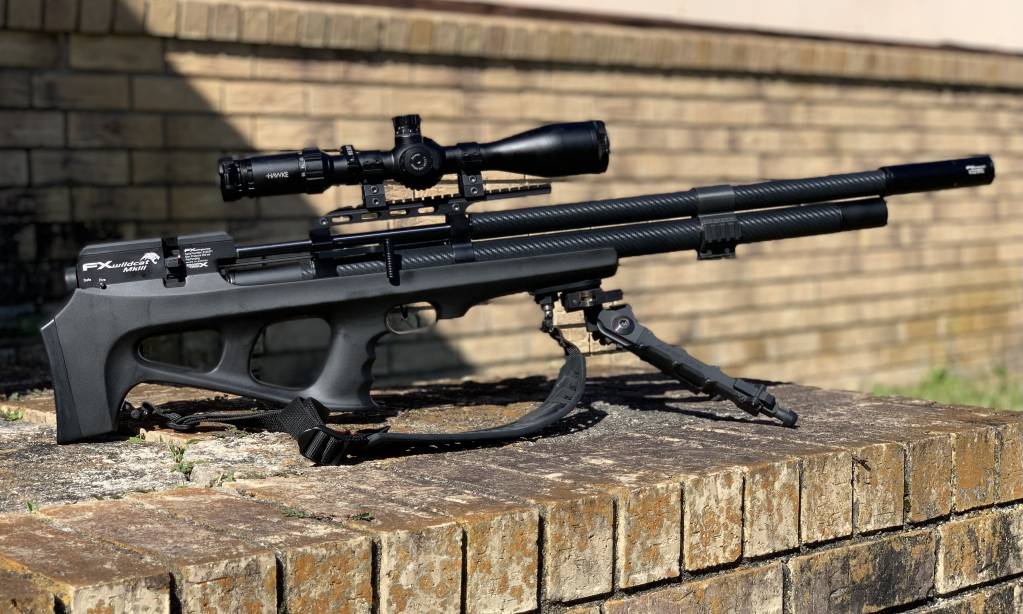

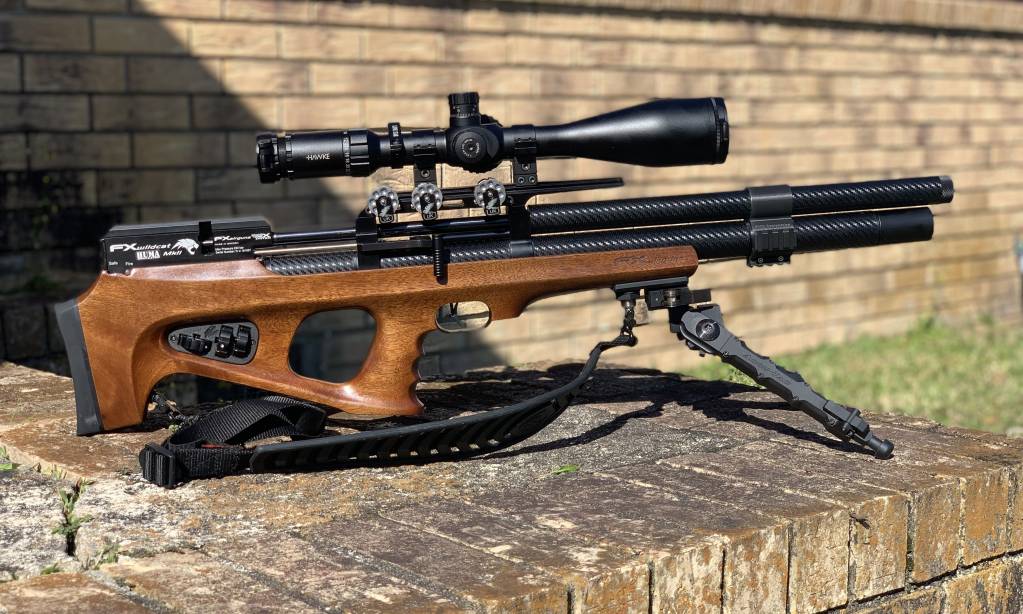

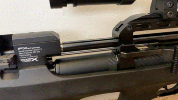

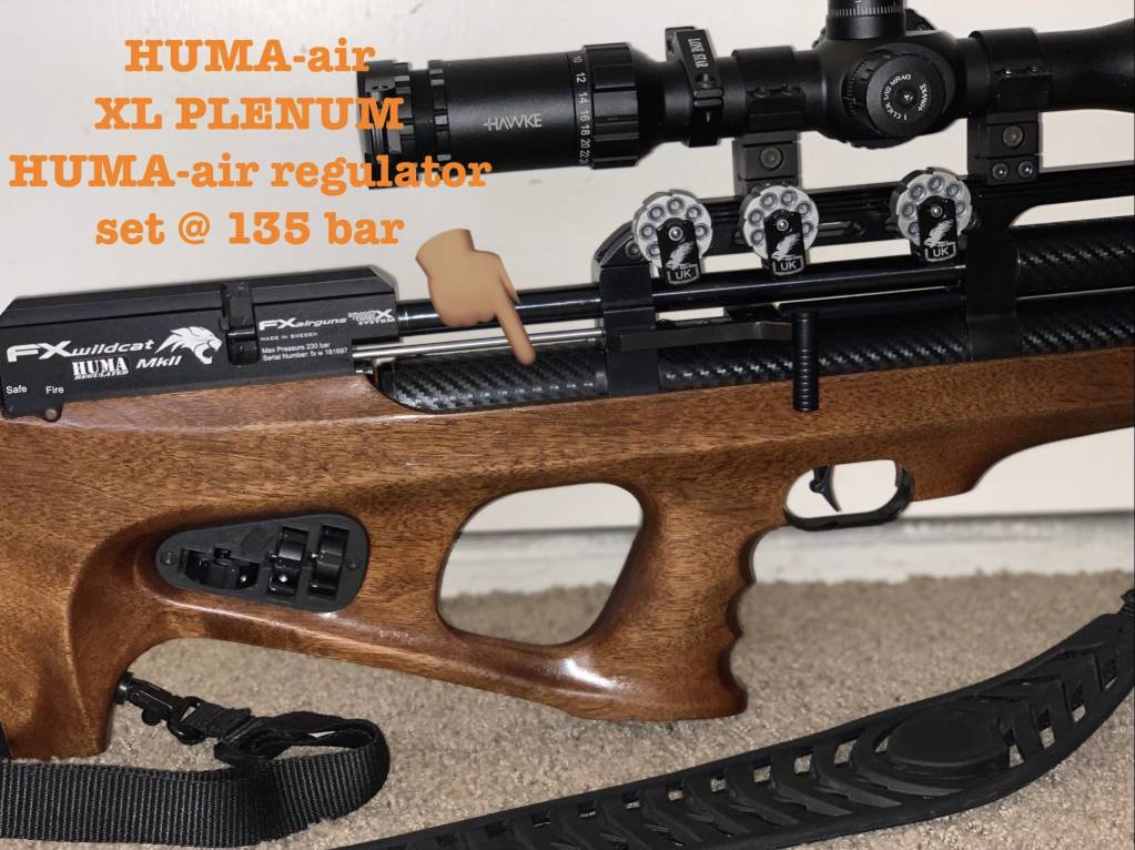

First, on my FX WILDCAT MKII .25 caliber the Huma-air XL Power Plenum and 600mm Standard Superior STX Liner installed upgrades have kept this 2017 model bull-pup up to-date with the abilities of some later model PCP’s geared towards shooting slugs well. The WC MKII was not originally released as being a slug shooter.
Huma-air regulator is set @ 135 bar
.25 caliber 600mm Standard Superior Liner

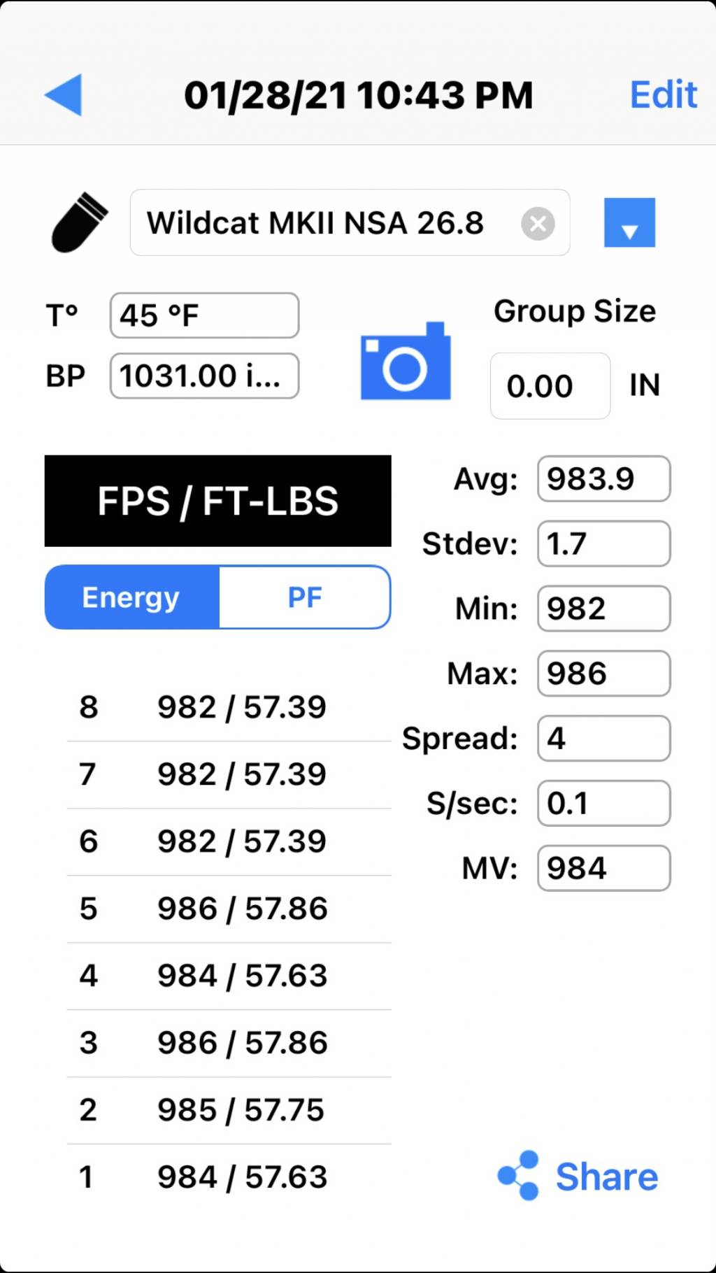

Chronograph 8-shot magazine shot string with NSA 26.8 grain HP Slugs. Averaging about 984 FPS /57.63 FT. / LBS.

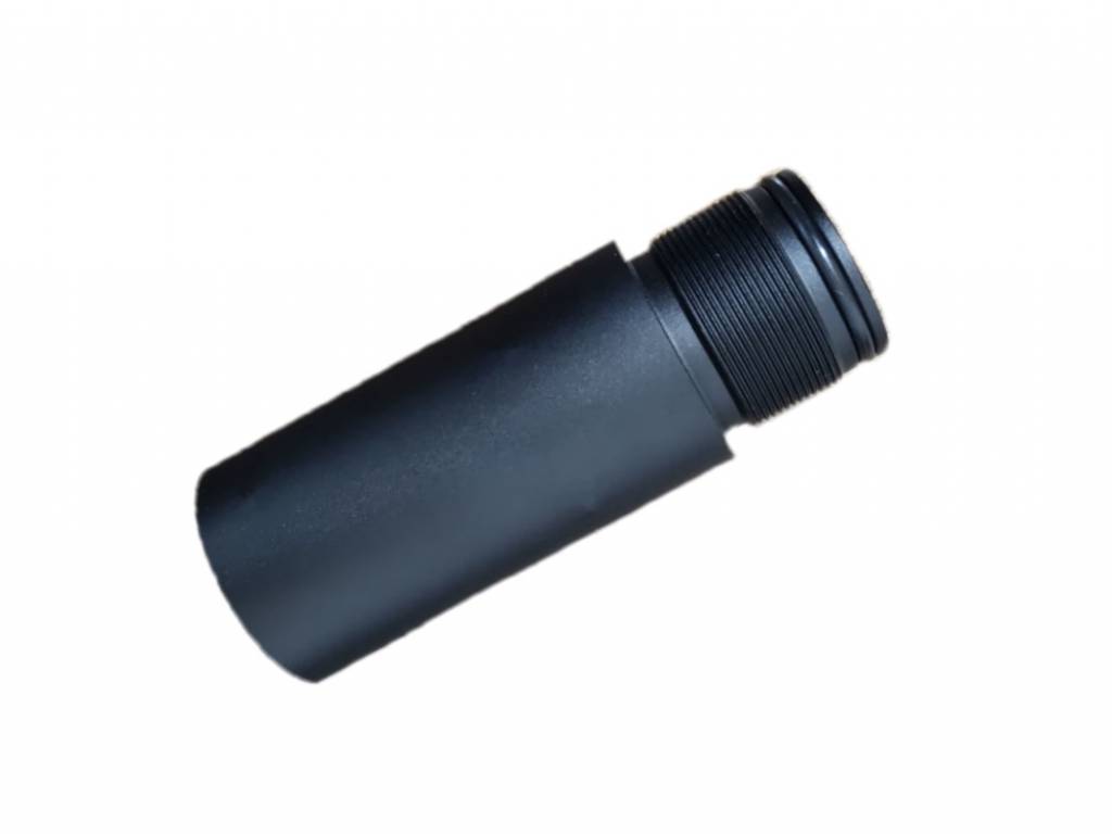

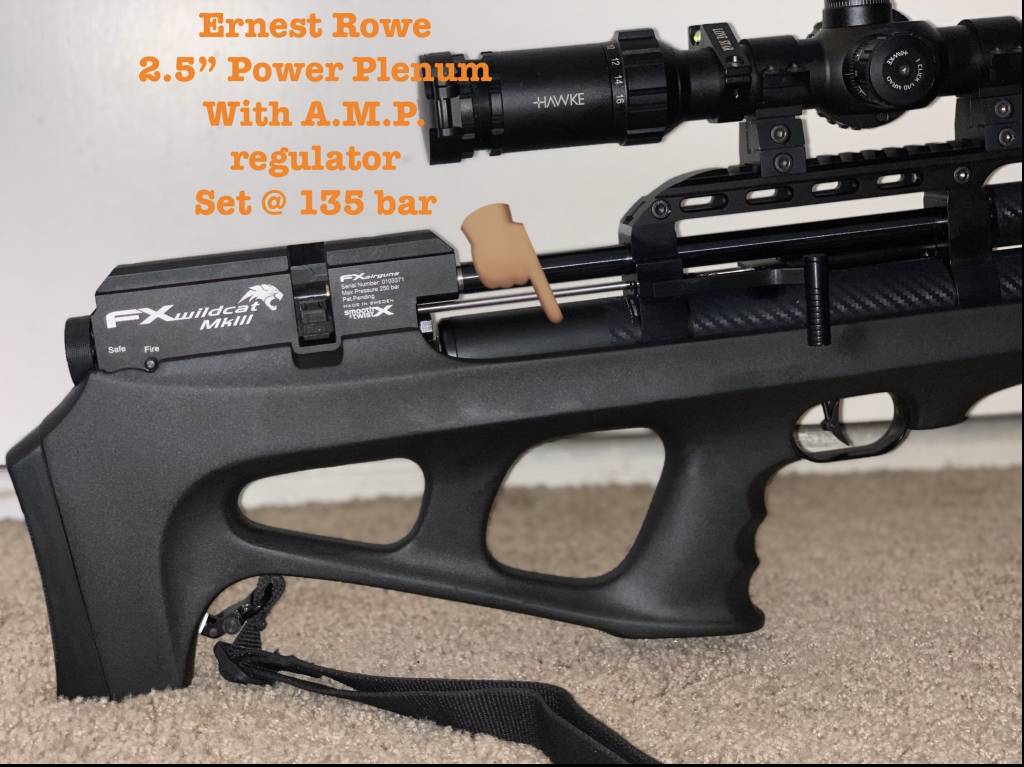

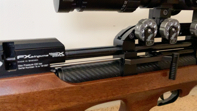

Secondly, on my FX WILDCAT MKIII Sniper 25 caliber the Ernest Rowe 2.5” Power Plenum upgrade and the stock 700mm Standard Superior STX Liner have made this bull-pup a mighty powerful and accurate slug slinging machine.
A.M.P. regulator is also set @ 135 bar.
.25 caliber 700mm Standard Superior Liner

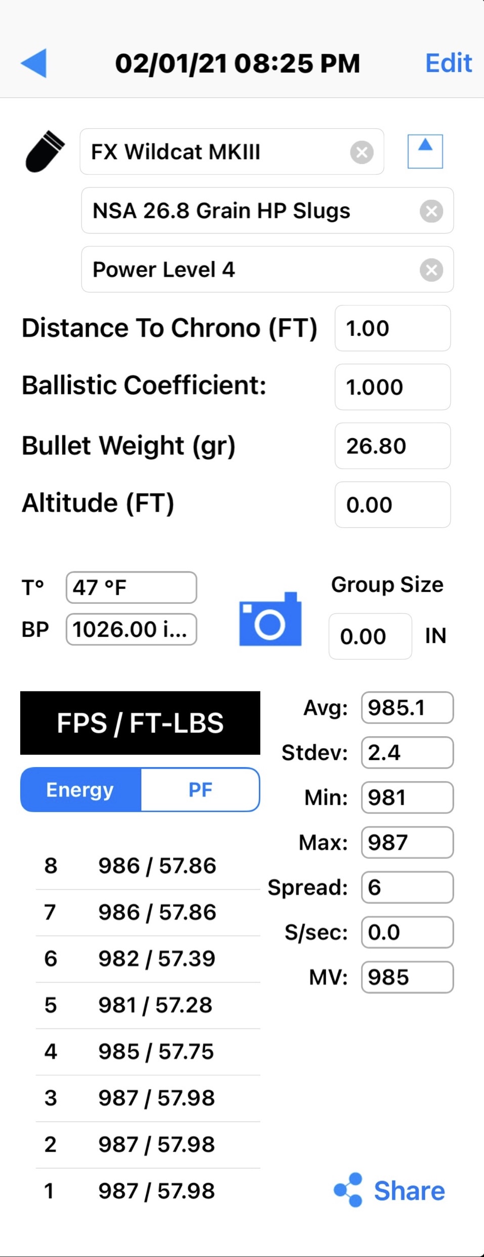

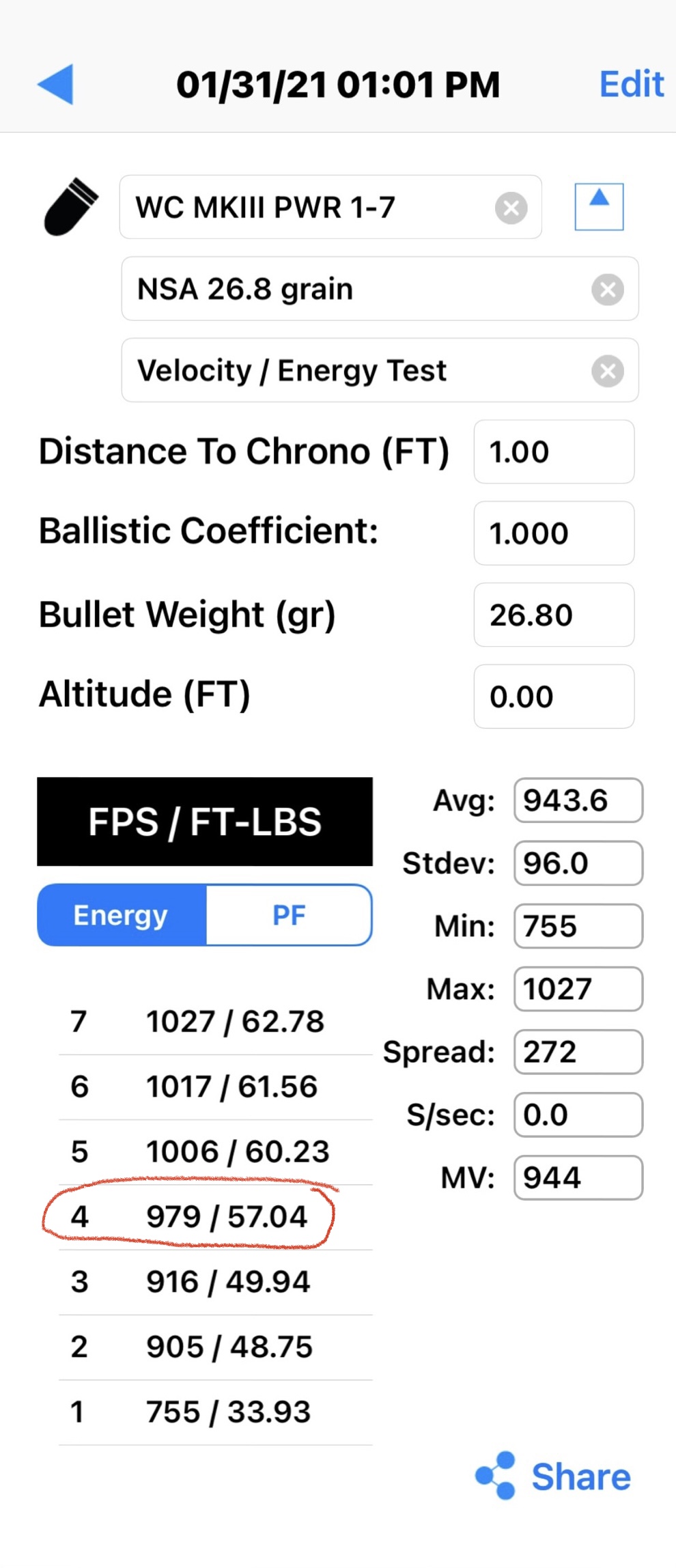

My .25 WC MKIII Sniper is far more powerful than the MKII due to its longer barrel. Also, it is externally hammer spring tension power adjustable, so the HST #1 through 7 setting that evened up the playing field was on HST #4. @ 979 FPS / 57.04 FT. / LBS.
Chronograph #1 through #7 hammer spring tension settings, HST #4 matches the MKII’s velocities with NSA 26.8 grain very closely.

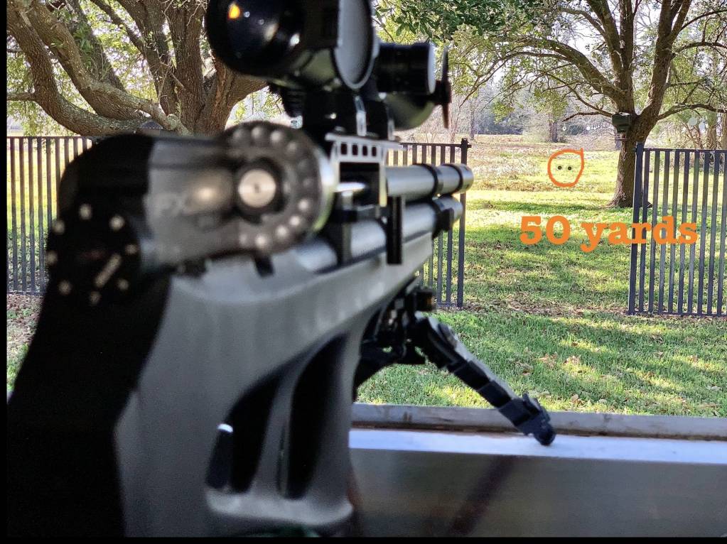

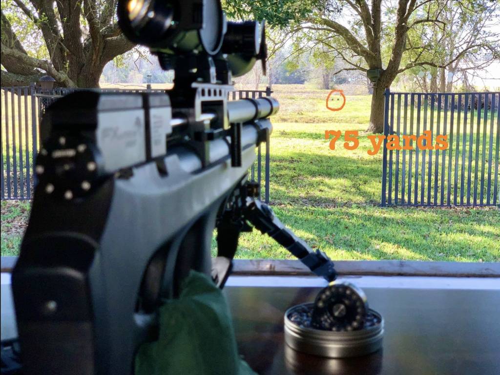

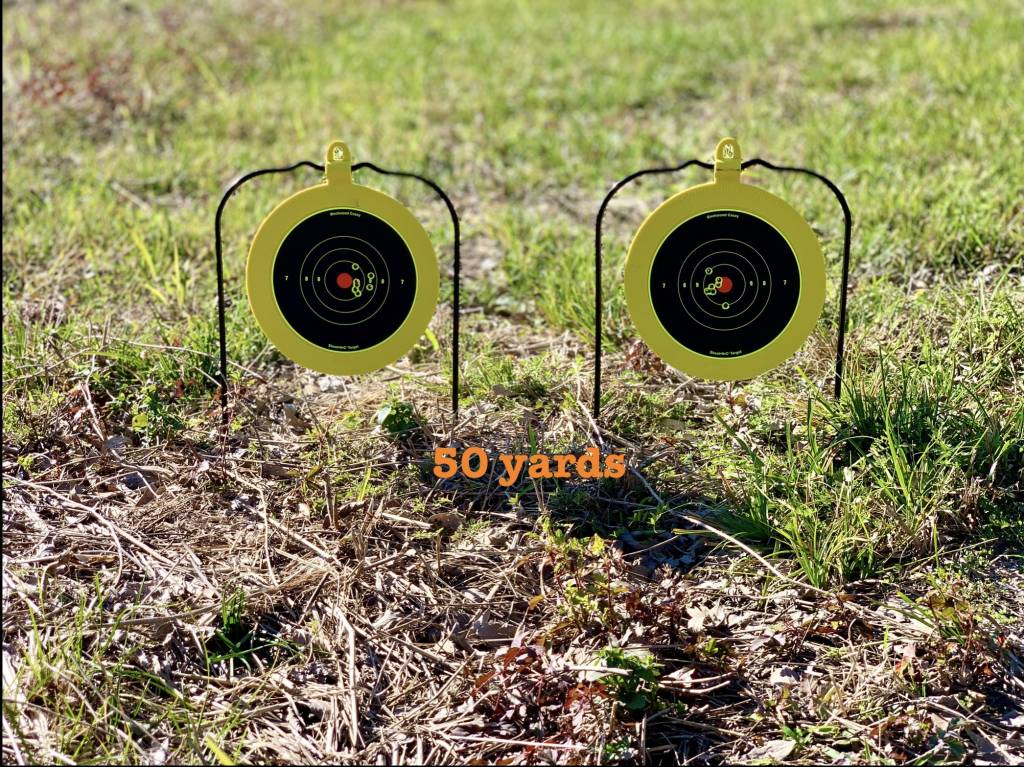

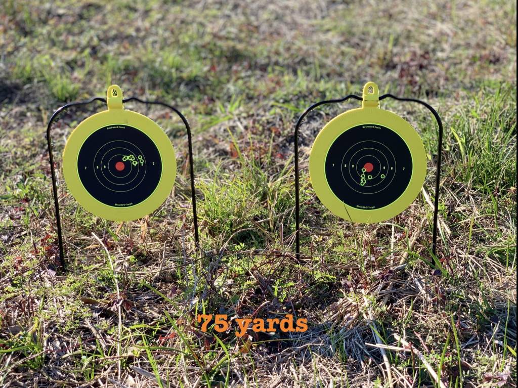

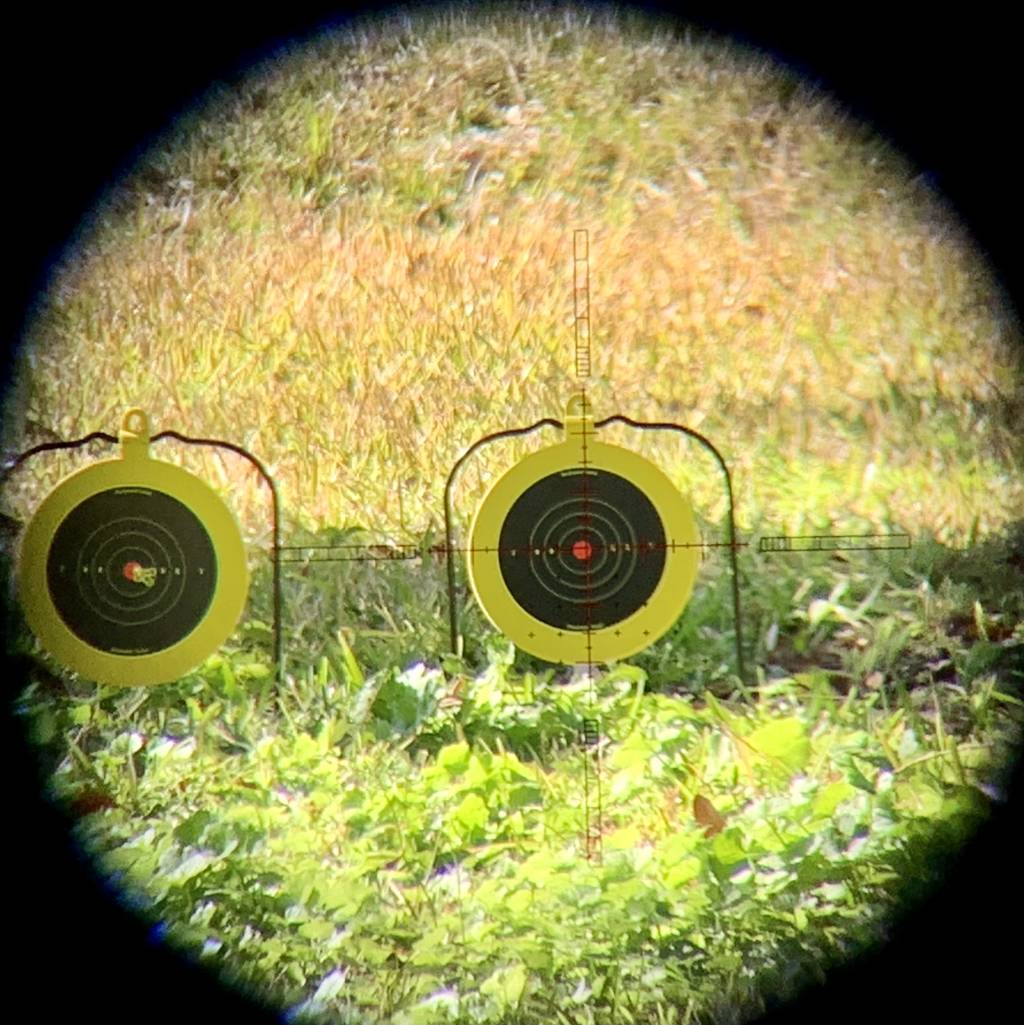

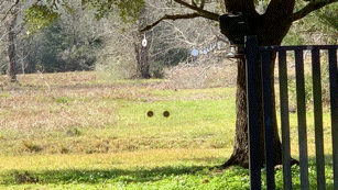

Target setups and 8-shot groups. 8-shot groups were taken because that is the .25 Wildcat MKII’s magazine capacity, 8-shots. So, a full magazine was shot at each range with the WC MKII, and I also shot 8-shot groupers with the WC MKIII.

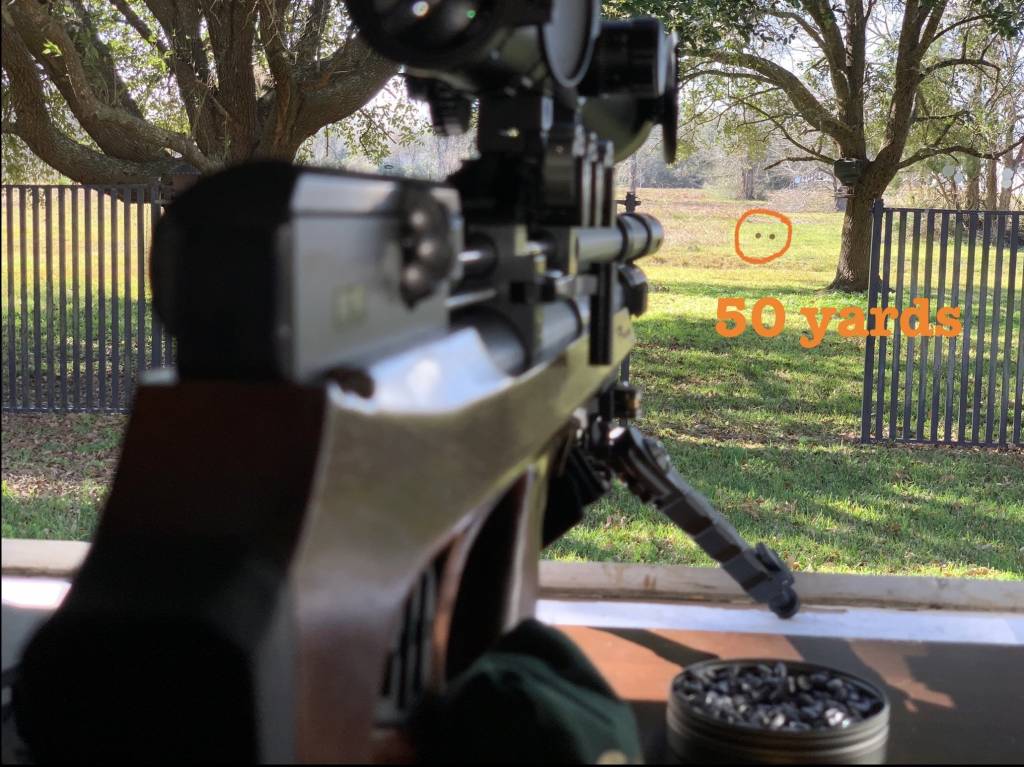

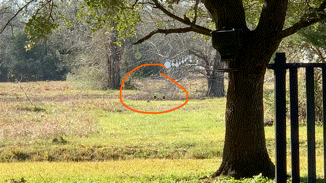

Wind conditions:

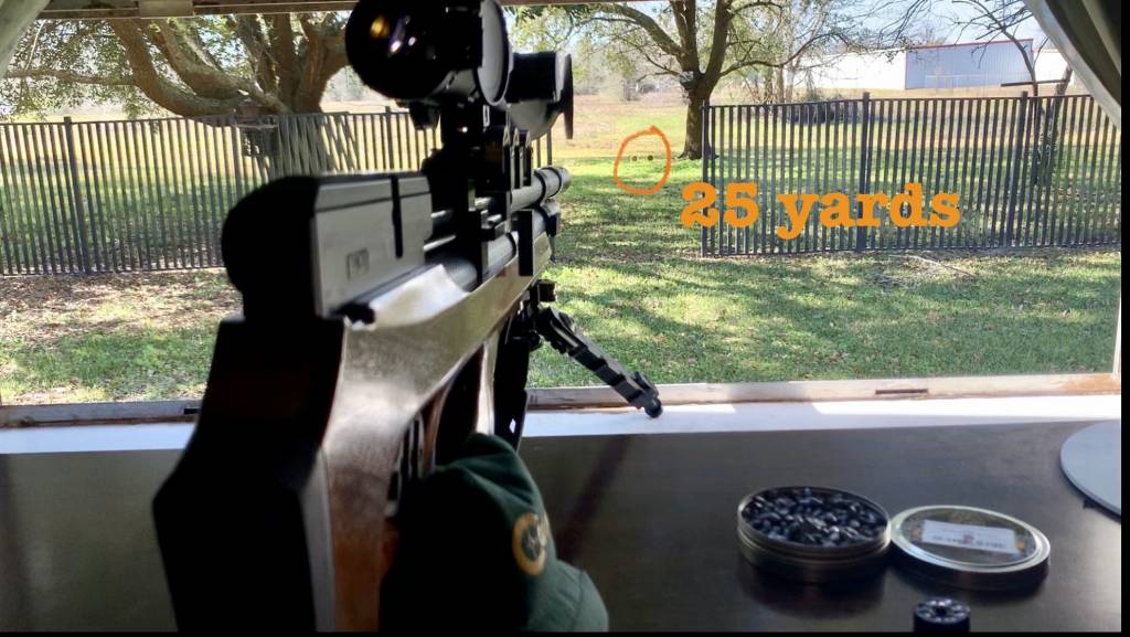

25 yards (MKII left) & (MKIII right)
50 yards (MKII left) & (MKIII right)

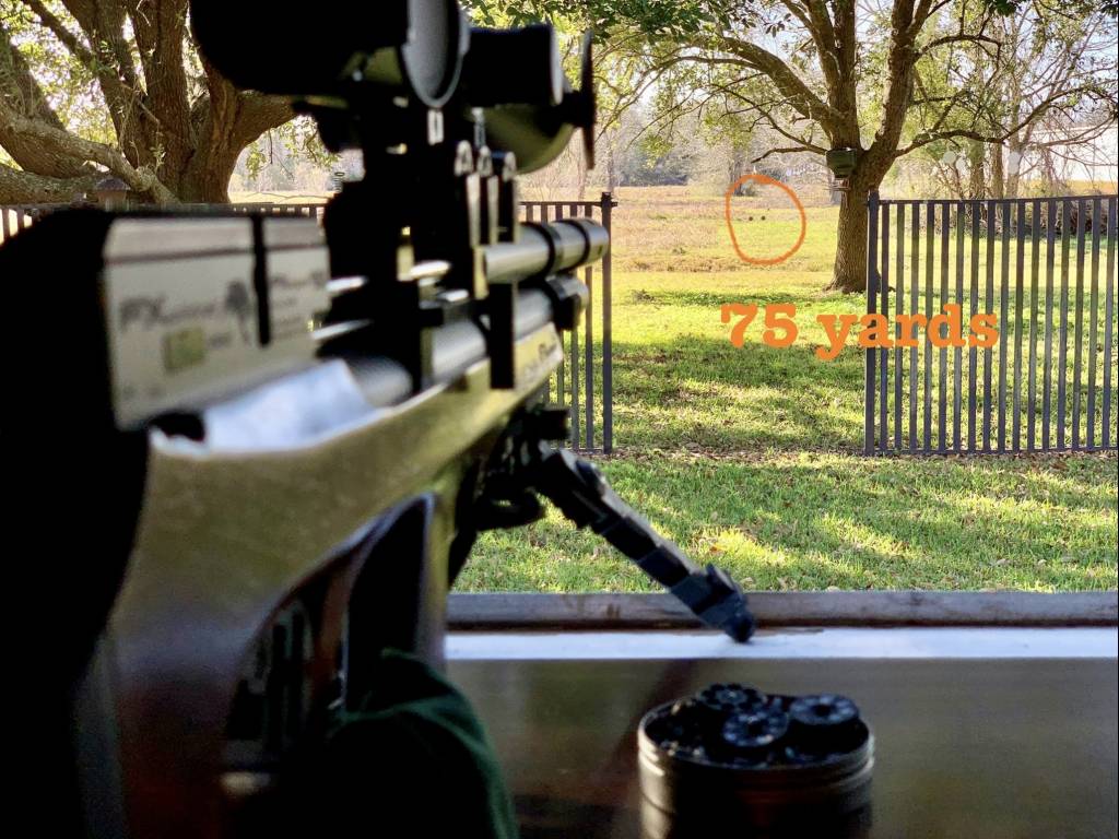

75 yards (MKII left) & (MKIII right)

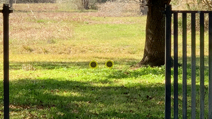

100 yards (MKII left) & (MKIII right)
All targets taken down and organized together.
Conclusion, pretty even results from both different generations of FX Widcats in .25 with the Nielsen Specialty Ammunition’s 26.8 grain slugs. The power plenum extensions and superior STX liners definitely enhances their performances. My .25 Wildcat MKII definitely does not feel out-dated with the upgrades and new tune. Furthermore, the Wildcat MKIII Sniper .25 is barely trying using NSA 26.8 grains because normally I use NSA 33.5 grain slugs @ 960 FPS for 70 FT. / LBS with even better accuracy. Still, it is cool to know it can easily tune down and prove versatile with lighter weight slugs.

Man I hate to be the turd in the punch bowl, but 2" groups at 50 yards is hardly an acceptable group in my opinion. I would try lowering the speed to around 920-930. I used a friends maverick with a 700 mm barrel on the weekend and did 10 shot 3/4" groups at 60 yards.
I suppose if your only planning body shots on ground squirrels within 45 yards then it's good enough, but I would definitely keep tuning.

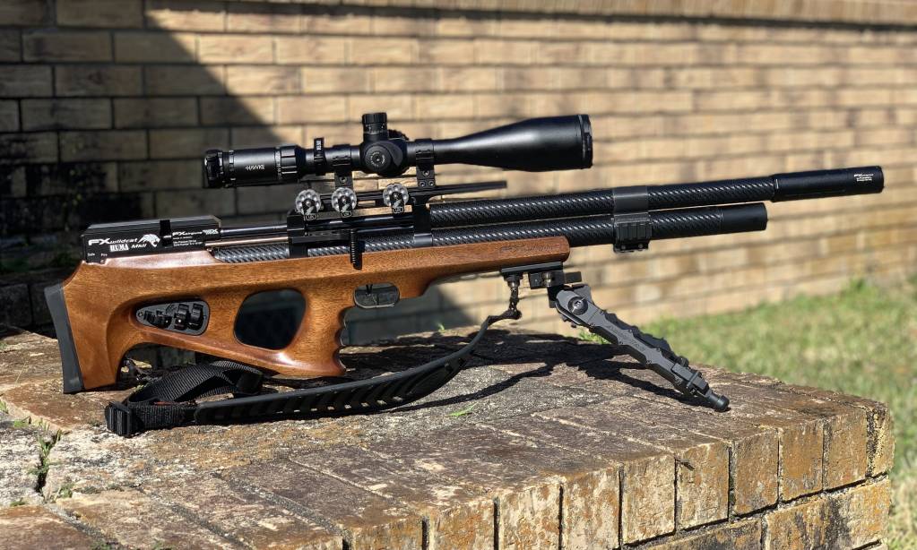

Nice layout and pictures to boot! I have my MK3 set up using the NSA 33.5 at 910 for 35 shots on reg. I do like the looks of the wood stock. Looking at a piece of walnut now. Might be my next stock project. Again, nice white-up.

Where did you get the barrel band? I hate grabbing the rifle by the barrel and tube and feel them squish together.
https://smwengineering.co.uk/products/fx-wildcat-barrel-clamp-and-mount?_pos=8&_sid=e91bf5ec4&_ss=r
email Stuart
email address is in the contact section of the website

It’s okay if you’re a turd, stand up and be proud of it! Lol! Just kidding!
It’s my shooting not the airguns. Trigger pull, grip, breathing, and cheek pressure are the factors for my flyers. I don’t always pay attention to all those things, some times a rush a shot not paying attention.
You have a valid point Moe, I have played with many different speeds, but the current tune is boss right now!

Very nice head to head comparison, Joe! And good shooting considering 15 to 21 mph wind. Nicexto know the newer MK3 sniper has power to spare. Thanks for sharing the results of your comparison. Great post!

Super nice posting again Joe. You and me were lucky enough to pick up Ernest’s PP made for the first batch of WC III. However since FX changed the construction of the  end cap there has not been a replacement till today. Did you hear anything about a Ernest Rowe PP update for WC MK3 ?
cheers
Ladwict
Unfortunately I haven’t heard anything!

I’ll just say this; What generates more $$ a $70 power plenum upgrade or a $1.400 Maverick??
i am afraid you are right. I believe I am happy I bought 2 1.2” Power plenums for my wildcat at the beginning of production like you did. Just gives that extra I appreciate. I would indeed buy a Maverick in case I would not have my PP in the WC MK3 so the marketing machines works well 😏
