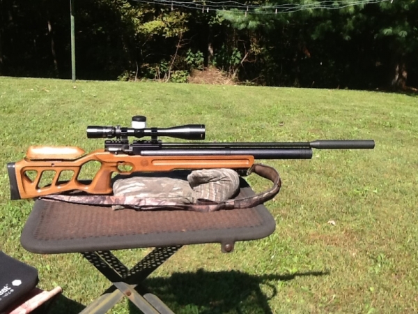

.25 Cricket Shot Strings (PreTune) your thoughts??
#1. 915,902,904,904,899,899,900,900,903,901
230b.. Lo899 Hi915 Av903 Es15.7 SD4.6
#2. 898,905,906,908,905,904,910,912,907,910
180b..Lo898 Hi912 Av907 Es13 SD3.8
#3. 909,910,912,911,909,915,898,912,912,911
150b..Lo898 Hi915 Av910 Es16.7 SD4.4
#4. 896,903,905,903,899,903,909,910,908,891
120b..off reg. Lo891 Hi910 Av903 Es18.5 SD5.9
#5. 881,900... 53 usable shots total.. Av905.7 jsb 25.4 kings..Es15.9 SD4.6 FPE46.2
Looks pretty good to me what kind of tune do you think you need I just ordered one of these cuz I got tired of messing with fx's
I’m going for straight power! Crickets are superior to FX I had all FX rifles they are accurate just have to find the right one and shoot for months to get to know the rifle. Crickets are straight out the box dangerously accurate. Some even come shooting hot so you may get lucky

Based on his numbers there may be nothing to tune if he is happy with that power level. But, if you have it tuned to shoot the 34 grain pellets at just over 900 fps you get about 60fpe with insane accuracy. Also, while Crickets come out of the box shooting very well, they can benefit from some TLC as there are little things that are not as good as they should or could be. The stock hammer spring for example could use an upgrade, etc. My Cricket Bullpup in .25 can shoot at 62fpe with the 34s and I swear I thought it was broken the first time I shot it because it actually managed to be quieter than my Mini Carbine in .22

He says its regulated and doing 905fps with JSB 34 grainers for 43 full power shots...
The tune work he says was done by Darrek wall. I'm not sure who he is but sounds like he knows his Crickets...
Trigger has been turned also and the gun is only a few months old. I have someone interested in my Mrod just waiting for them to buy it...
James from Michigan,
Well I bought it!!!!!!
All the power tune has been done internally with the original .25 pressure tube...
No extra plenum or having to change the tube. The trigger is tuned to 10 ozs. And I can't wait to shoot it....

Nice string Anthony.
Congrats on the .25 Cricket Carbine James.
I tuned that carbine. It’s a hoss!! I ported the firing valve and installed a valve-return spring of lighter tension (Ernest taught me this
1f609.svg
). I did some other things to it but those two things are primarily what increased the power. Enjoy it!!
