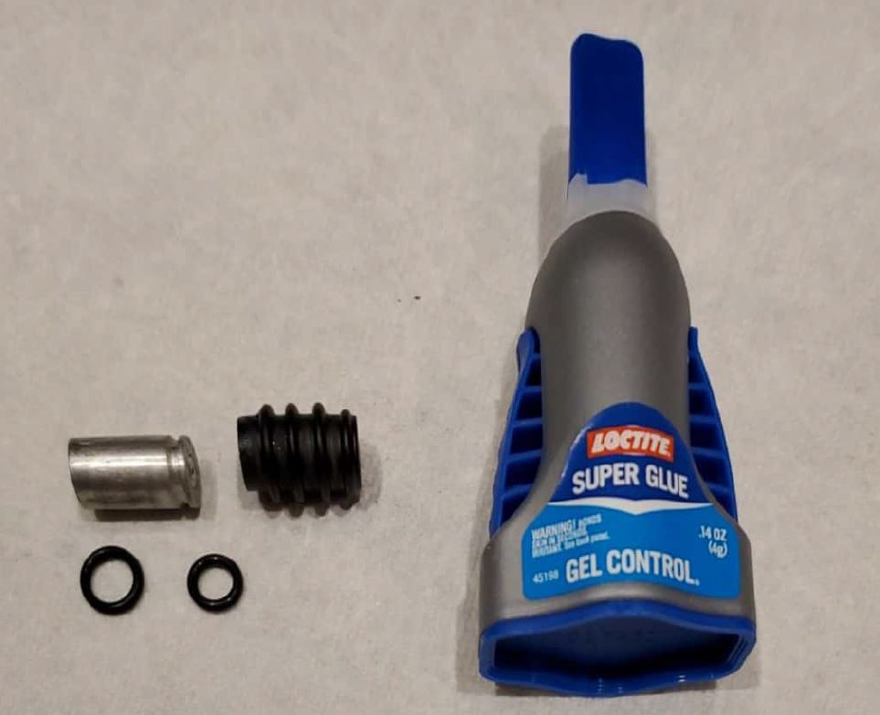

.25 cent Foster Fitting Cap
1 9mm casing
1 #5 o-ring
3 #6 o-rings
Glue
Plastic scrap (such as from a water bottle)
Black spray paint

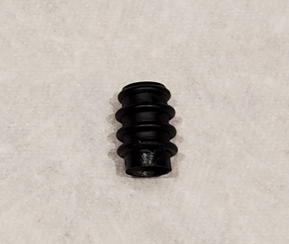

Clean the casing, inside and out, with solvent, such as rubbing alcohol. Use a Q-tip for the inside ;)
Glue on the o-rings, It doesn't take much glue. Use the #5 0-ring at the groove at the primer end.

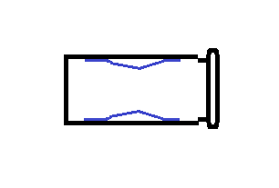

Cut 2 strips of plastic from a water bottle and glue them inside the casing. This holds the cap in place.
Finished product
