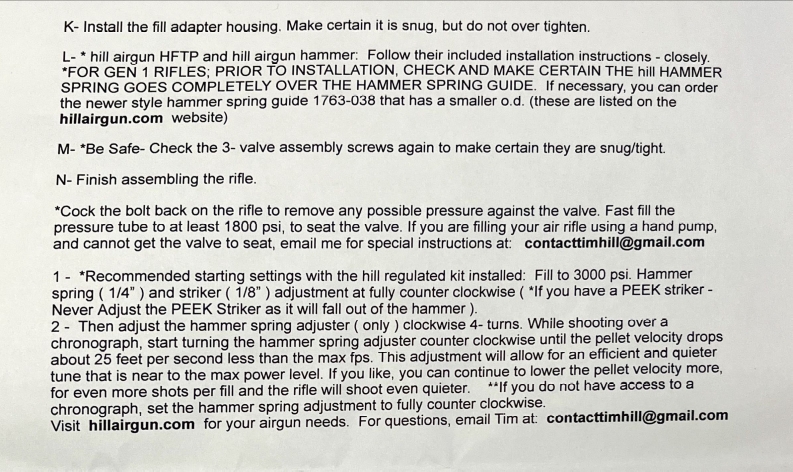

If its an Huma reg with an XL plenum you should be able with a bump in pressure. Longer barrel helps too. Measure the barrel port, it may have been opened prior, Tim’s kit has you drill to .160 to match the transfer port. The PEEK striker eliminates any further striker adjustment so tuning is easier with Hammer spring only. The regulated kit comes with the lightest Valve spring (#7) and hammer spring, light hammer and PEEK striker. With Tim’s regulated kits, I find if you need more than 3 hammer spring turns in to get the velocity , a change out of the 262 spring to a slightly heavier one and be right about 1/2 turn in to match velocity. Any more than 4 and I find a spring change is needed. In the case of spring rattle, some of Tim’s springs are shorter and have a free flight effect, use an foam earplug.
Heres tim’s included tuning instruction for his kit for reference
