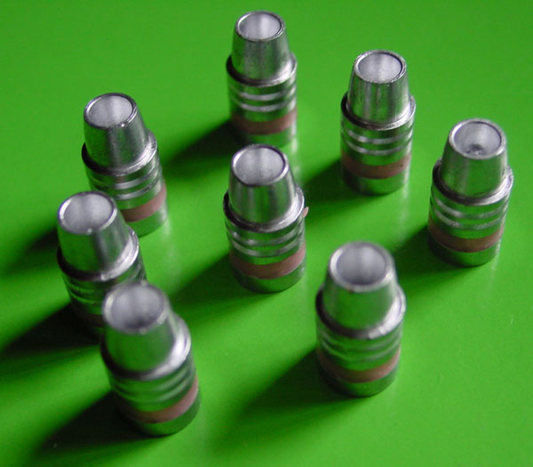

I know some people thought I was using too much gun when I did most of my groundhog hunting with my Benjamin Bulldog .357 shooting Polymags and slugs, but adult groundhogs are as tough as nails, and they need a good headshot between the eye and ear to put them down clean. I have had a lot of success using the Bulldog on bodyshots as well, as a good heart lung shot is easier to get over a headshot.
I am now shooting groundhogs with my FX Maverick VP .30cal and the greatly improved accuracy has liberated me to take more headshots to get the job done. I've been using FX Hybrid slugs, and they are as devastating on groundhogs as they are pricy.

Groundhogs are so damn skittish and waiting for a good headshot can mean an escaped garden raider. A good .357 hollow point will allow you to quickly line up the shoulder shot and let loose. Even if the shot isn't perfect there is no way he is going very far with a quarter sized exit hole in him.
Make big holes....win big prizes.
I agree.
Polymags have been my go to pellet for groundhog bodyshots, and it usually puts them down for the count with no exit wound!

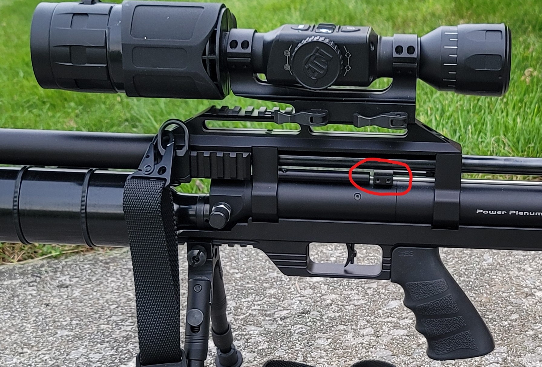

That's one sweet maverick you have! How are you liking it so far? I just picked up the wildcat bt in 25 I haven't been able to shoot it yet due to not have a fill source so I'm waiting until I get a tank or something. Keep laying the smackdown!
I really love the Maverick a lot! With my scope setup with the built-in ballistics calculator, I just range point and shoot. The .30cal doesn't have as great of ballistics as my .357cal rounds, so I have to do a little compensation for wind at long distances, but making a deadly shot at > 100 yards, and to do it repeatedly is everything an airgunner can hope for!
I would do one thing as soon as you can, and that's to put locktite on the cocking lever grip on the left side of the gun, as mine loosened up after about 200 shots.
Reactions: SimpleGuy
