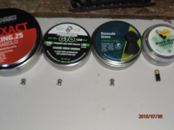

    Here are my obervation: Picture below shows the size of the different pellets as well as the JSB 25.39. The Skenko Black Max are useless for me. They don't fit in any of the magazines, I hand loaded 2 into my Impact with effort and they didn't even hit a 12"x15" target at 30 yards. The Impact is zero'd at 50 yards.
