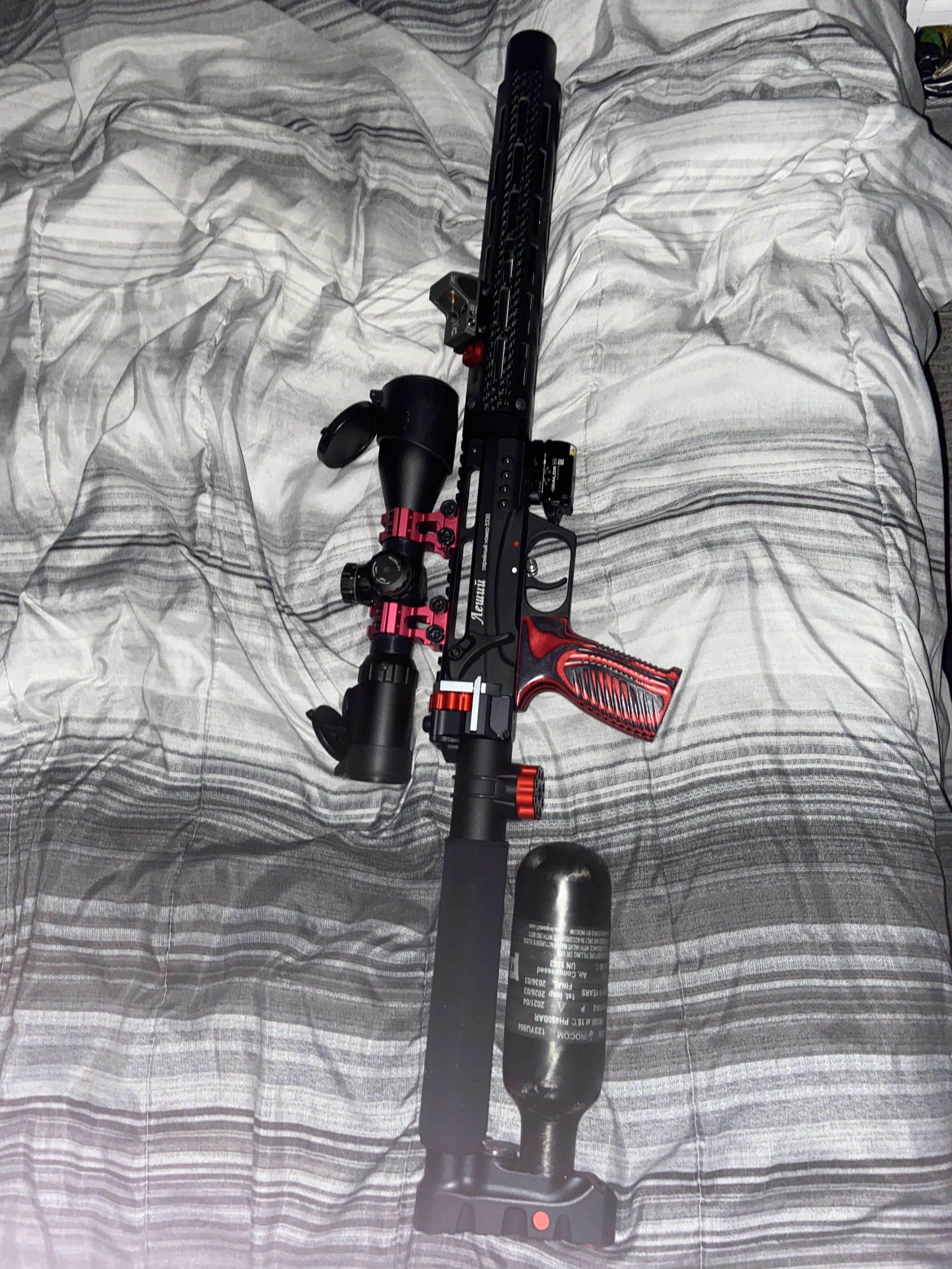

I’ve been messing with my regulator pressure a lot and can’t seem to find the best leave it there spot yet.
I have the leshiy 2 with 350mm barrel shooting around 170 bar at around 60-65fpe I have a few different ammunition that’ll give me very different results and speeds but my goal is to tune it to a very powerful, efficient state where I can throw it in a backpack go hunting for the day and not to refill my 300cc tank so far air efficiency hasn’t been a problem I can get around 40 shots before I drop below 130 bar out of this 350mm barrel not too bad. Also have some issues with groupings but yet it’s hard to really solve that since I have a crappy scope so not sure if it’s the gun or that But I figured I need to start with jets. Maybe sizes .2/.2 and another pair of .5/5 and try those two sizes out but I also can’t get my hands on them.. anyway
I’m not too sure how other guns regulate pressure but some info on .25 cal what what’s best Speed to shoot them at and how you like to save air etc..
I’m currently shooting avs 254 34gr and hades 26gr
