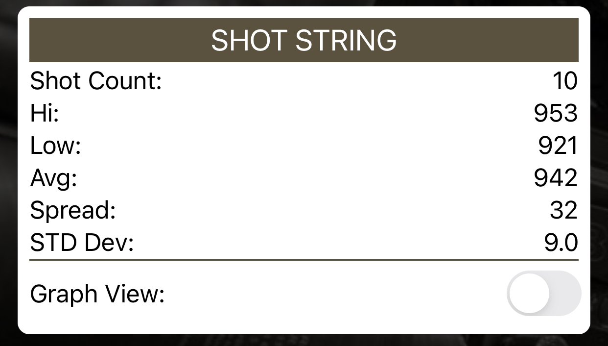

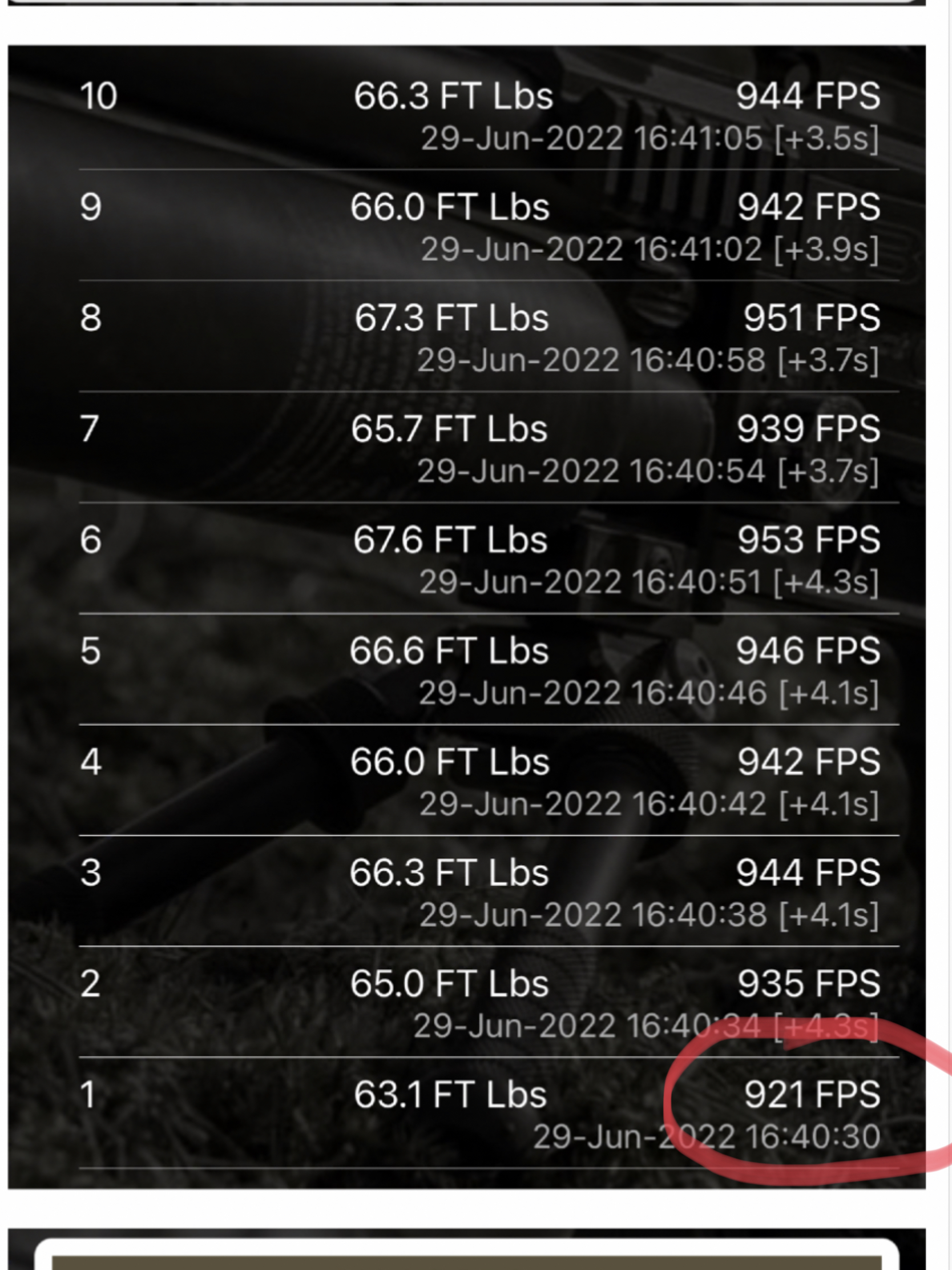

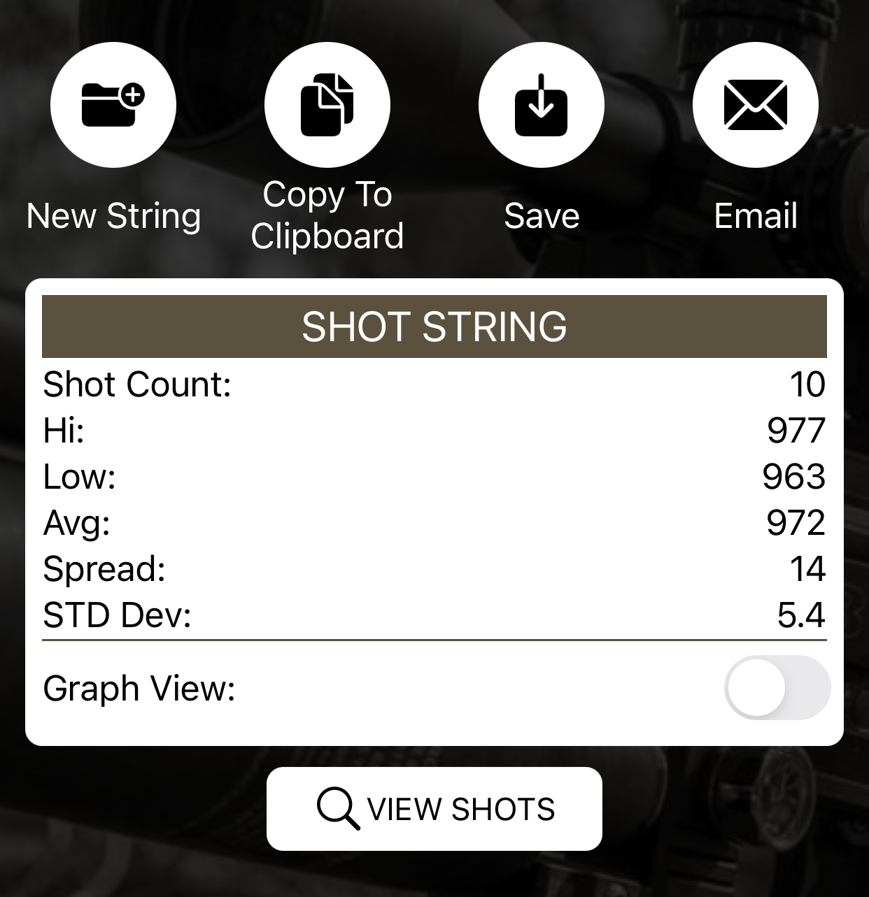

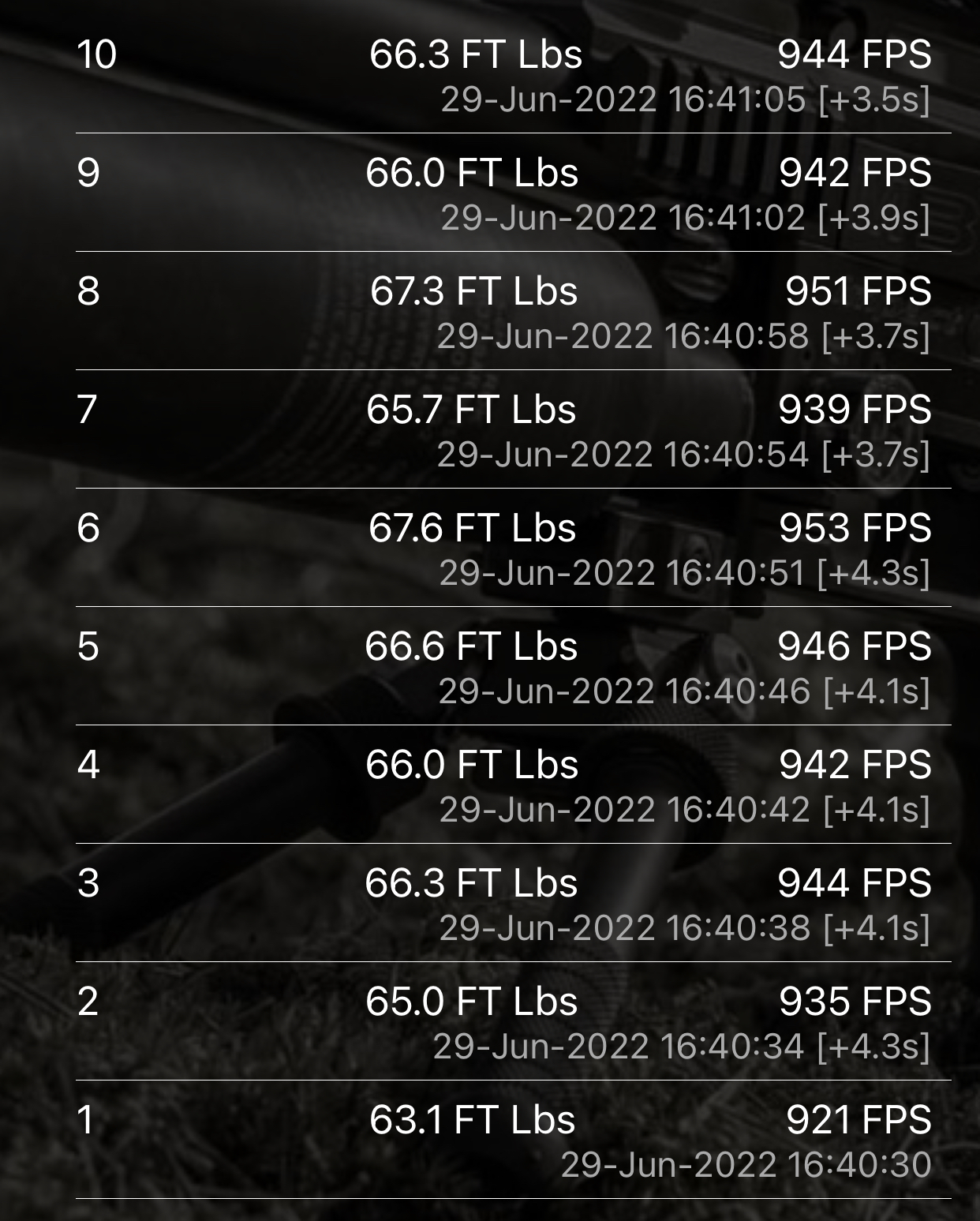

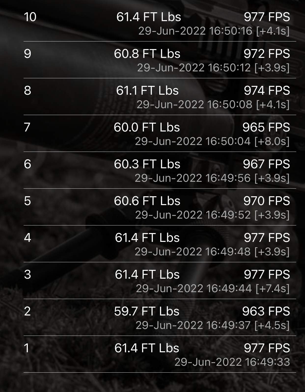

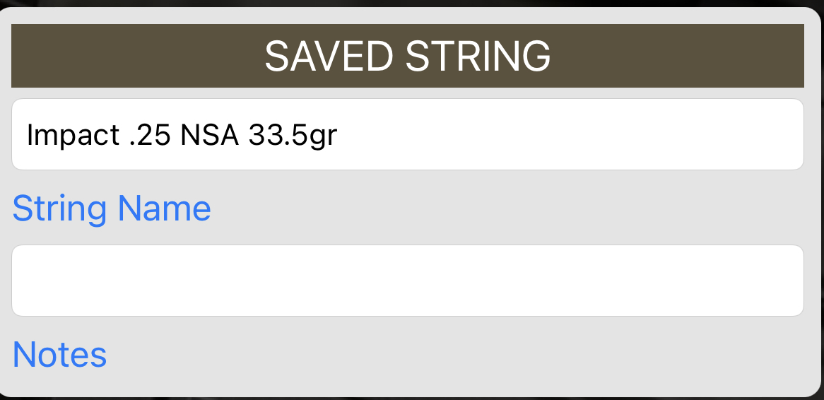

So here are my settings and then my tuning results on the chronograph only. I’ll be at the range on Friday to see how things work out.
Settings:
Fill: 245 bar
Reg 1- 150 bar
Reg 2- call it 123 bar
Macro- 15
Micro- 4
Valve- 4th line….
29 gr NSA and also 33.5 gr NSA
First shot being a little slow is pretty “normal”, I always scrub my first shot or two by dry firing. My more than $2000 dollar Thomas with famed none creeping Huma regulator also have the same problem so whatever. Also if you choke down the return valve to get to your desired speed it is unlikely to have very noticeable slow first shot.
Very good shot string but I would keep it under 950fps because it’s more efficient and more consistent at around March 0.8. Sweet spot for the 700mm barrel is just under 950 fps. Take your 970FPS tune and instead of reducing hammer spring try turn down the valve so the speed get to about 950, start shooting 5 shot groups at 50 yards as you reduce speed with the valve till you find a speed that will give you the one hole group. Then it's easy MOA at 100 all day unless there is a tornado! The real test is how it groups at 100!
If your muzzle blast has a bark then it will very unlikely to group well consistently, if that happens raise your second reg to 150, I usually set the first reg to 200 so it's out of the way and refill the second reg quicker. Again, listen for the bark because it is a sign your tune is not good. A shot with a good tune will be very quiet with a thud but no bark, this is wisdom from the great Ted Holdover! Last couple of weeks I've tuned 2 M3 with that approach and found sub MOA at 100 yards in matter of 10-15 minutes every time using 3 different NSA slugs. The only down side is once you get it tuned it's rather boring so you will want to try different slugs and caliber and barrel length............LOL!

Gotta love those slow first shots out of a $2k gun. Ruins a whole shot string unless you cheat and fire off a bunch of shots to get the old girl warmed up first.
I wouldn't consider it cheating , its like knowing your drag car isnt going to make its fastest pass the first run, need to clear the lungs out.
