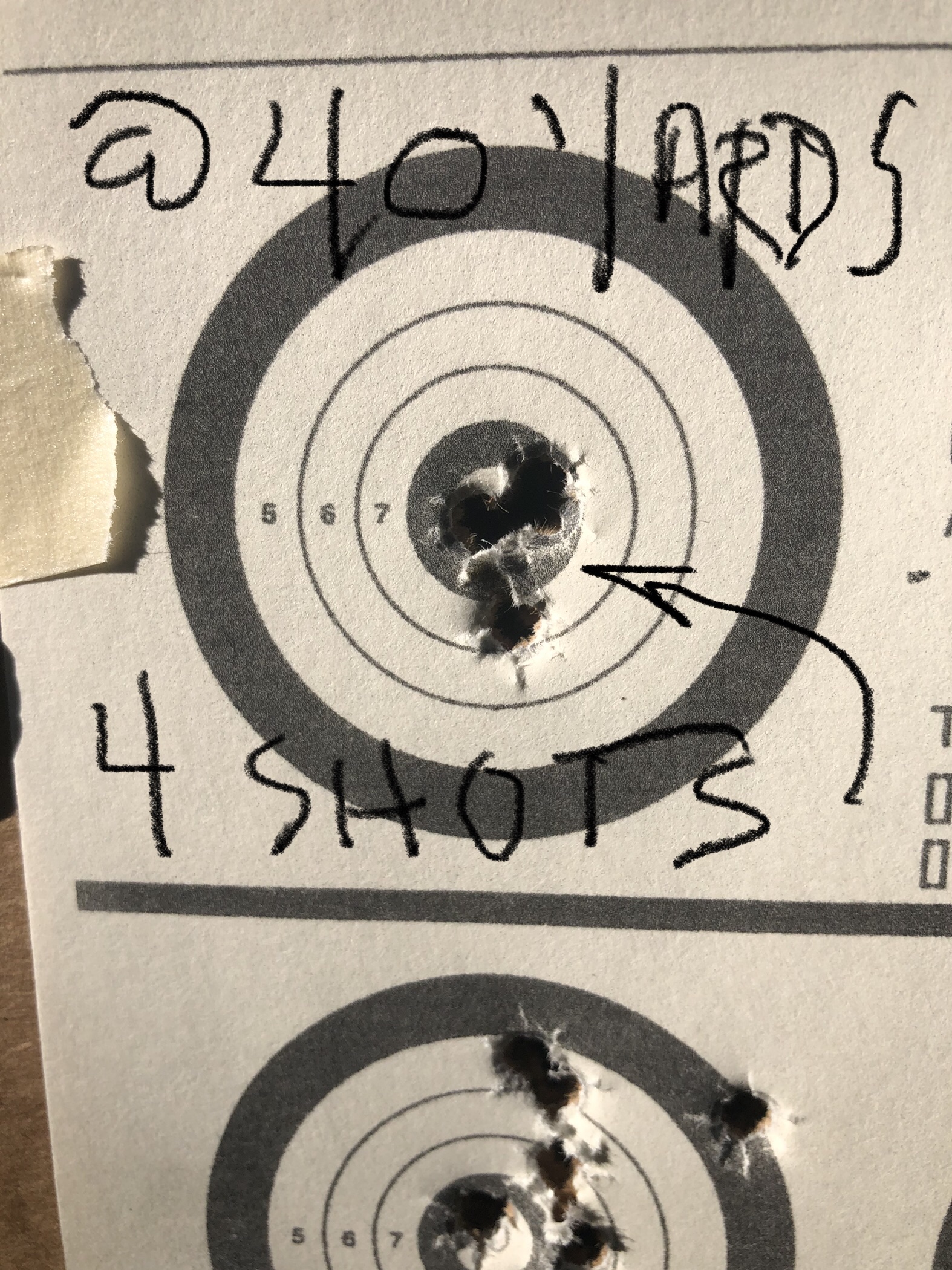

Just went out and shot some groups with them and they're still getting dimes at 40 yards. Dunno what happened after the tune, I didn't change anything but add a spring. My POI went high and right but it's dialed in now. The rifle is an air hog now, I lost about 15 shots in its curve for the extra 10 fpe but that's a trade off I'm willing to accept. It's going to be solely for hunting I have others for plinking and a compressor and 3L bottle to fill from. It's supposed to be a 500cc bottle but it's smaller than my other 500cc bottle so I'm guessing somewhere in the 475cc range. 280 bar is where I fill to, but its rated for 300. Might fill it full and see what shot count and numbers I get.
It's definitely grouping the NSA slugs very well now so after the cudas are gone I will just switch over to those 33.6 slugs and be done with it. Just gotta stretch it out to 100 yards now.

Turned the hammer spring out 2 turns and it's still in the 880s for 40 shots. Much quieter now, and I'm thinking the erratic POI was the extra muzzle blast behind the pellet after exiting the barrel. Might drop it down to 850s with these and probably end up with 60 shots in the curve. That's still touching 50 fpe with a better shot cycle and I'm sure the accuracy would be better.
