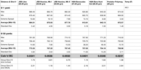

Just as a PSA, I figured I’d share with you the results of my measurement today of 6 pellets in .25 caliber, as shot through my RAW HM1000x, polygon barrel: the JSB lites (25.39 grain), the JSB Heavy, Mk I (33.95 grn), the JSB Heavy, Mk II (33.95 grn), the H&N Baracudas (31.02 grn), the H&N Baracudas Hunter Extremes (28.40 grn), and the Predator Polymags (26 grn) pellets. Pellets were not measured and were taken straight out of the tin without sorting for weight. No sorting for head sizes was complete either.

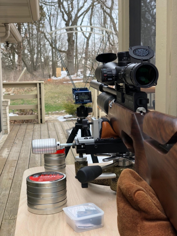

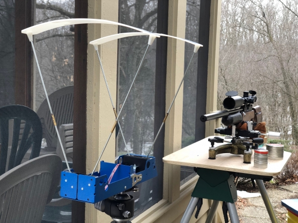

Muzzle velocity, near was taken with the rear window of the chrony at 1 yard from the tip of the moderator
Distance to far measurement, was taken with the rear window of the chrony at 50 yard from the tip of the moderator
Delta (distance) between locations: 49 yards (measured with a Nikon laser rangefinder with angle compensation)
Setup​ @ 1 yard:

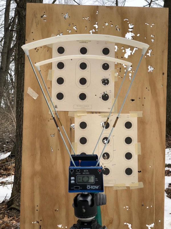

Setup at the target (@ 50 yards, a 49 yard delta):

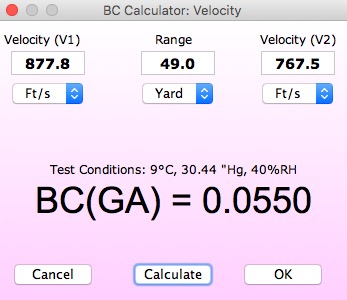

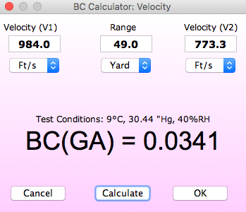

I opened up Chairgun (Mac version) and adjusted the environmental conditions, altitude, etc. I then went to the BC calculator app, plugged in the data, and calculated the following results (below). The average temp today was 48.3F, with virtually no winds (1 mph out of the N), 40% Humidity, pressure at 30.44 in Hg.
My gun: RAW HM1000x, setup in .25 caliber, with a LW polygon barrel. Notes: the same chrony was used at both distances. Velocity data is shown below. I shot a full magazine at near and far, with each pellet (so 12 shots for each x 12 setups = 144+ shots).
A few comments: don't read too much into the standard deviations of the less accurate pellets (JSB Lites, H&N BHE, and PP) at 50 yards. I had several 'err1' or 'err2' messages as the pellets drifted slightly left or right, not centering over the optical windows. I feel this affected the reading slightly on certain pellets-thus I had to reshoot several of the JSB lites, and PP to get a full 12 shots of data. To be as accurate with the numbers as possible, I threw out the high and low (for calculating the averages) for both the 1 yard and 50 yard data. The standard deviation and spreads shown in the chart below represent all 12 data points for each pellet, at each distance-not the middle 10.
I hope this is helpful information for anyone looking for data from this gun / setup? If so, and you appreciate the time / effort, please take a minute and leave me a ‘+’ (it’s just a small way that makes me feel like I’m helping contribute useful content to the forums).

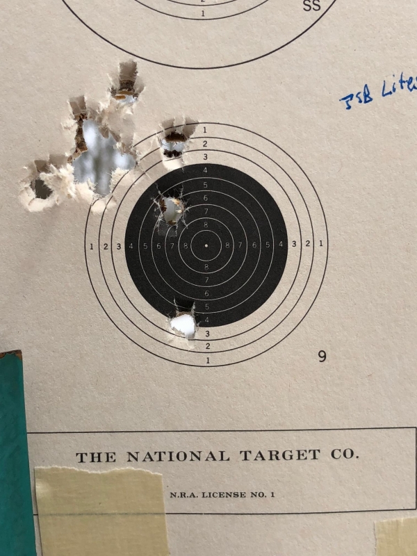

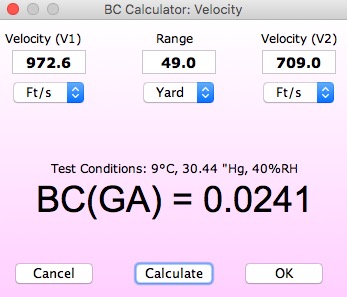

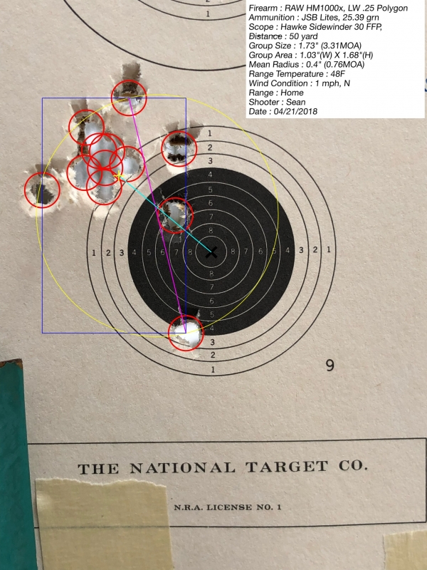

First up: JSB lites (25.39 grn):
1524358994_4313273795adbdf523d00e7.65894702_25 Cal BC - JSB Lites 25.39 grn.jpg

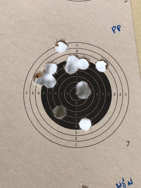

12 shot group:

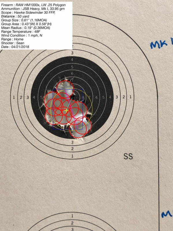

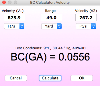

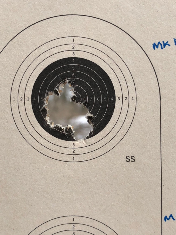

Next up: JSB Heavy, Mk I (33.95 grn):
1524359031_3019601955adbdf77e852e5.96528147_25 Cal BC - JSB Heavies, Mk I 33.95 grn.jpg
12 shot group:

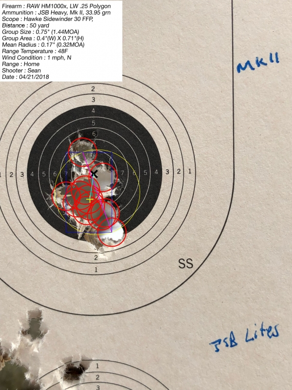

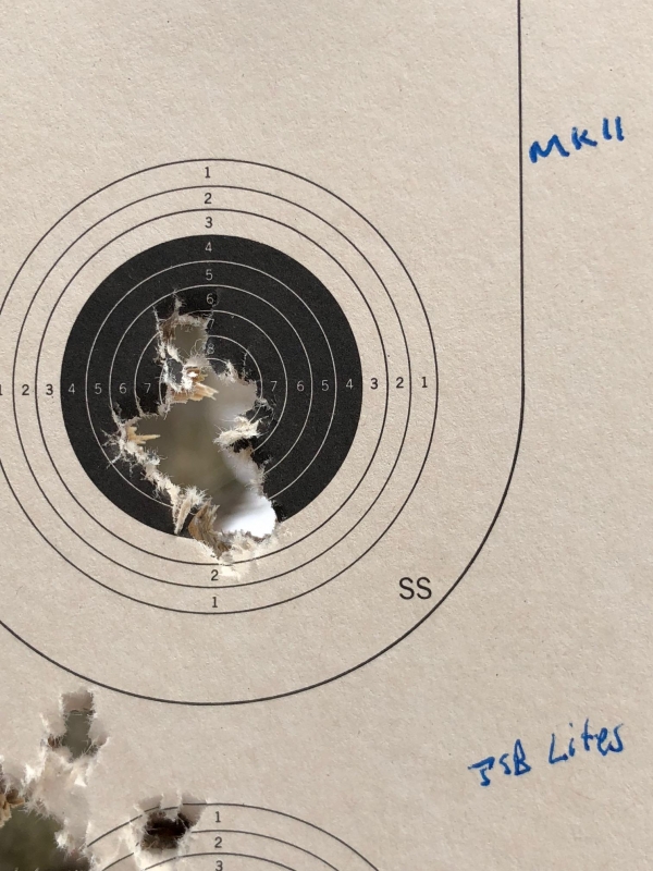

Next up: JSB Heavy, Mk II (33.95 grn):
1524359209_322787205adbe0297f0874.74404094_25 Cal BC - JSB Heavies, Mk II 33.95 grn.jpg

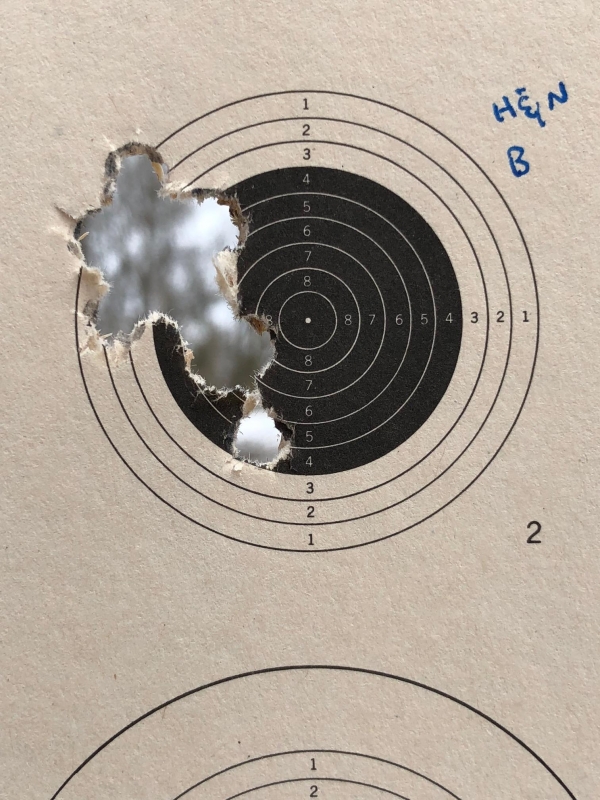

12 shot group: (note the shots at the bottom are from the JSB Lites)

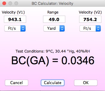

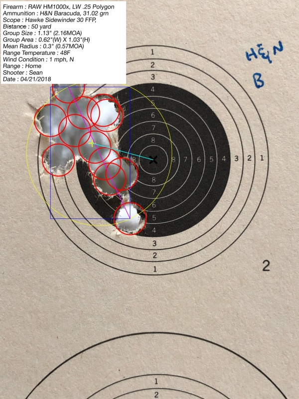

Next up: H&N Baracuda (31.02 grn):
1524359292_19160369665adbe07cc1da33.48150271_25 Cal BC - H&N Baracuda 31.02 grn.jpg
12 shot group:

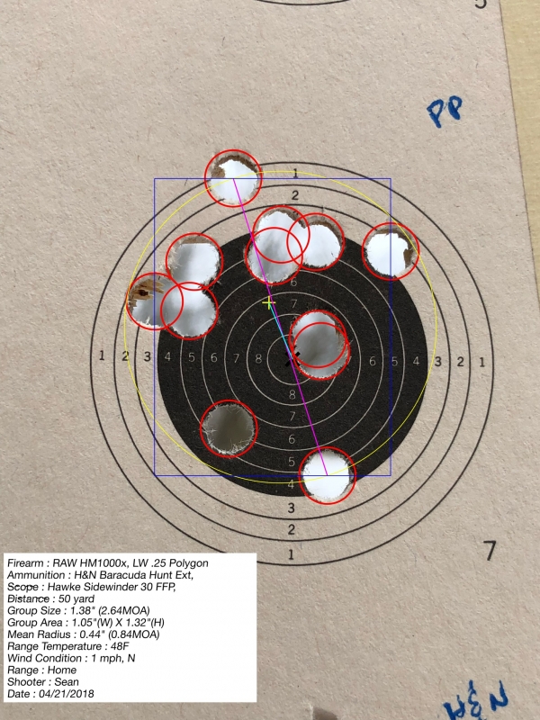

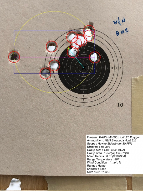

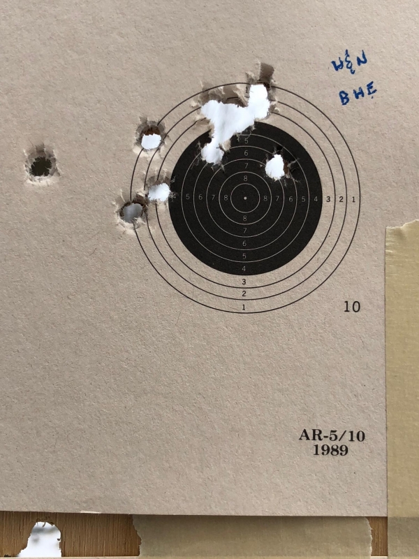

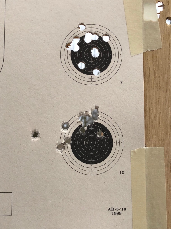

Next up: H&N Baracuda Hunter Extremes (28.40 grn):
1524359337_6344808965adbe0a9471b31.64057351_25 Cal BC - H&N Baracuda Hunter Extreme 28.40 grn.jpg
12 shot group:

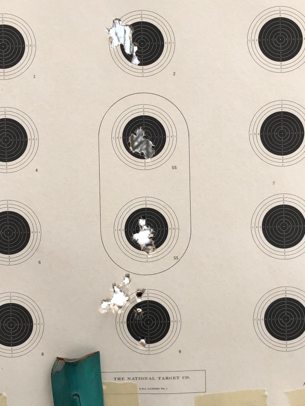

1524363762_10257721985adbf1f2afaad5.95709412_3A0637BB-C962-4CDB-8D6B-4450F753149D.jpeg

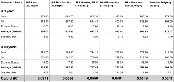

And the RAW data, summarized in chart form (pun intended, LOL):
1524359410_8546590135adbe0f2a9dcd2.80301276_25 Cal BC of 6 pellets, compared.jpg
Overall comparison of the groups:
I will measure and post the 12 shot group sizes in a little bit. I have household things to tend to at the moment... :)
Sean
"SMH77"Updated chart with 12 shot group sizes added in inches and MOA.
1524364266_14863046125adbf3ea970cf4.78633667_25 Cal BC of 6 pellets, compared-updated.jpg
Clear Winner: JSB Heavy, Mk I pellet. Close Runner Up (in my gun): JSB Heavy, Mk II pellet.

"Groundhog"Thanks for the hard work and info . I found the MK1's at avg 824 fps has a bc of .0393 , did the calculation @ 77 yards . Velocity matters .
I think you're about to open up a bit of discussion: what gun / barrel did you test that on? Smooth twist / FX barrels seem to report lower BC's than LW or LW Polygon barrels do (hence why my numbers are higher than those in Ham's DB-he tested using a ST barrel on the Impact). The velocity alone probably isn't making that large of a difference (0.0556 vs. 0.0393 is a HUGE difference in BC).
Also, what was your close distance when you measured the BC?
Sean
I think there are too many differences in testing parameter to draw a straight comparison and conclude BC is affected by velocity (though I do agree it has an impact on BC). Also, comparing the BC's I came up with against the ones you're reporting (using totally different methods, different barrels, etc) is really apples to oranges and is going to make a direct comparison very difficult.
BC should honestly be tested out of each pellet / barrel combination with a specific method that is held constant. This is actually why I set out to test and report what I did for both .25 and .30 caliber pellets (the ones I had at my disposal): because the HAM's database didn't cover the pellets I was interested in between those two calibers, and becuase they were tested on a setup (and distances) that I knew would alter the BC's from what I shoot. Actually, when I first joined the forum, I was specifically looking for BC's from the gun (or barrel) /ammo combination I was going to be shooting a lot-and didn't get good answers, so I set out to document them, and share my finding (and document my method) for others to benefit from.
I hope I'm not coming across as negative or dismissing your BC's in a rude way-I don't intend to do that. I just don't think a comparison can be made directly between them because there are at least 5-6 different factors that I can think of that will affect the results directly, and only one of them is velocity.
Sean
Thanks for putting in the work , really . Wasn't trying to open a can of worms . Realy just posted to illustrate that as you said bc will vary by combo , methods used , etc . Encouragement for others to test and find out what their bc is rather than just useing the numbers they find on net .
And you have inspired me to delve deeper into this and find out for myself how much velocity aeffects the bc by experimenting , and try both methods of measurement . Thanks .
