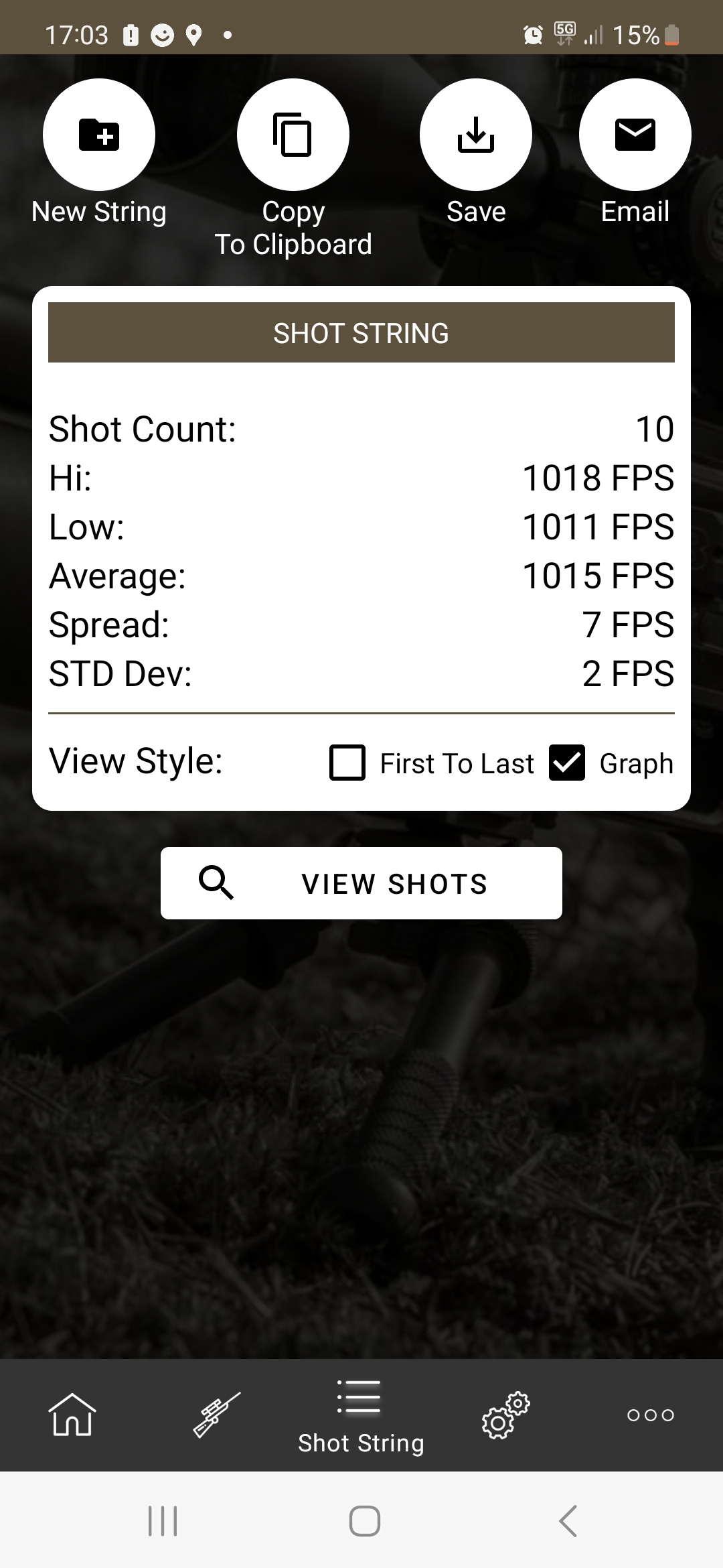

Hi, I Just bought 6pc of 28gr zan slugs in hope that it would shoot better groups than the 35gr i have shot so far.
If it can be called group i can hit 10 shots within 7cm at 100m with the 35gr @ 950fps.
This is all done with standard 600mm liner in crown mk2. I have read more than one post that says 35gr is not optimal in standard liner and a lighter slug would probably do better.
Thats where i finaly gave in and orderd some packs with 28gr and tought to myself this Will be a win win cuz I can now lower the preassure and maintain the same speed and get better groups.
I was soooooo wrong xD i sure could lower to 120bar to get the 950fps but the groups did not get better, about the same. I have tried 910 up to 950 and the groups are about the same, I have not tried higher than 950 yet, anyone here think I need to push 1000-1050 to get better groups at 100m? If not i can Just go back to the 35gr and get even more fpe out of it
