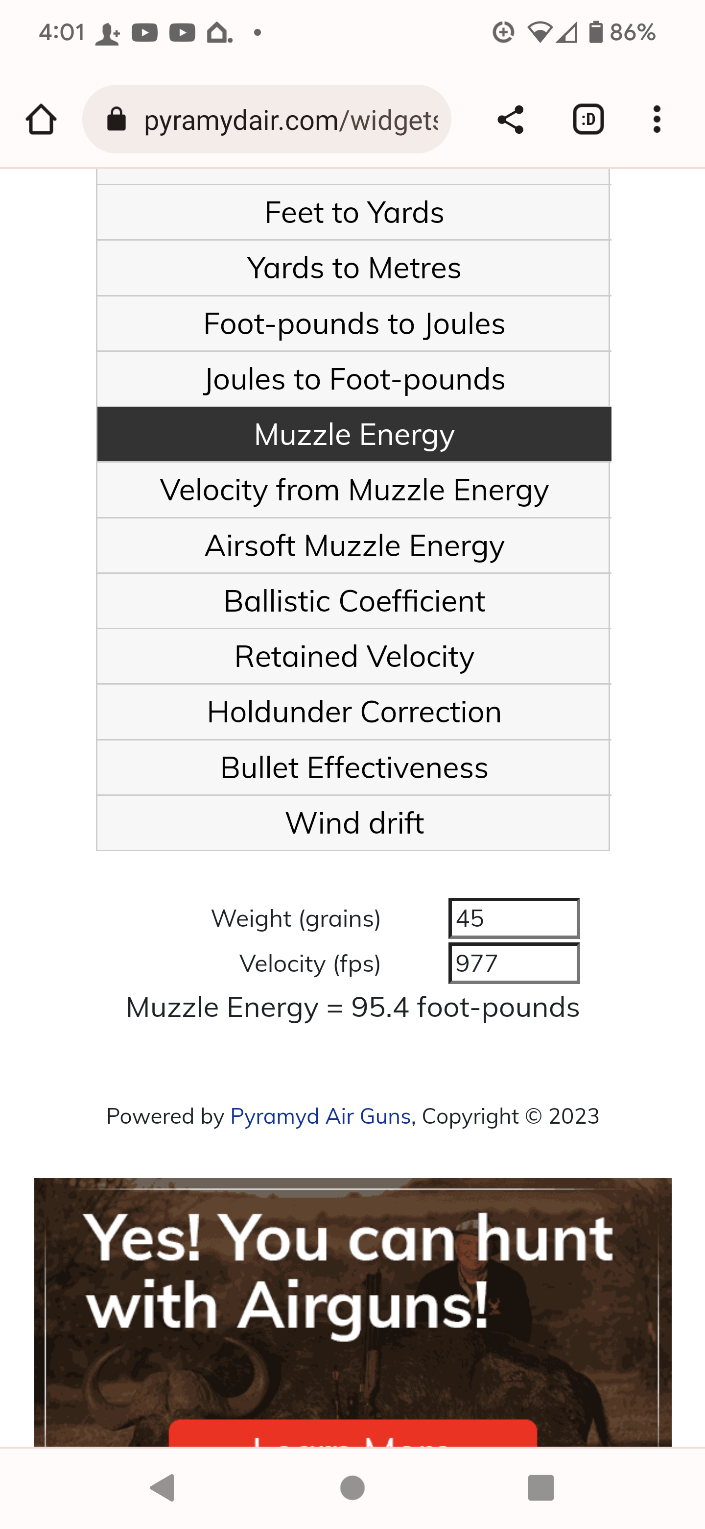

Had a goal of getting my avenger to over 80 FPE with slugs and I have surpassed that mark. This was with a 45 grain slugs. I honestly think 100 FPE is possible with a couple small tweaks but that may be a bit too much. I knew it was going to be hot when the first 34.9 grain NSA slug went 1100!

Ohmygosh. That's more than a few tweaks !! Wow !! Nice job.
Normally in stock form they are very accurate with moderate power. I too am curious if this modified 25 Cal can still shoot well? Maybe Revenger can post some groups after he hits his 100fpe.
Well it has a TJ barrel on it which shoots pretty good. I will make sure to give it a good testing here soon.

Stock .25 avenger is rated at 45 FPE I think but they will do 50 FPE out of the box. My gun is highly modified at this point.
I have seen at Pyramydair site that the Avenger gives 24 shots at 45 fpe. At 95 fpe should give 12.... Correct?
