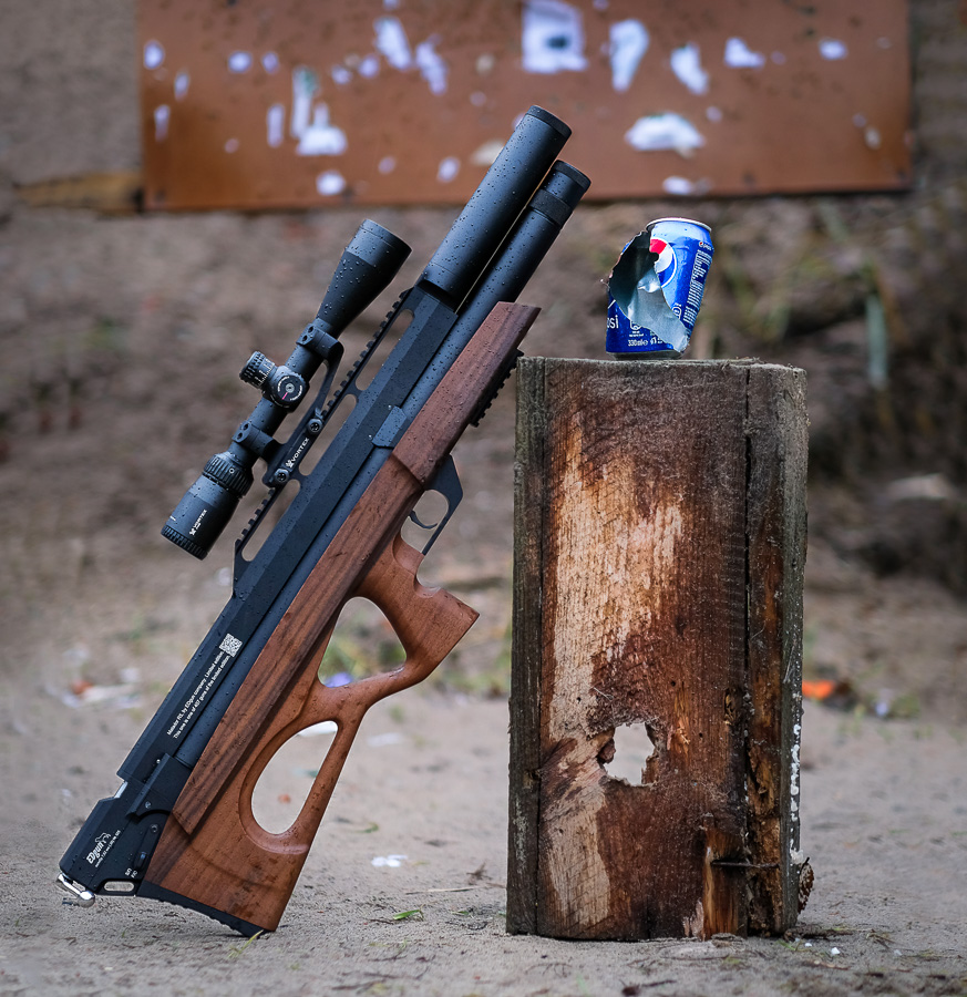

Hmmm... interesting. For me reason was easy... to go through all paperwork required for a high power airguns in my homeland I just wanted really big bore, something more substantial than .25. On paper the difference in diameter is not big, but when you place .30 cal pellet next to .25, well, no comparison. And I can tell you that I simply enjoy the process of placing that chunk of lead into breech of my R5 Matador, and than sending it at more than 100 Joule of energy. I just enjoy it, it's the only reason. And 15mm c-t-c at 100m is good enough for me ;)
