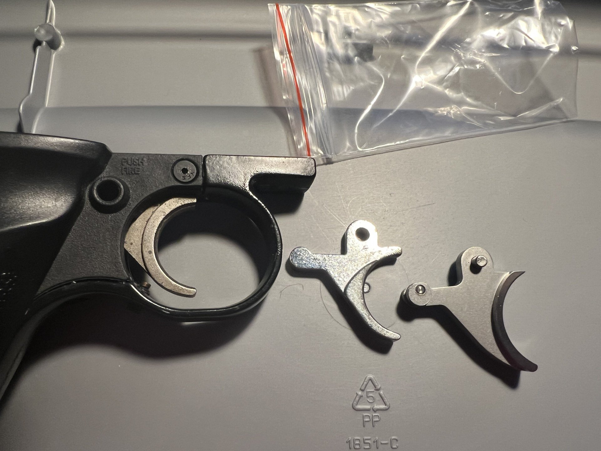

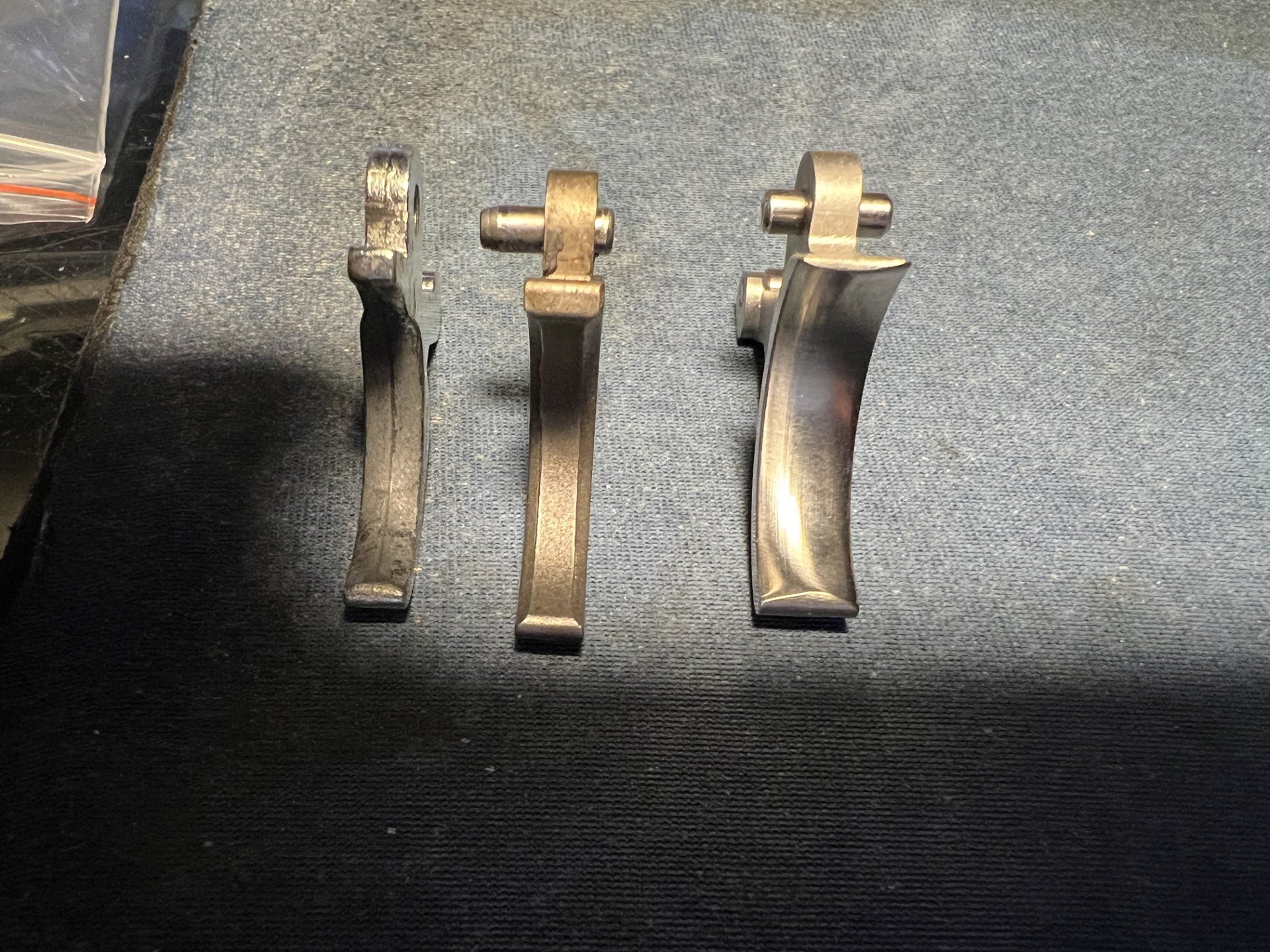

there are three many triggers the stock one, the one that comes in the 2300s which is wider and the roller trigger that Cothran made which are even wider at the finger and the Cothran doesn't use a pin as the pin is in the trigger
are the ones one Ebay Cothran maybe or copies

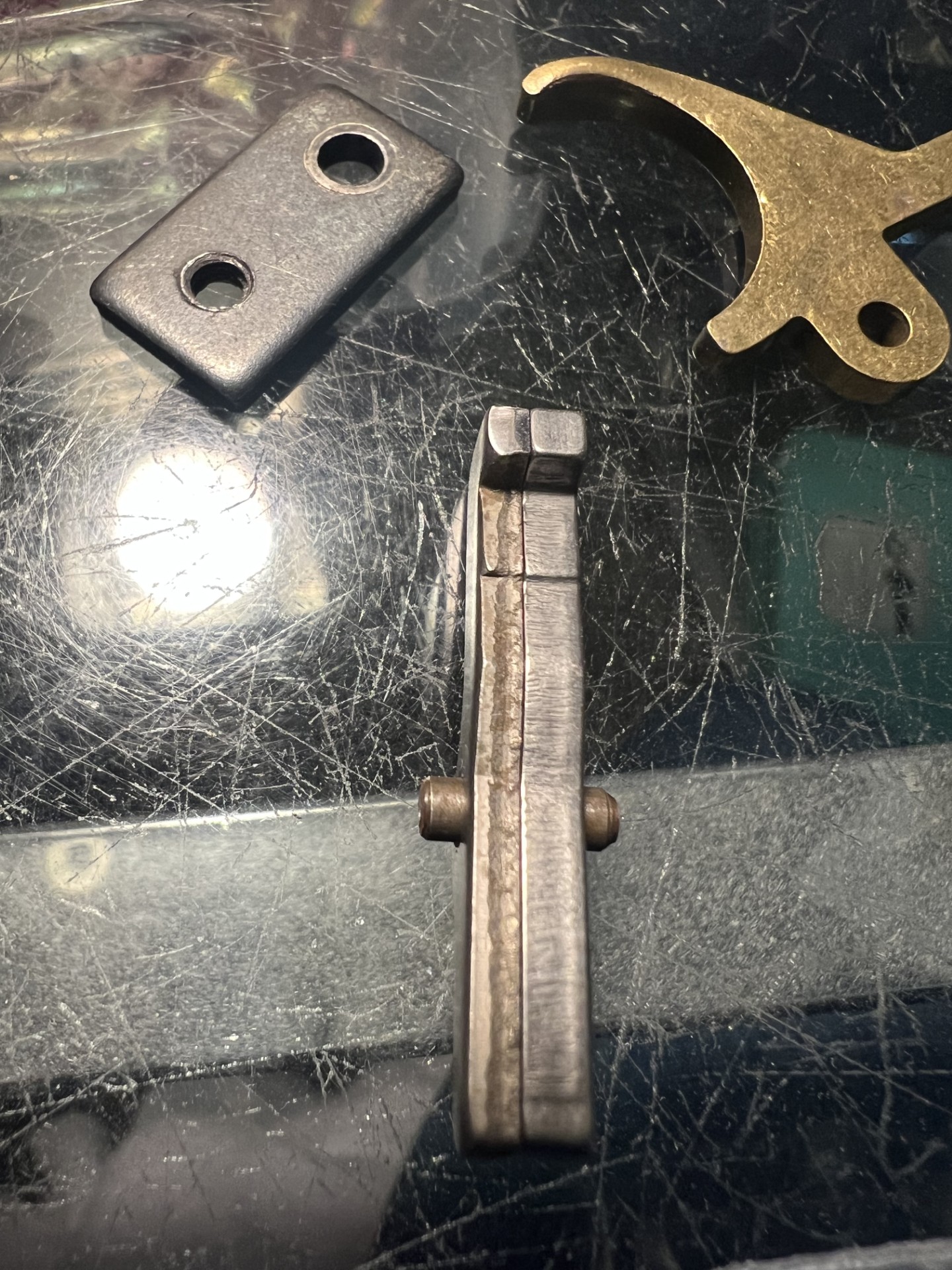

Magnum makes and wider sear nice pieces and they have better pins say with me here
trigger sloop is a problem trigger wiggle loose sear twisting and turning is it a lot no but that not the point

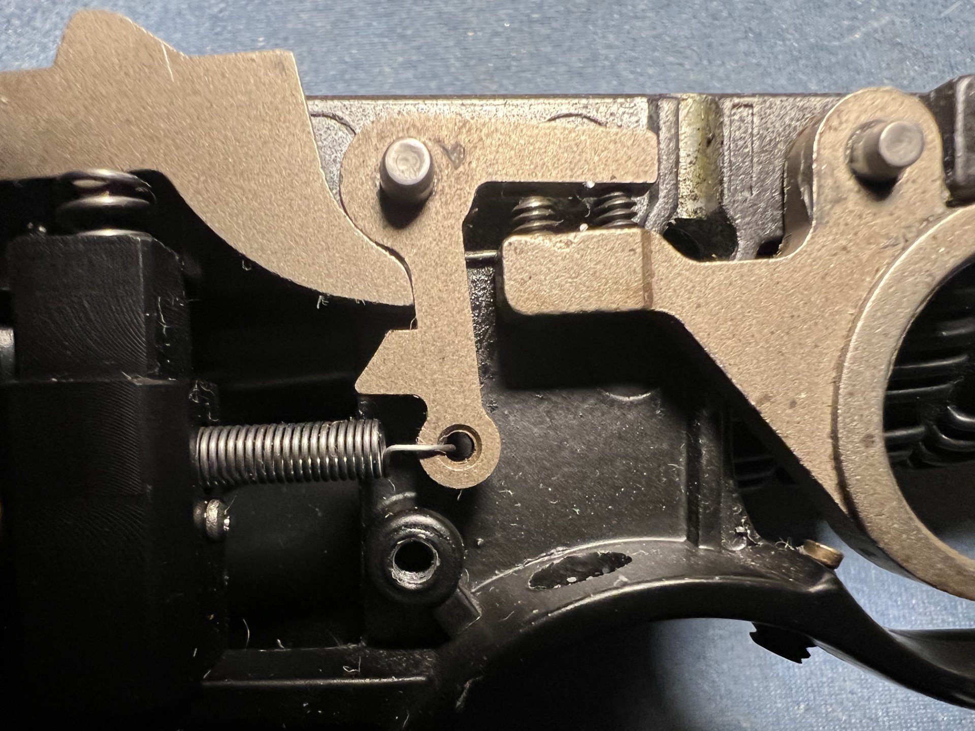

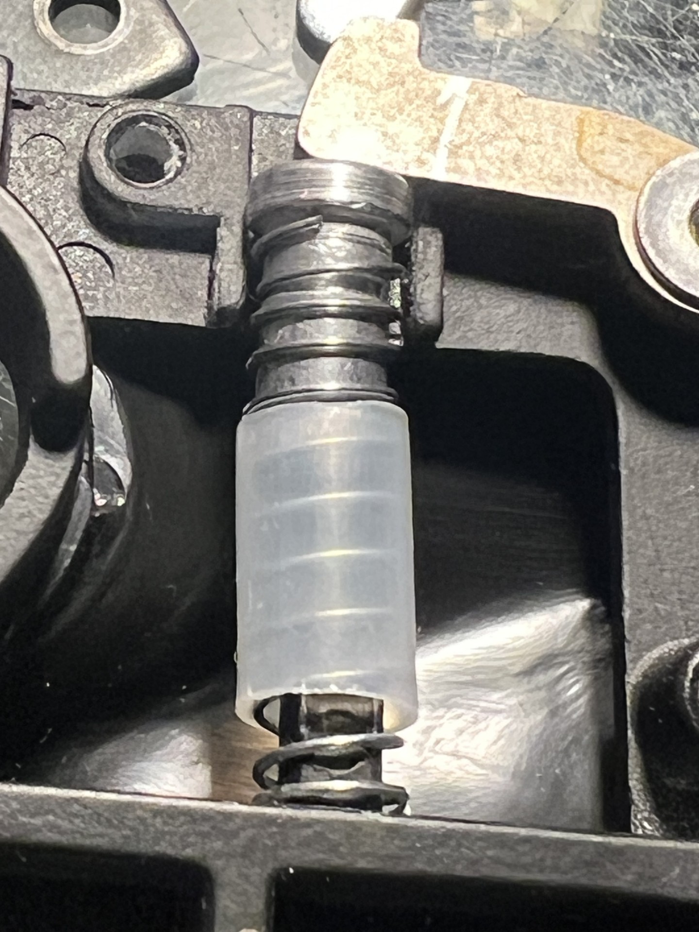

sear spring as little as it will take and work but ass the spring gets lighter in wire dimeter the spring will not stay straight so support is needed as in tubing
so there is one other thing that i have done but you have to be care not to take too much
reduce the sear to hammer height about 0.8mm will do that take the time to disengage the sear from hammer

I cannot remember where I got mine from alchemyairwerks on ebay. I polished the area on the sear bar where the trigger (roller) contacts it

It’ll make your trigger very sensitive, especially when paired with a Don C Roller Trigger and MAP spring.
Mine is a single with no slack, but I did add a very thin piece of soft rubber on top of the trigger blade’s ridge to create a pre-tension.
If you would notice, the trigger raises itself when you cock it; that rubber will get squeezed between the ridge and trigger frame.
