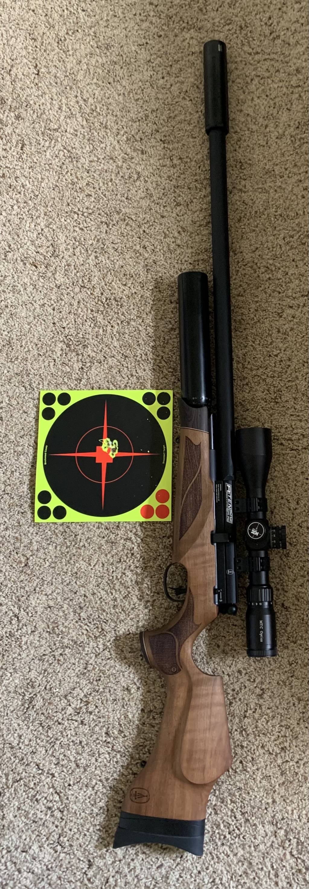

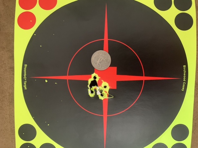

These two play very nice together for those who still shoot pellets lol. Right around 965-970fps out of a tuned bsa r10. Its pretty consistent accuracy, somedays slightly tighter, some slightly larger but I never get unexplained fliers or anything. I shoot straight from the tin, damaged skirts and all. Heres a 10 shot ( mag) at 110 yards today. Ive got a stack of these targets similar but their cluttered up with other guns/pellets. This is my ground squirrel killer, but could maybe be competitve? I dont know.
I had a BSA super ten in 22 when they first came out. I would bet there are very many similarities like barrel etc. Yours is certainly a keeper. Depending on how you define compete, I think for what you have, you would have a great starting point.
Plus, I love the looks of those R19s. Great triggers.
enjoy it!
Super Duper exceptional group. 10 shots is literally twice as hard as five. They’re usually twice as big. Believe me, I’ve tested it again and again.
mike
That must have taken some doing to get that tune, that hot? That is no easy task! Most my Guns won’t push them over 850 other than an impact.
nice job!
It wasnt too bad! A very light hammer, porting, peek valve, huma reg, 23” barrel and and some tweeks. Reg is around 160 bar. Shot count kinda sucks at those speeds but its for hunting. I get two full mags and then 3-4 more before it falls off. So basically 230bar to 160 bar is 23-24 shots at 52fpe. 280cc bottle also. I also shoot this gun simulating hunting. No bipod or big $ rest and the butt is just floating on my shoulder no rear bag.
Looks good, definitely good enough for 100Y BR at EBR. Bring it down the road next week and step into the arena... It'd be great to see a non-Impact on the line that has the potential to do well... The gun is good enough, it'll depend on the shooter how well it does.
I wouldnt care if I came in dead last Id love a chance just to shoot with the pros! One question can you shoot tethered?
