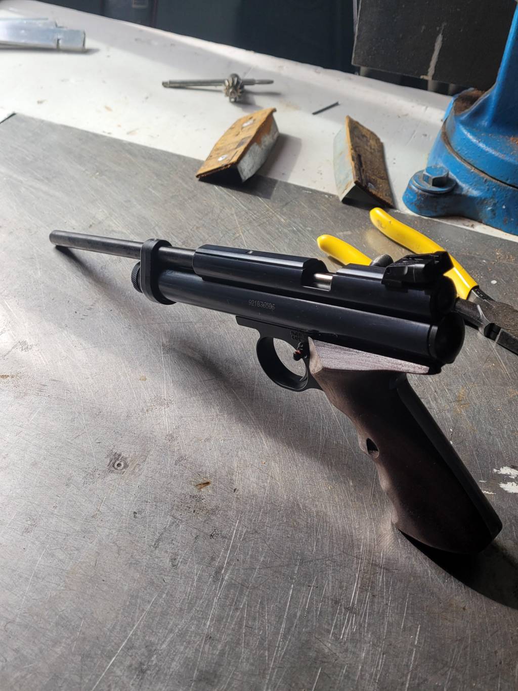

I uprgraded to a 10" barrel on this gun and wanted to go with open sights. I had been using a small Hawke RDS but it now resides on the Prod. These rear sights were on the 1377, but I'm getting older and the wrists don't like all the pumping much. I'd like to have something with, I don't know the the term, the translucent rod that glow at the ends? Share your thoughts.

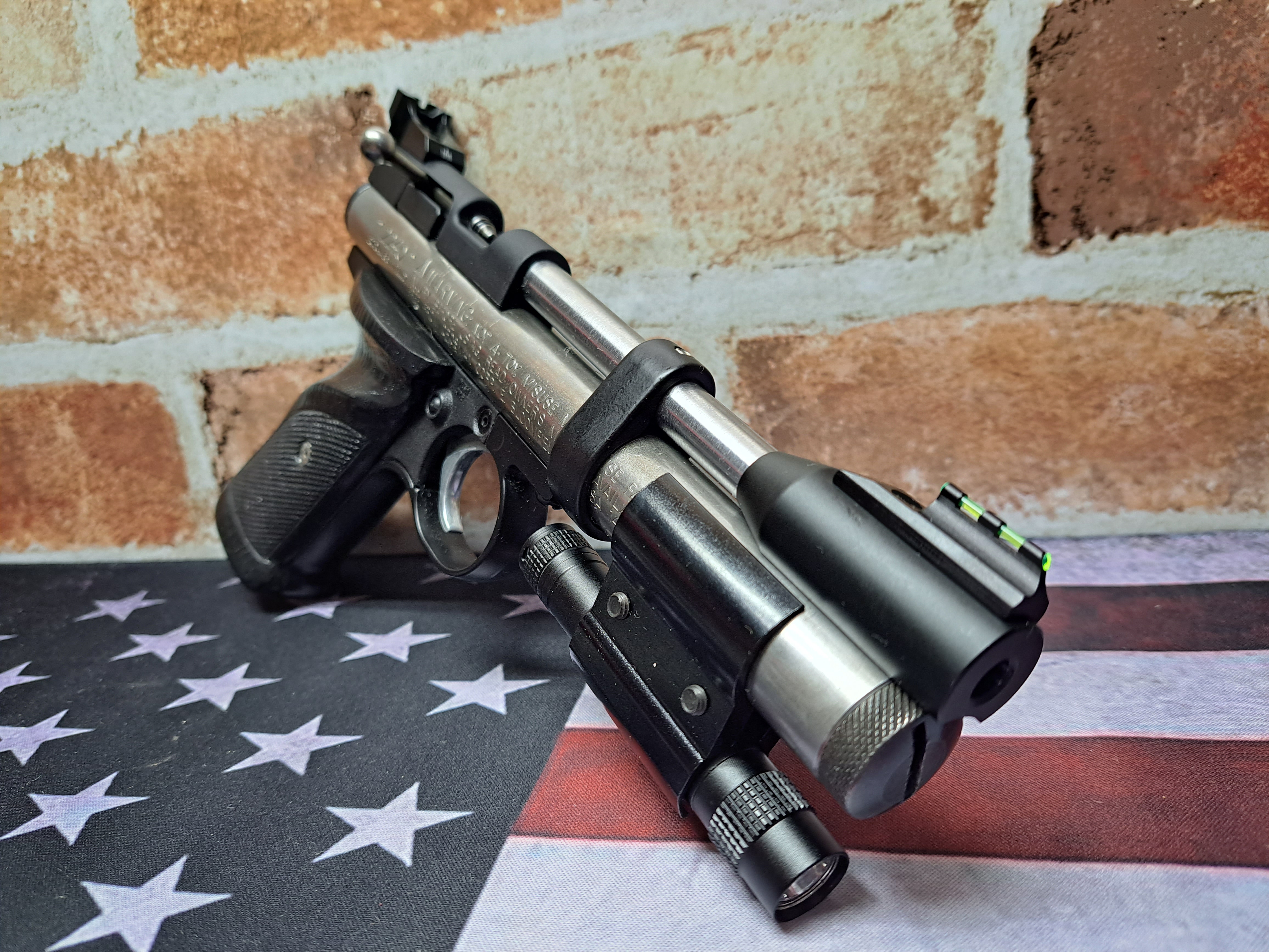

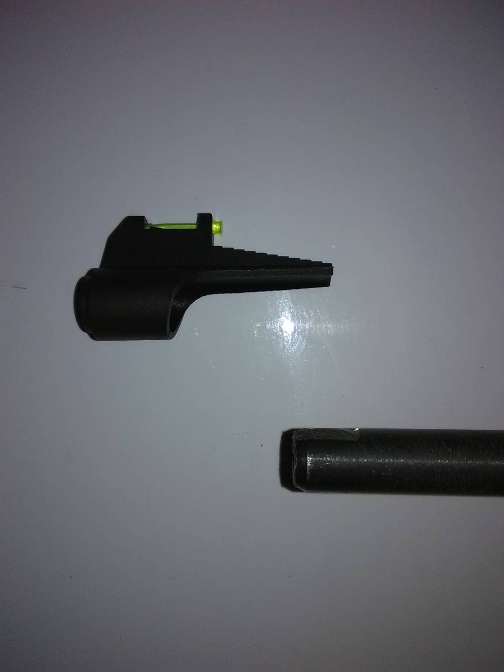

There is the Glow Dot sight above and the regular sight available from Crosman and eBay as well as many others. Although without the cutout in the barrel you will need to do a little Dremel werq on the inside front of the sight to get it to fit the barrel better. Then use some epoxy to get it to stay in place.

If you put a TKO moderator on it you can use a shotgun front sight. Double sided tape or a little epoxy will keep it in place. Or you can carve up a 22x sight and epoxy it on.

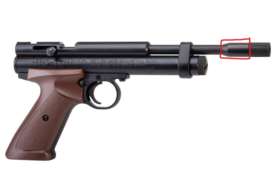

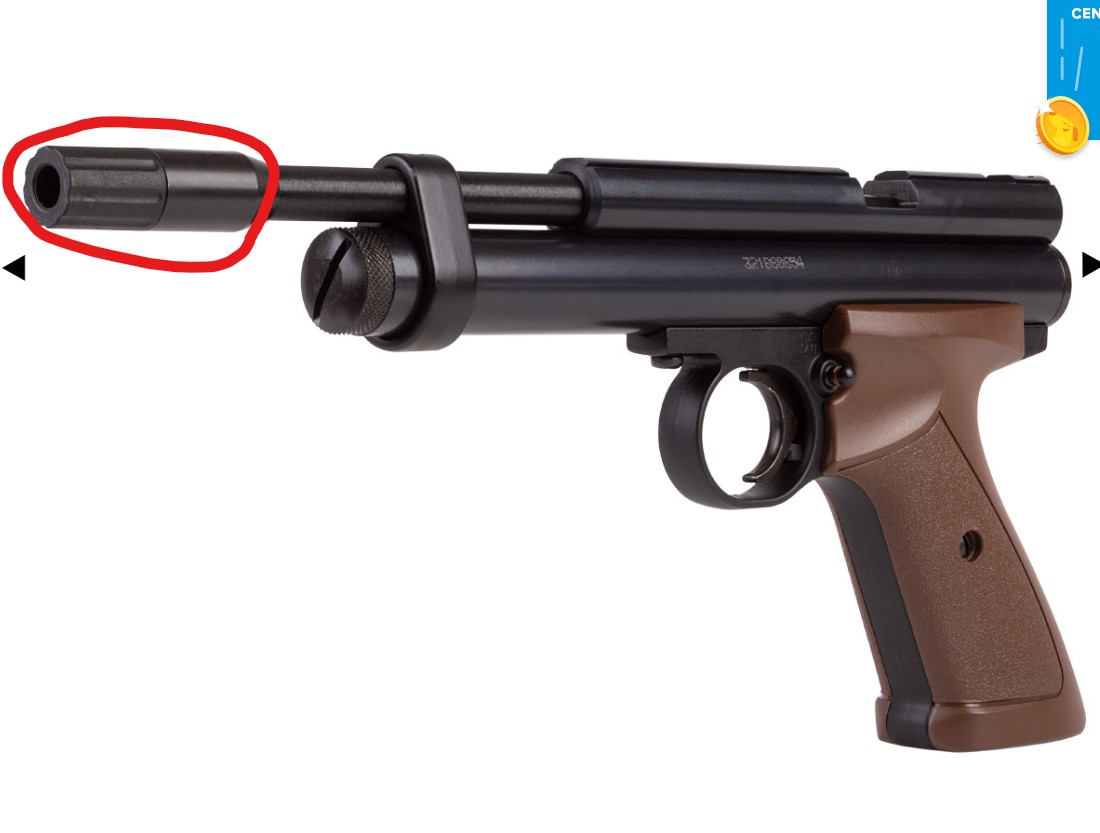

Any idea if the larger diameter part of the barrel (I guess it's a muzzle break) is removable? I know the very end piece, the thread protector is, but if the larger diameter piece is removable maybe I could just use a front sight designed for the 2240.
