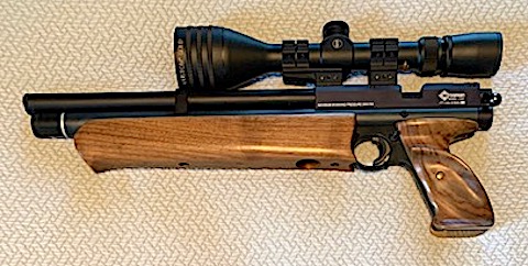

My .22 Crosman 2300 with Corcoran "real wood" grips and HiPac HPA gizmo-

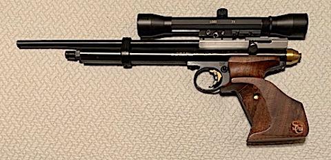

My 1701P with Vernon Austin "real wood" grips (after removing the finger grooves and refinishing)-

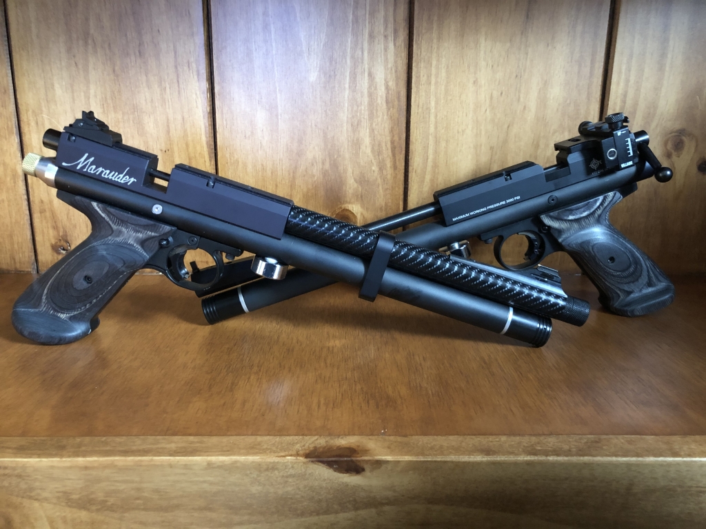

My 1720T with V.A. "real wood" grips and my own fore-end-
