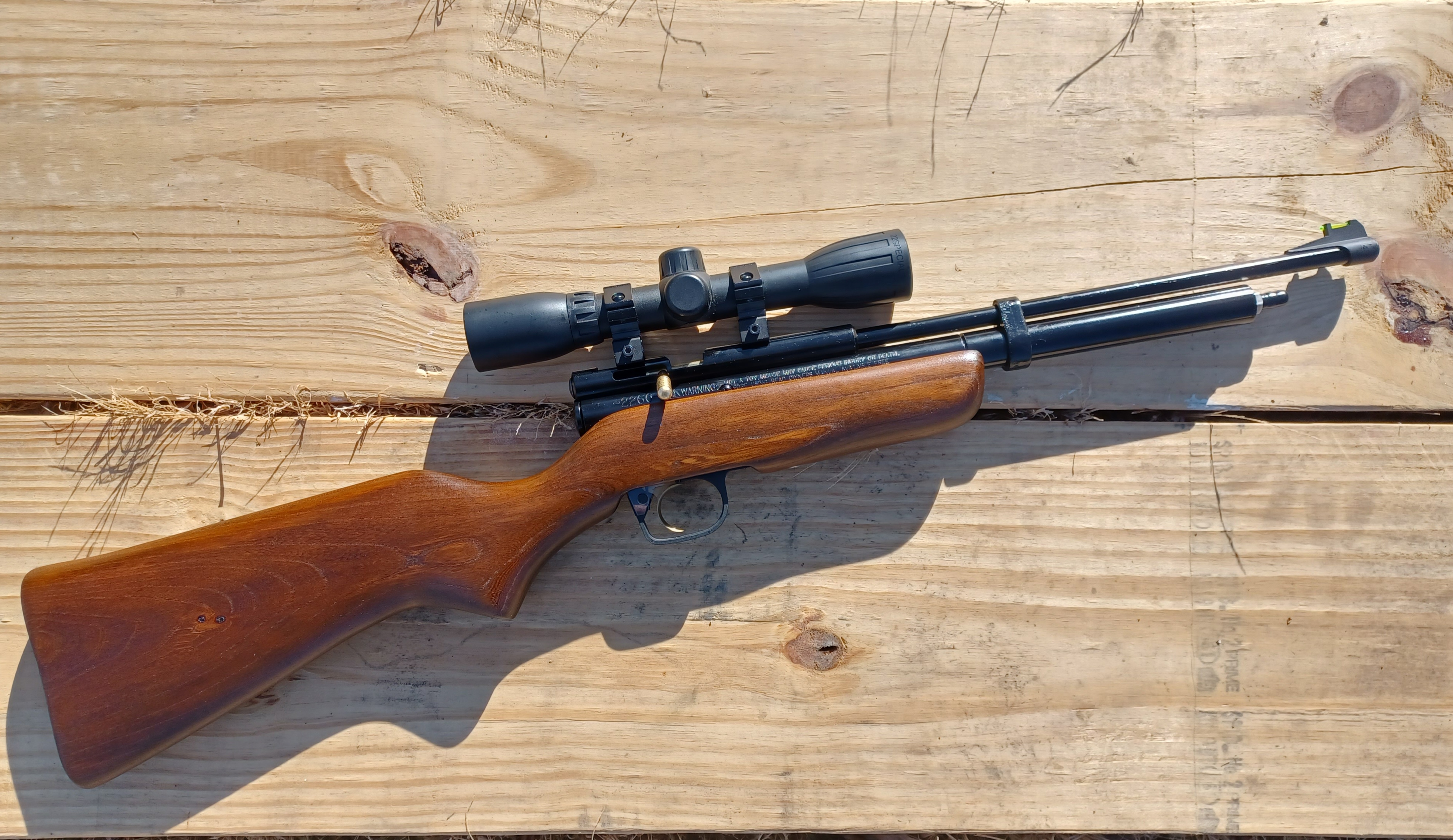

Found some pics of the 2240 safepac mini rifle I made. IIRC, it got around 10 good shots in the 750s with cphp.
2400 psi fill and a slightly smaller transfer port @ .125 vs .140

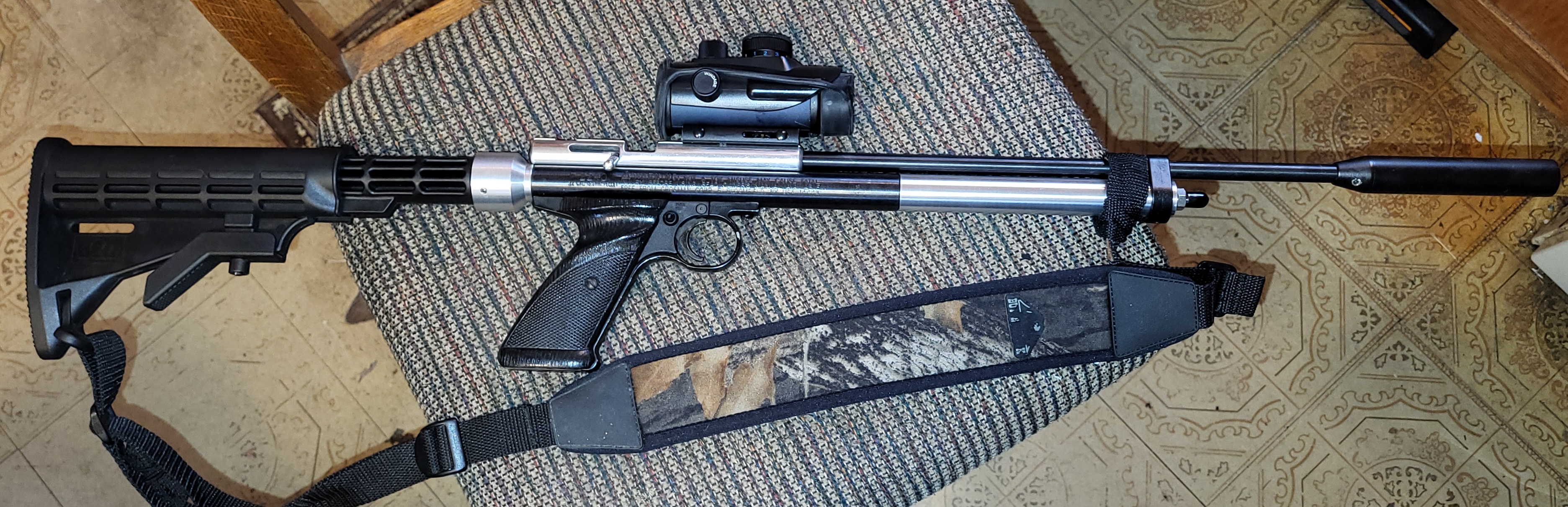

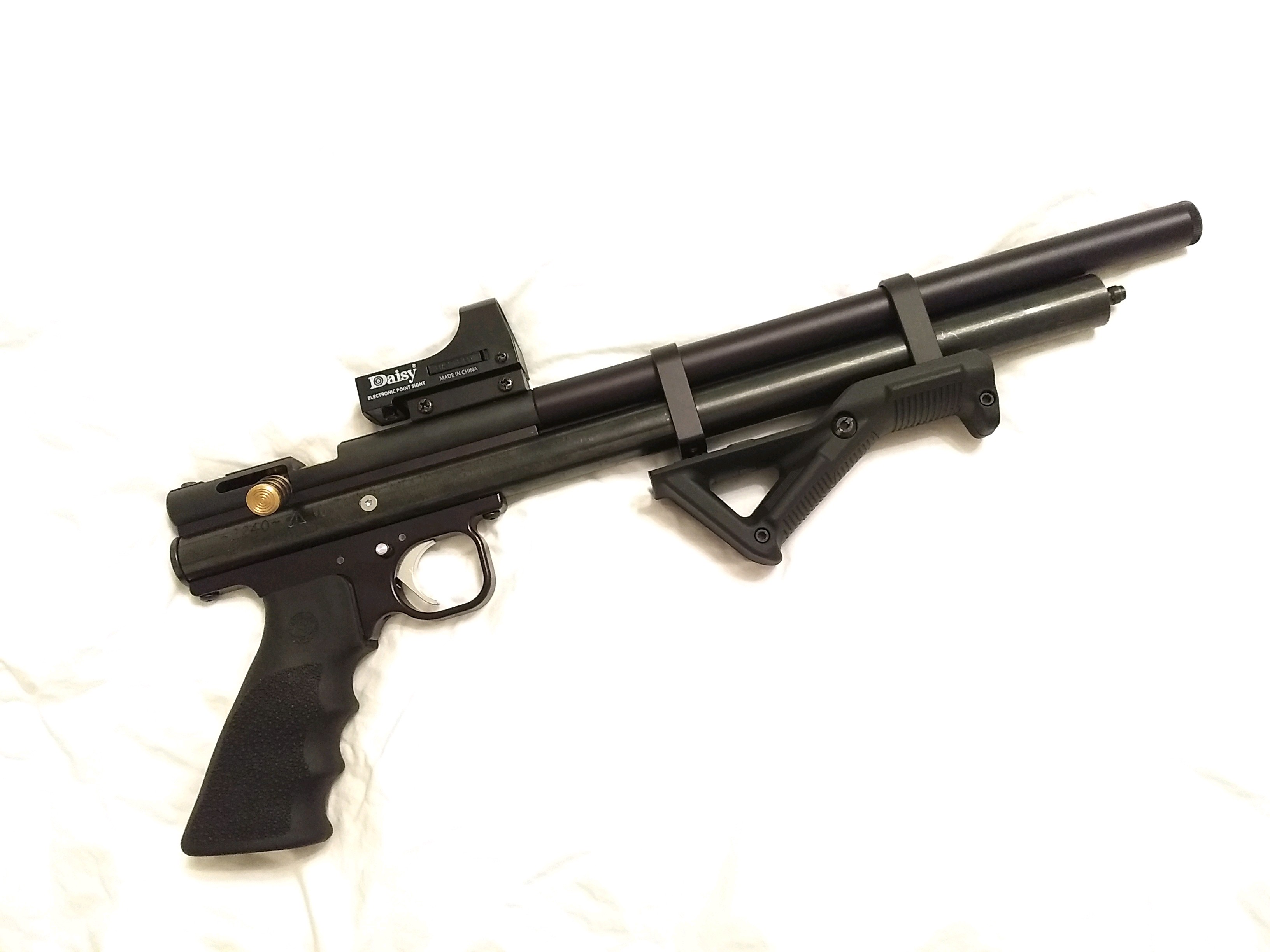

This is my 2040 with a hipac, hence the statement to pin the valve. Right now, it gets 16 shots at around 500fps. Curve begins at 1800psi. Still have a couple of things I want to do to it, but it's doing pretty well as a short range pester so no hurry.
Is that the older hipac, or a safepac from Rob(Froggy)?

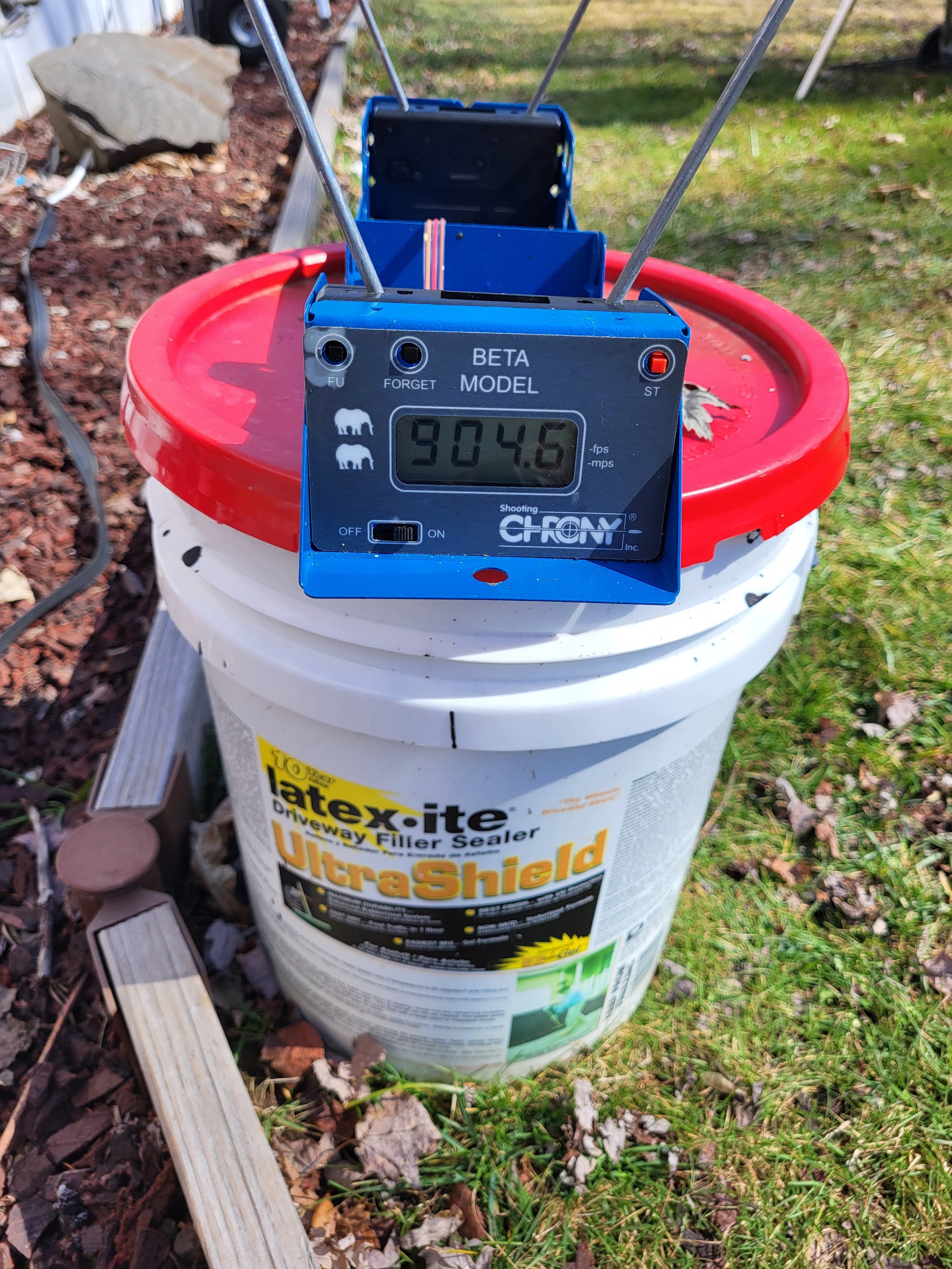

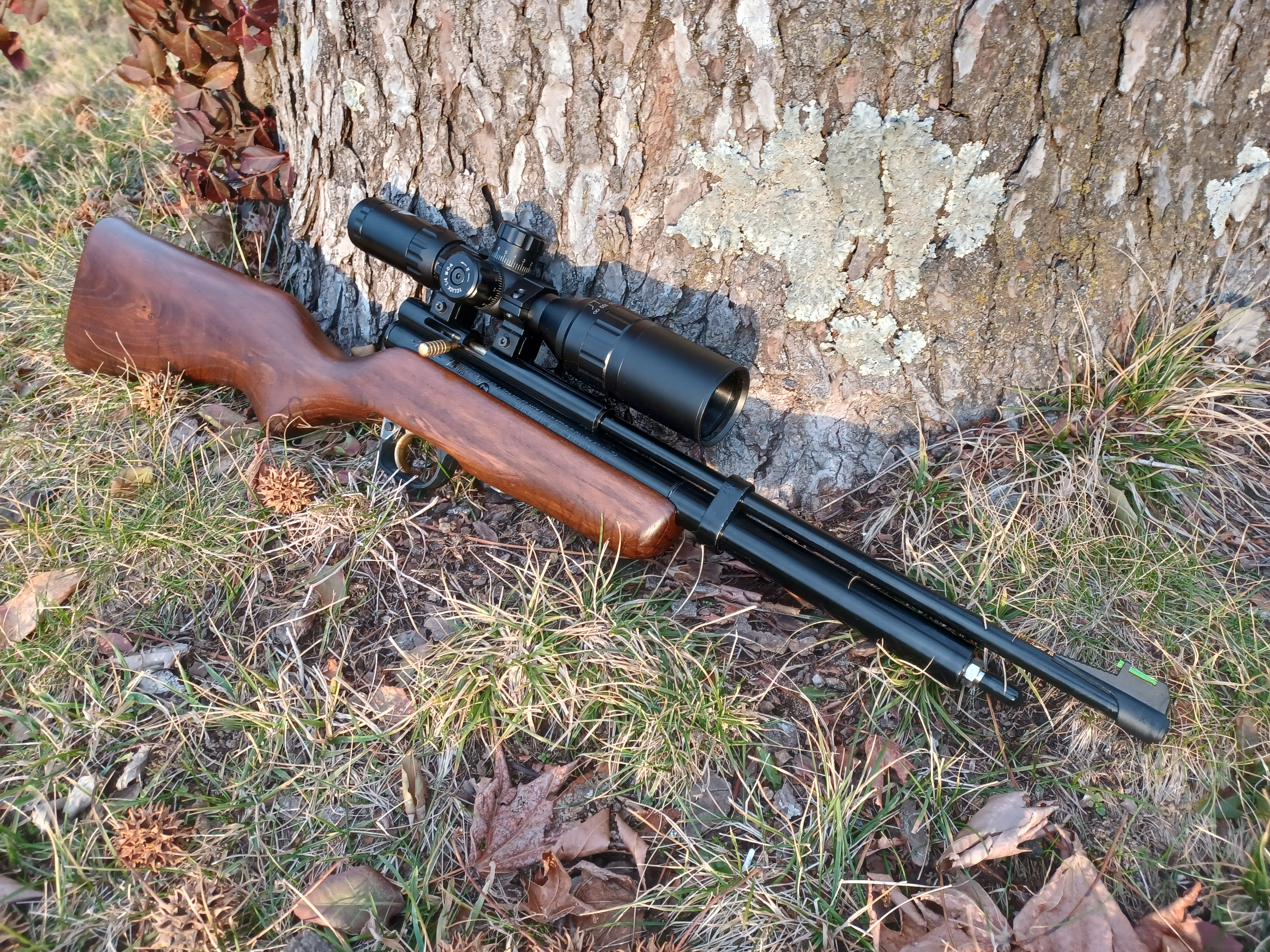

Looking good, this is a pic of mine in its current configuration. On the high side it will send 8.3 g superdomes at 900fps. Found a different spring in my spare parts yesterday, haven't had it out to see if the consistency has improved yet. Am expecting about 8 shots within reasonable specs.

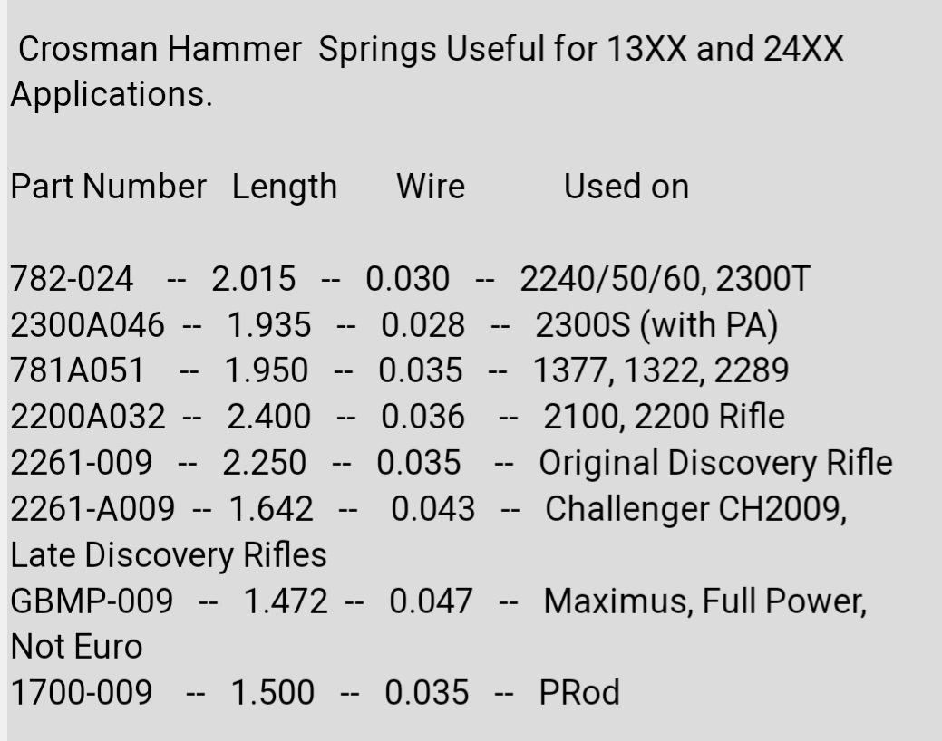

Also, to the OP, you can order springs direct from crosman or you can take your spring out and go to a hardware store and search their bins of springs but be sure to take some micrometers to measure them
Helpful spring party numbers

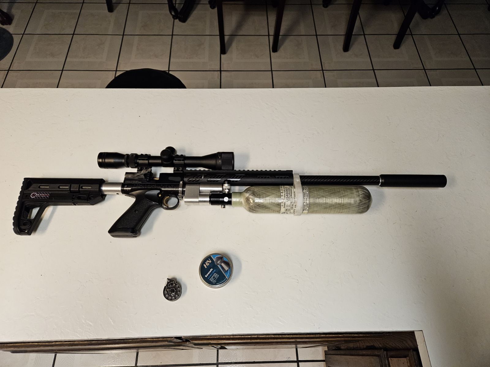

Just updated my 2240 to utilize some accumulated parts I had laying around. Made an adapter to use Notos stock and pic rail. Made new plenum above the reg bottle adapter. Valve is attached directly to the bottle adapter, so no need to pin it. Using P-rod trigger. Tensioned Lothar Walther barrel 18" long. Currently set to 30 fpe @ 1800 psi. 0.5 liter bottle.

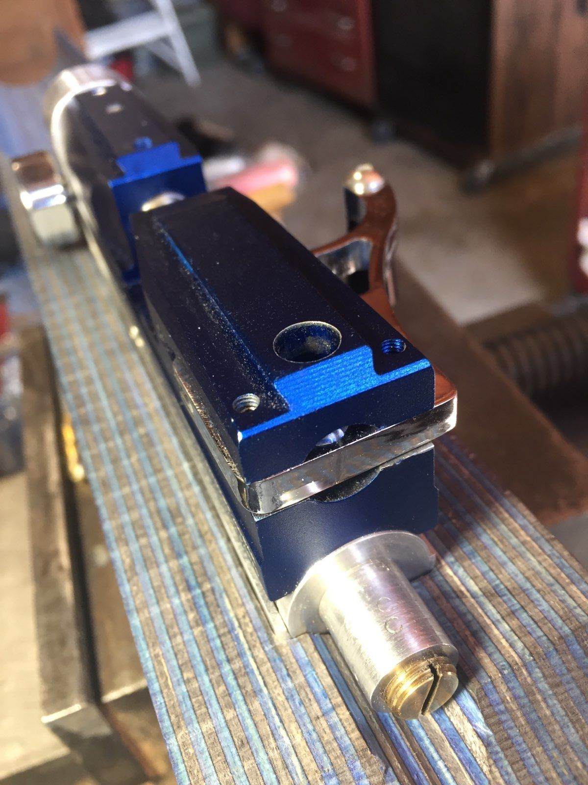

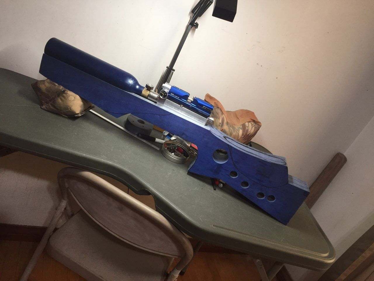

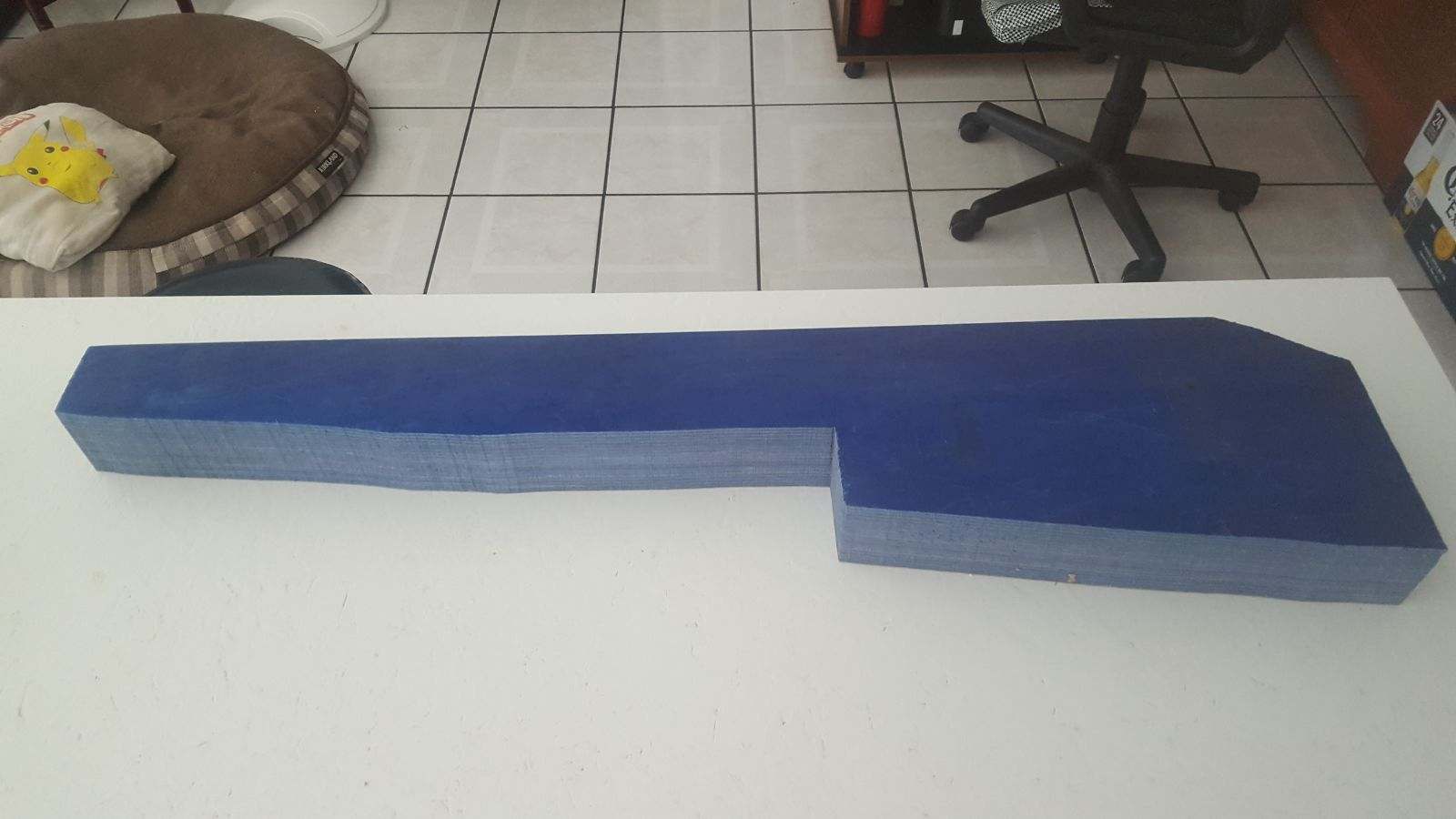

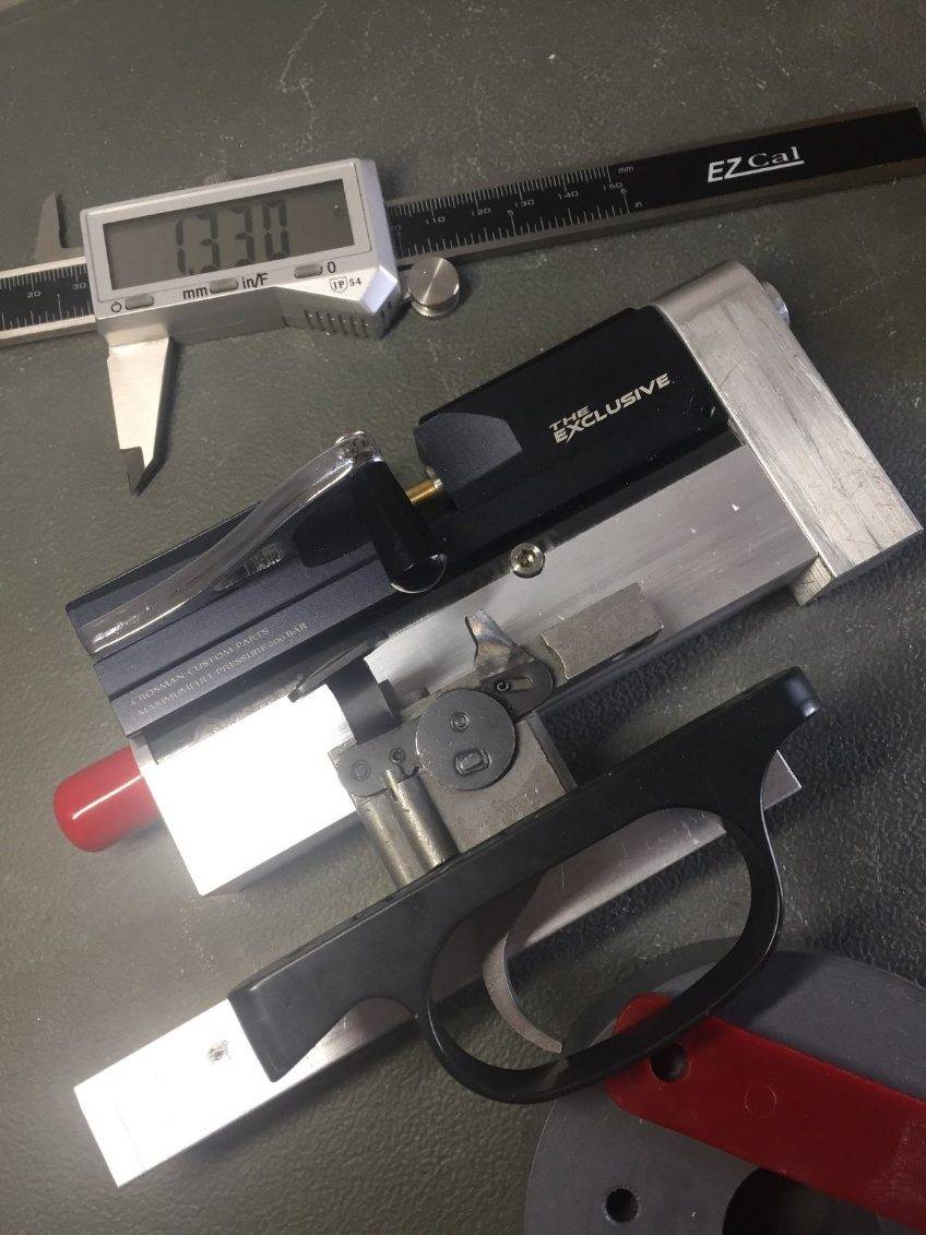

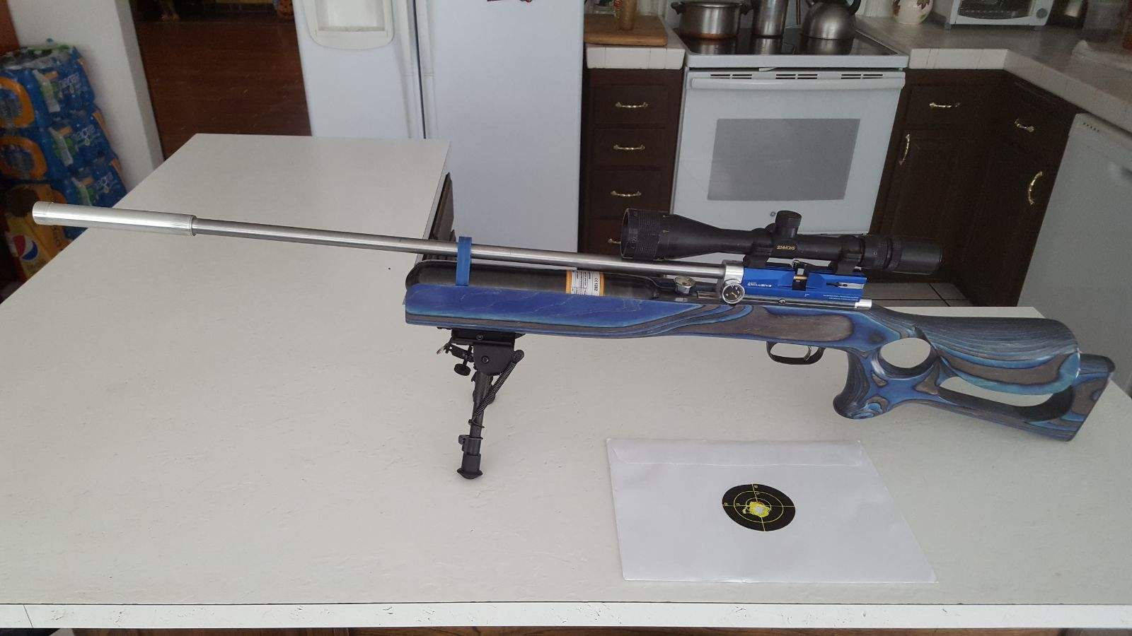

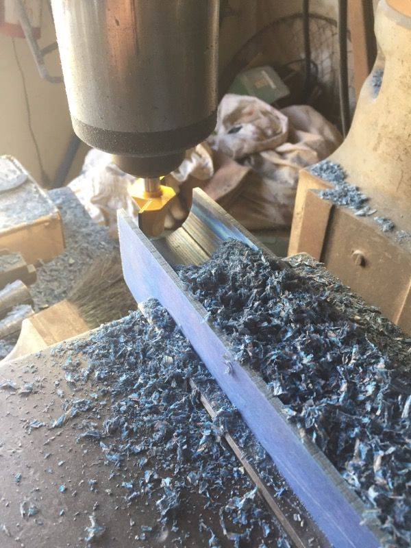

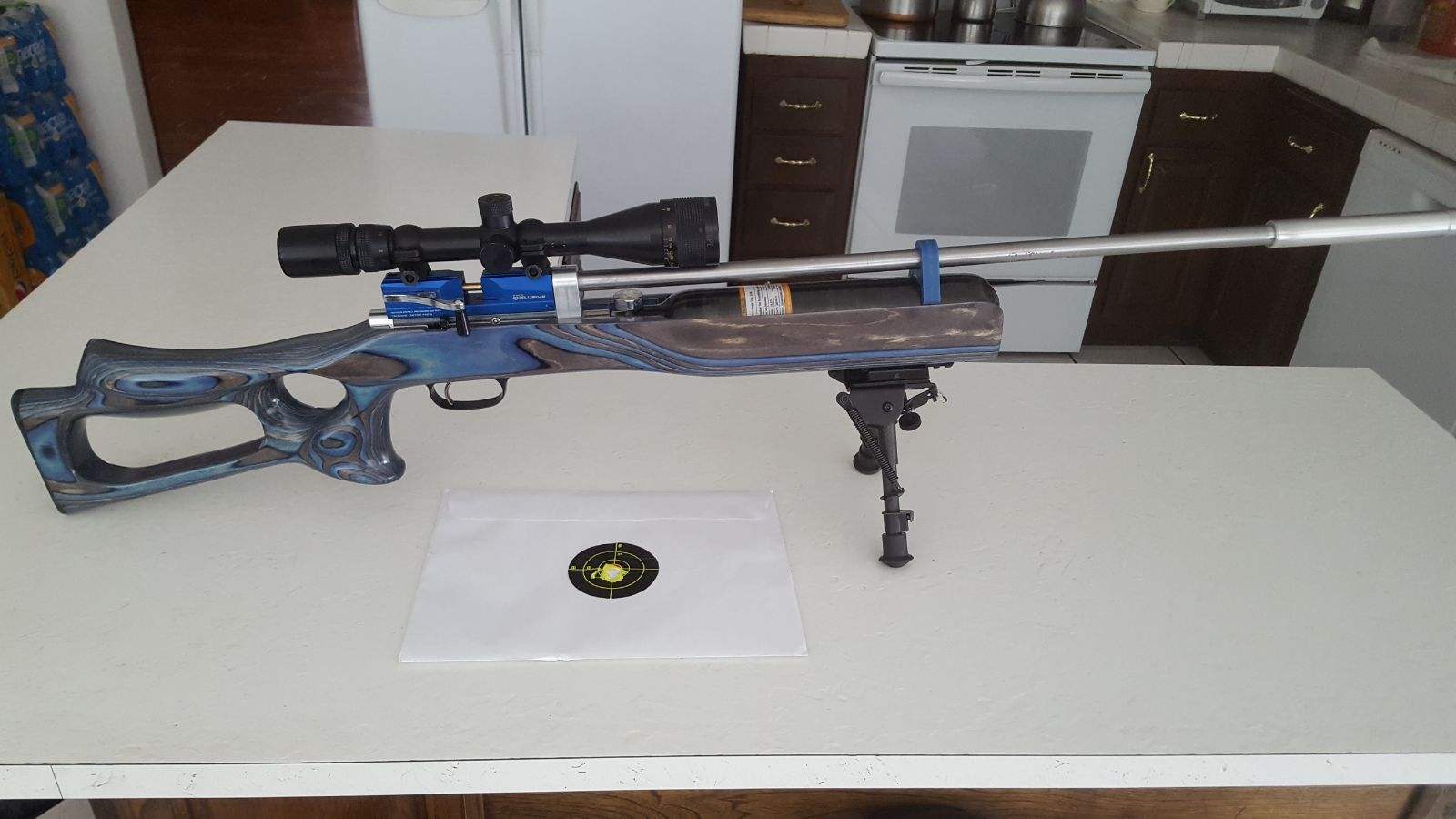

This 2240 I built together with my younger brother. He wanted one in .25 cal and laminated stock. Eastern block polygon barrel 24" long. Modified Exclusive breech, Remington trigger, carbon bottle and home made moderator. It's set @45+ fpe currently, .465" center to center 10 shot groups @ 40 yards. It's posted also on Air Rifle Tuning & Tweaking group.

Hi bud
Hats off to you and your brother.
The blue lam stock is superb and fits like a glove" not to let it overshadow the rest of the engineering work you have put in.
You gotta be grinning from ear to ear looking at your creation.
Polygon barrel is icing on the cake.
its people like you who make my day a whole lot better .

Thanks for the kind words.
Great work! Every time a 2240 mod post comes up someone pops up with 1 that is beyond the norm. You sir, win this round!
