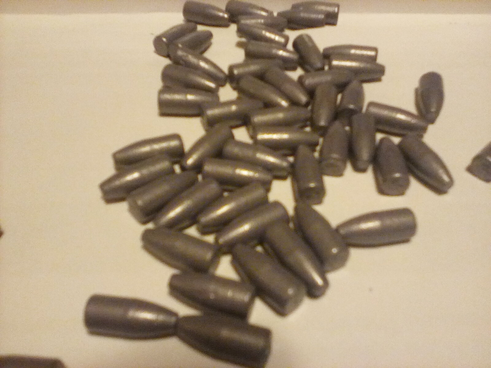

Arsenal molds Powder Coat 45 grain mold. In .223 diameter . I cast and powder coated 8 lbs today... So cost $8.00 ...I'm not paying $20.00 a 100 for 22 slugs.......I have more time than money......
😲 Great looking bullets .. my casting ability still not that good ...😔😁🤣😂
Reactions: RM.510bigbore
Don't worry I cast more slugs then i.can shoot.. As long as USPS is shipping they will come your way. For now only green sliver and purple slugs...Making 300 lbs of .510 slugs give me a lol experience😀...I ruined a good NOE hollow pointing .512 mold when I started... Failures can be the best teacher😀...I also failed at powder coating in bulk until I found my method.. All in all the small .223 slugs are way easier to cast than the .510 650 grain slugs....I have to run 2 Lee 420 pots.to keep.up with..one one PID controller and the other with manual thermostat. I switch to PID controller whatever Pot I'm casting with...20 lbs of lead.nothing for .510....I hope to get accuracy with case .222 slugs ..fingers crossed

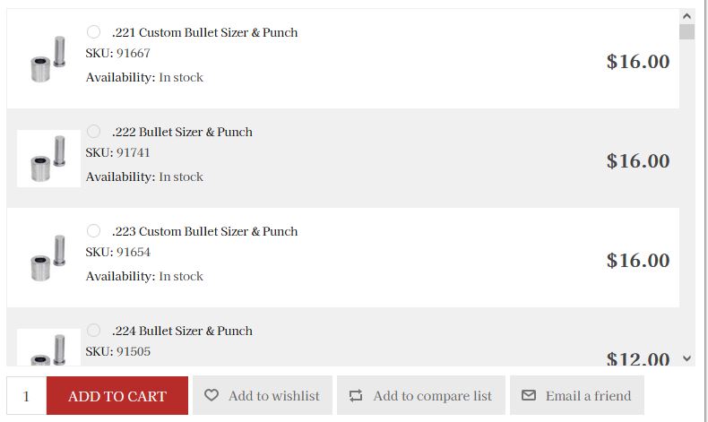

This is the mold you've been looking for:
Get a .222 sizer and you should be in business.
