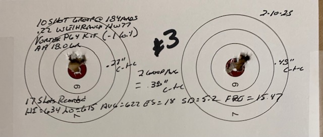

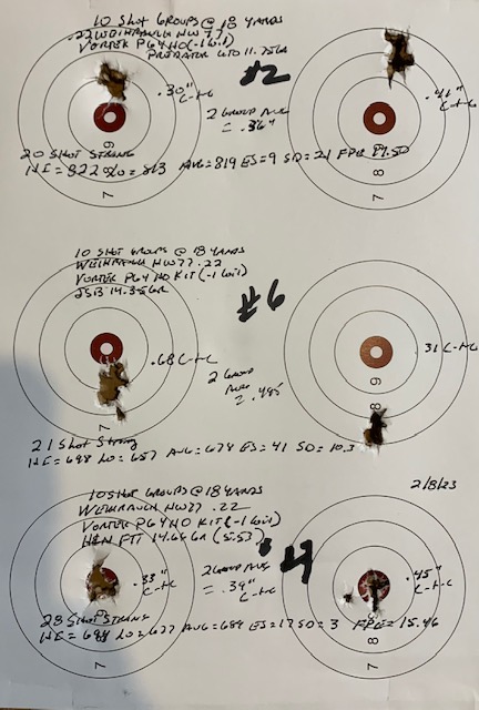

This is the third and final post related to this rifle project. I completed the testing of seven different pellets today for best match to this rifle. As previously posted, this rifle was tuned using a Vortek PG4-steel HO kit with 1 coil removed, hoping to end up at +/- 15 FPE of energy and shooting groups of +/- 3/8" C-t-C at 18 yards.
The results can be found in total on the targets below. The best performing pellet ended up being the JSB Hades 15.89 Gr, though there really wasn't a bad performer in the group.
Thanks for reviewing.
