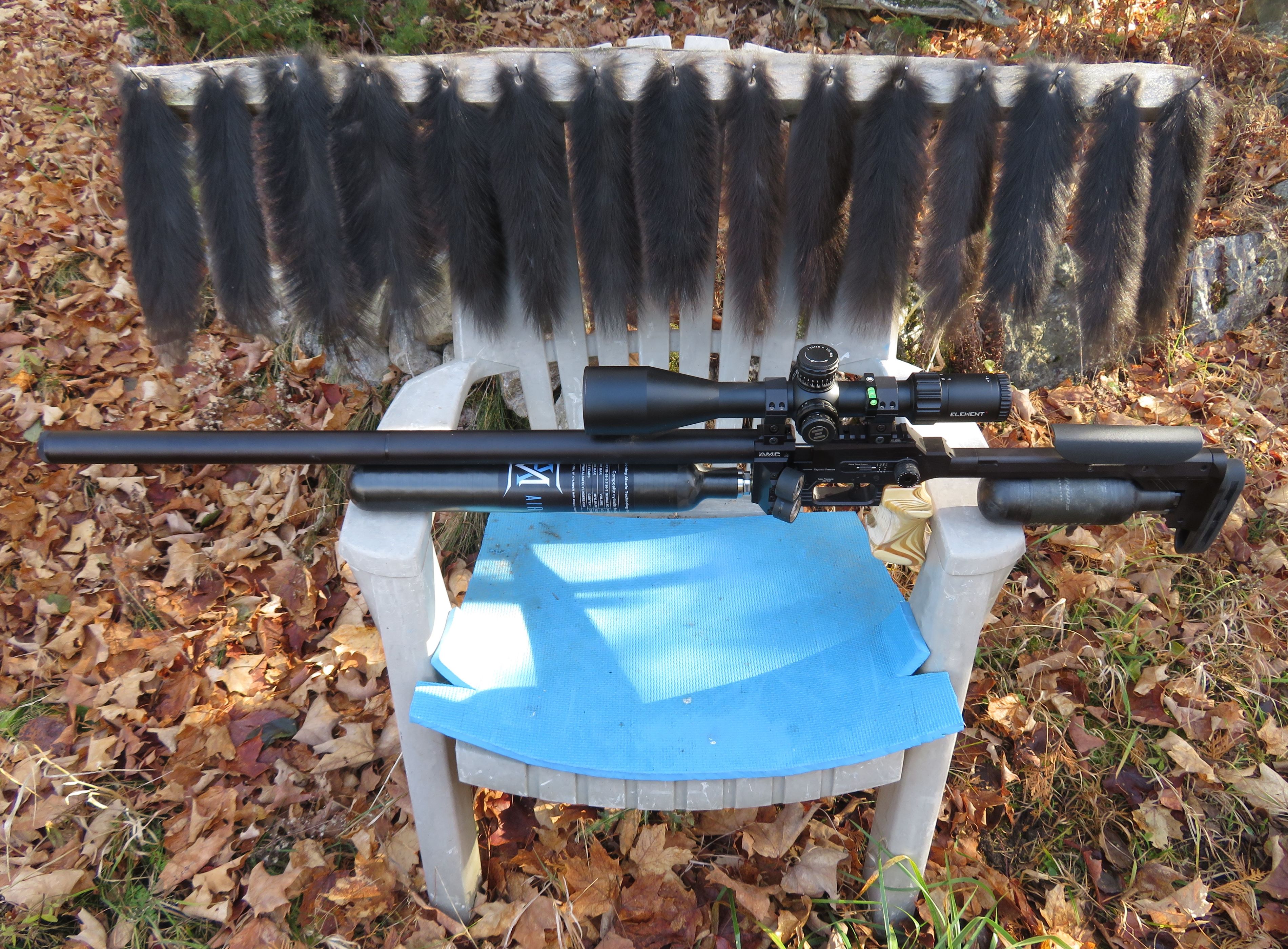

As a side bar, I did hunt squirrels with slugs and my Panthera last fall. The young lads who have permission to hunt on my property had the squirrels spooked to the point that you couldn't get within 60 yards of them. I setup a chair and rest in the hardwood bush and took 18 squirrels that season - all head-shots, all on the ground with a safe backstop - at between 60 and 80 yards.
