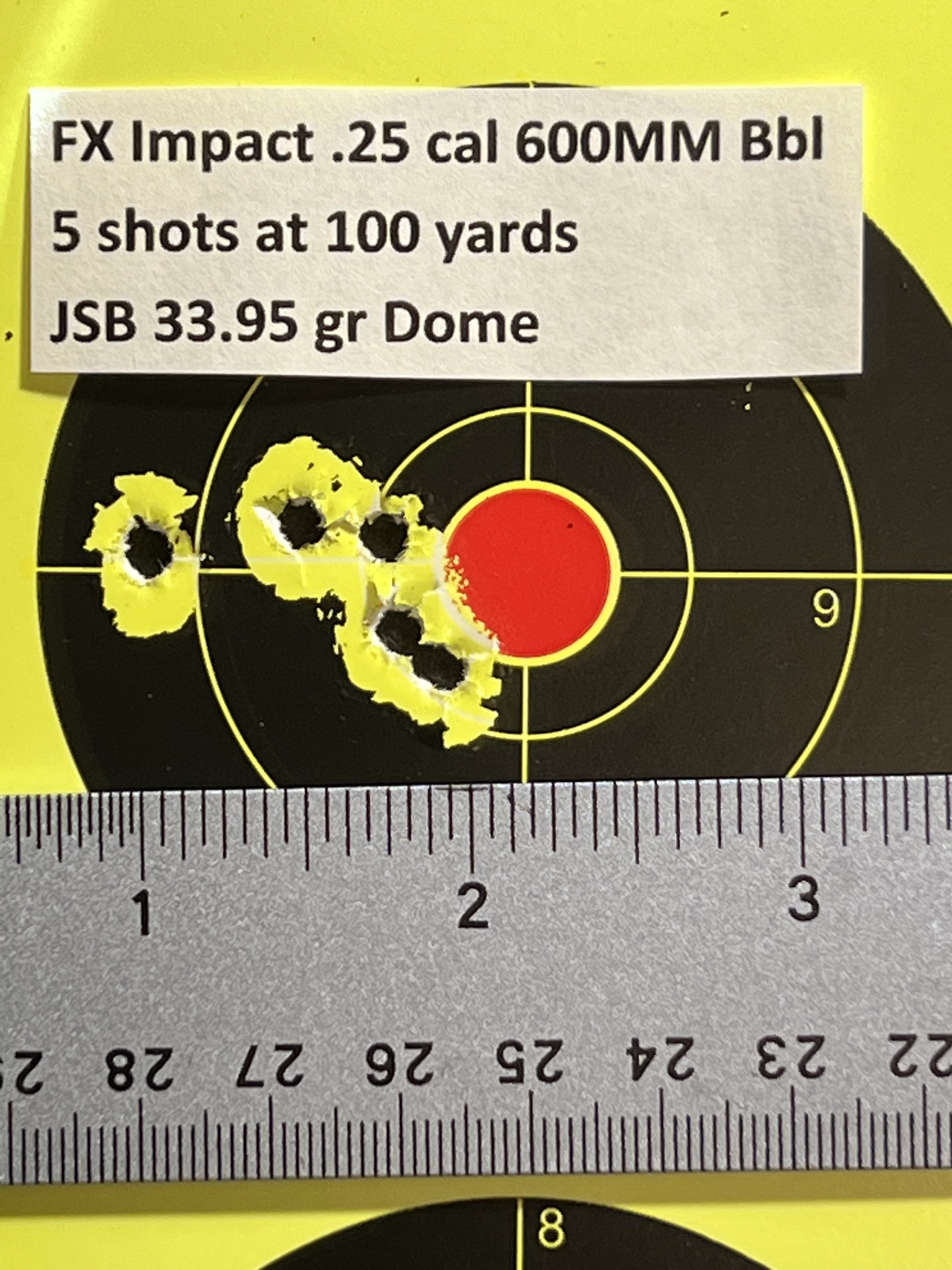

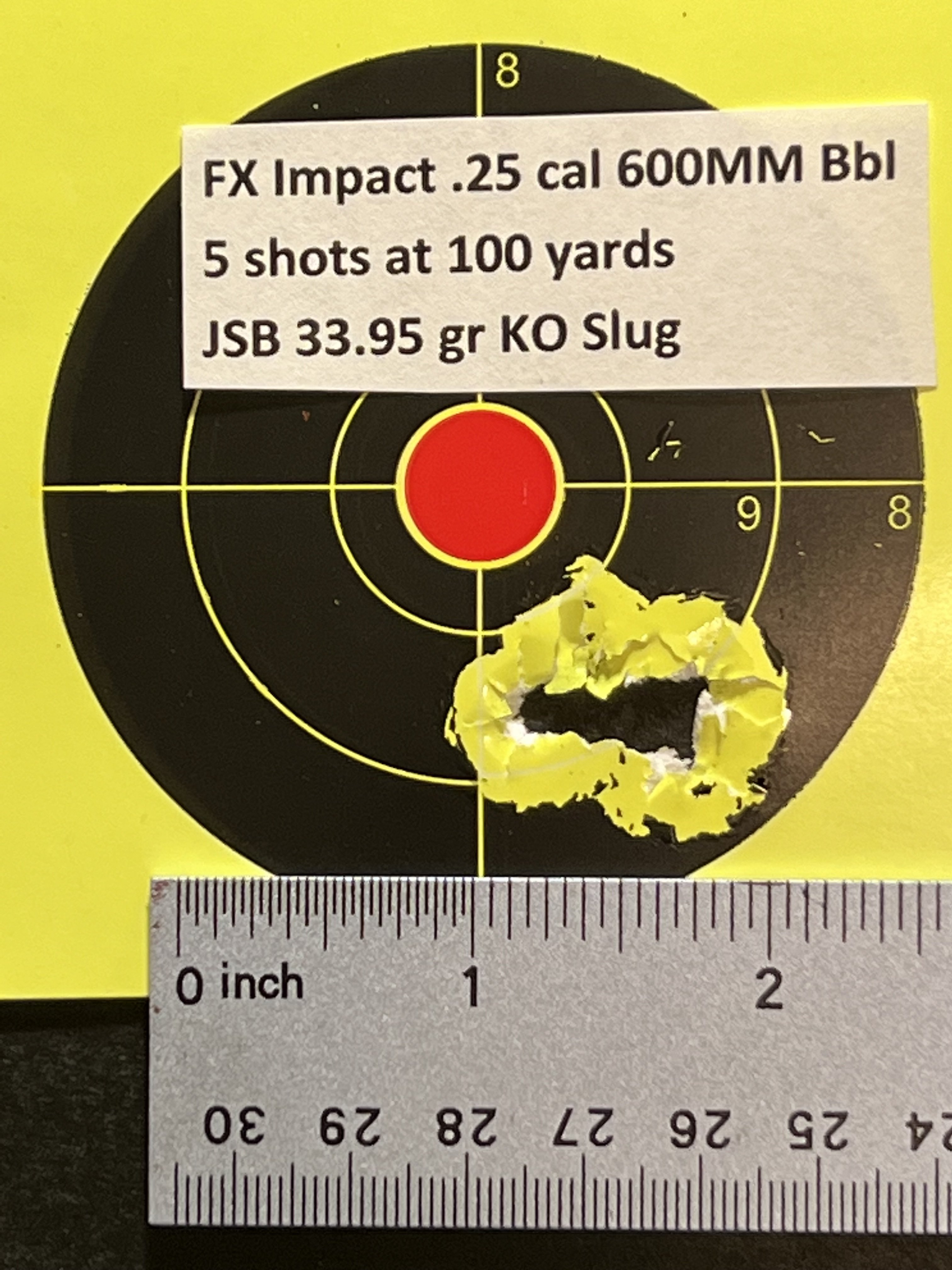

P.S.-I just re-tuned my Impact MK2 with a 600 mm barrel with Superior liner. Reg is 110 and it shoots 920 fps with JSB 33.95 gr KO slugs. So far, I'm very encouraged with it and plan to shoot in a 100 yard match next week.
