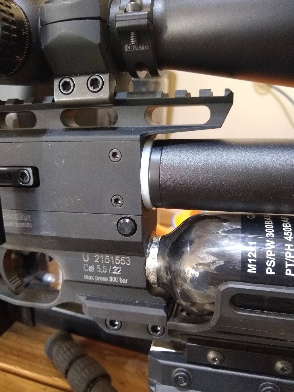

The only way I was able to enjoy my uragans the way i speak of them .. was tensioning the barrels .. hear this , if not I would have sold them as fast I took the first few shots.. for me it was that bad.. so nop is not your hold .. is the barrel dancing around.. I already made a post about it .. even my .25 in low power was impossible to see were the dam pellet was going .. the .30 way worst .. barrels tensioned night n day difference now I would not trade them for anything..
I tried to post a picture but it doesn't work.. between the barrel shroud and the block is a space cut a spacer 1/16 longer than the space available it varies between rifles but not by much..spacer mus be solid n thick like sc 40 pvc pipe... or preferably a solid spacer cut in a lathe or 3d printed.... a word direct from the inside.. said I can't manage to do the same groups with the uragans..like the ones I do with the crickets .. in my other post I showed what was the thickness of the barrels.. cricket barrels are almost as tick as airforce ones..were the uragan barrels are even thinner that 9/16 .. like 14 point Something mm tick.

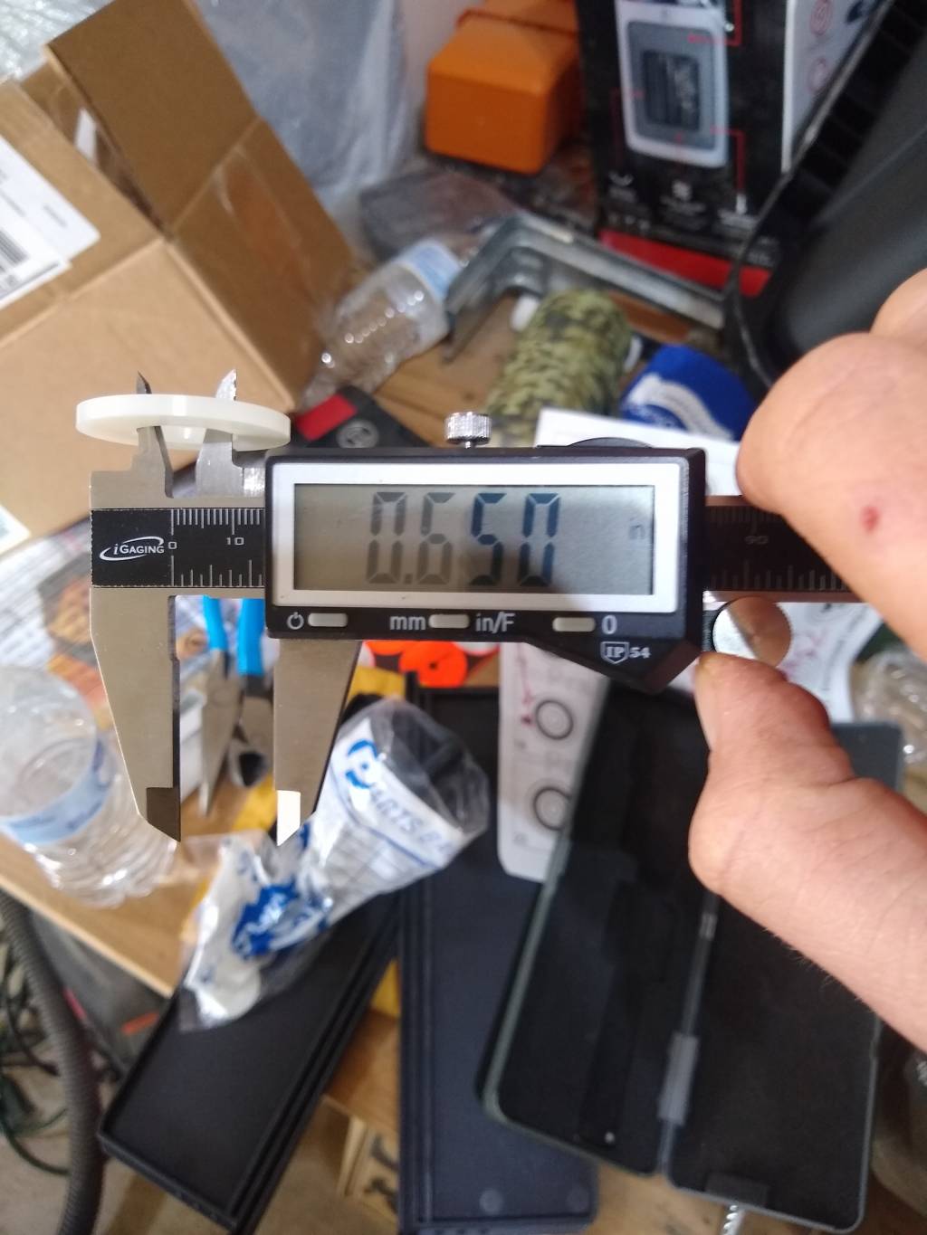

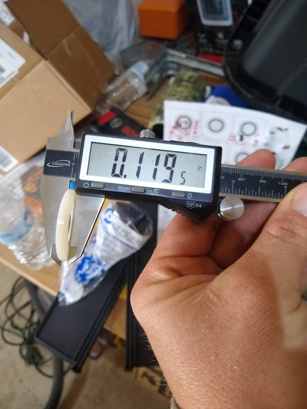

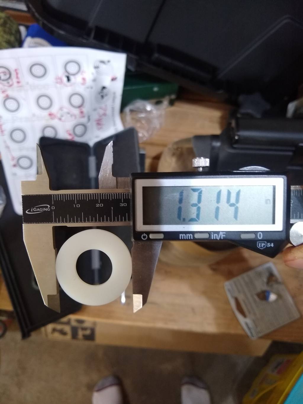

Interesting...I think one can use a washer there. Mine has a gap of 1.29mm which is very thin. Either nylon or a metal washer should work. As you can see I have zero issues on the precision of the rifle. But the slight poi shift at distance can be an issue when pesting. Very simple thing to test though.

Dave, thanks I appreciate it! The part # I got from the bin at Ace is 72873-L. Was in a box of assorted Nylon washers.

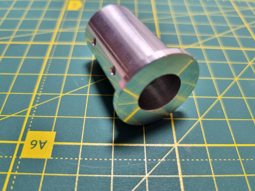

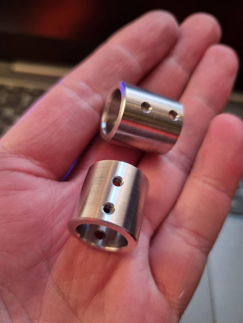

Augie, those look great! Assuming for Impact?

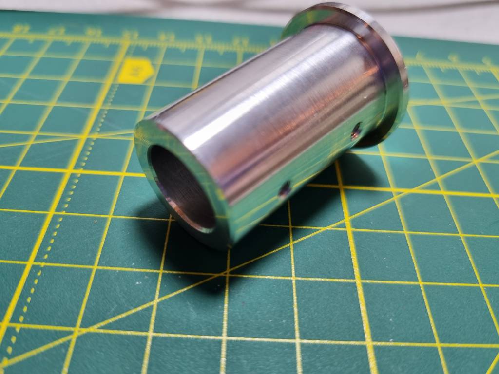

For sure! The flanged one is for a 600mm shroud. When I designed these I took into account to have the shroud in the 600 pushed further forward when compressed down, so the valve knob adjustment outwards wasn’t limited as it came from the factory
So with my testing I found basically no discernable difference with the washer vs not. Not sure what my issue was exactly. I think my parallax was just a hair off on that day. Shot at 52yds today and 4 different mags and poi was the same. Shot 2 groups 3 days ago or so and poi was the same as then.
I don't have the washer on it for now. But that was my personal gun. Others could be different. Mine has no issue with accuracy though. It's a laser.
