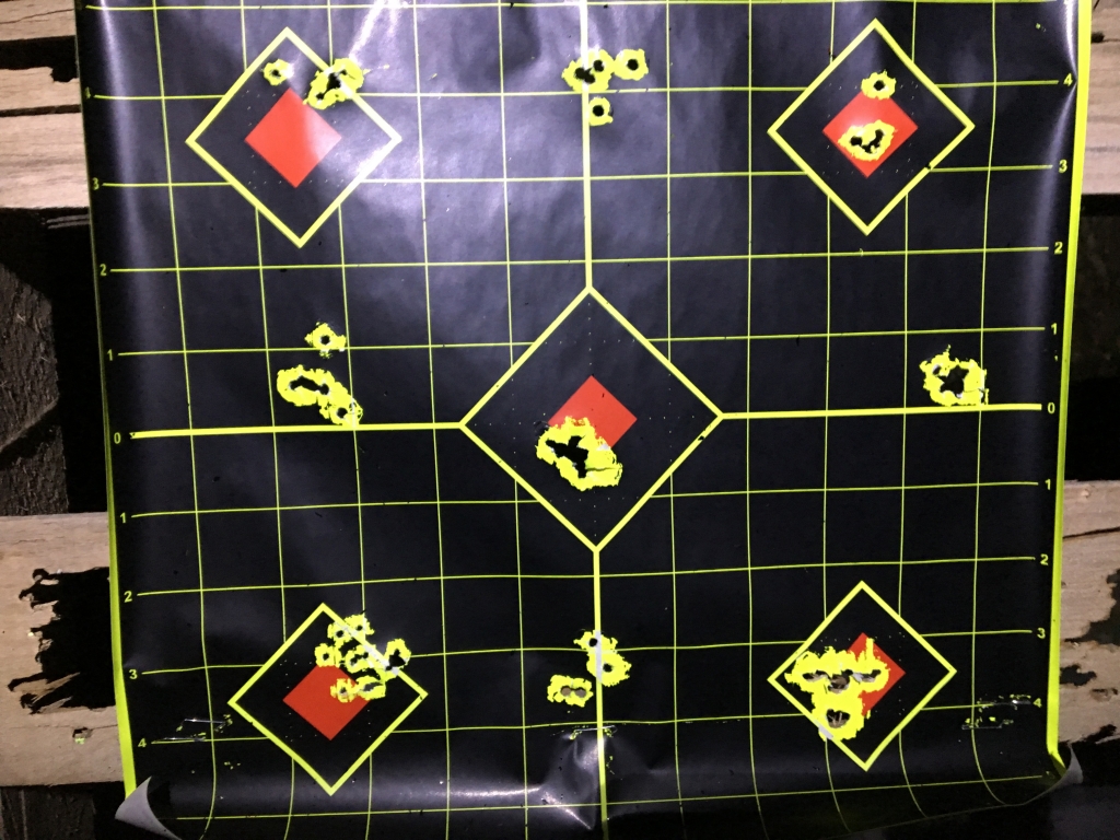

Just for fun: Did some .22 cal accuracy testing @ 50 yards. Edgun R5M tuned to shoot a 22.5 gr slug at 940 fps. This is a LW match barrel, with a choke, 476mm
Groups measured center to center.
Top groups, LEFT to RIGHT:
-VK 22.5gr DB-HP 5 shots: group 3/4 inch (1 flyer...4 into 1/4inch)
-FX hybrids 5 shots : 1/2 inch group.
-NSA 20.2gr DB-HP : 3/4 inch (1 flyer...4 into 3/8 inch)
Middle Groups, LEFT to RIGHT:
-VK 22.5gr DB-HP 5 shots: 1 inch group
-FX Hybrids, 10 shots : 1/2 inch group (2nd best group)
-VK 22.5gr FB-HP 10 shots: 1/4 inch group (best group)
Bottom, right to left:
-VK 22.5 DB-HP 10 shots : 7/8 inch group
-NSA 20.2gr 5 shots: 3/4 inch group
-.25 Polymags 5 shots, out of Leshiy.
