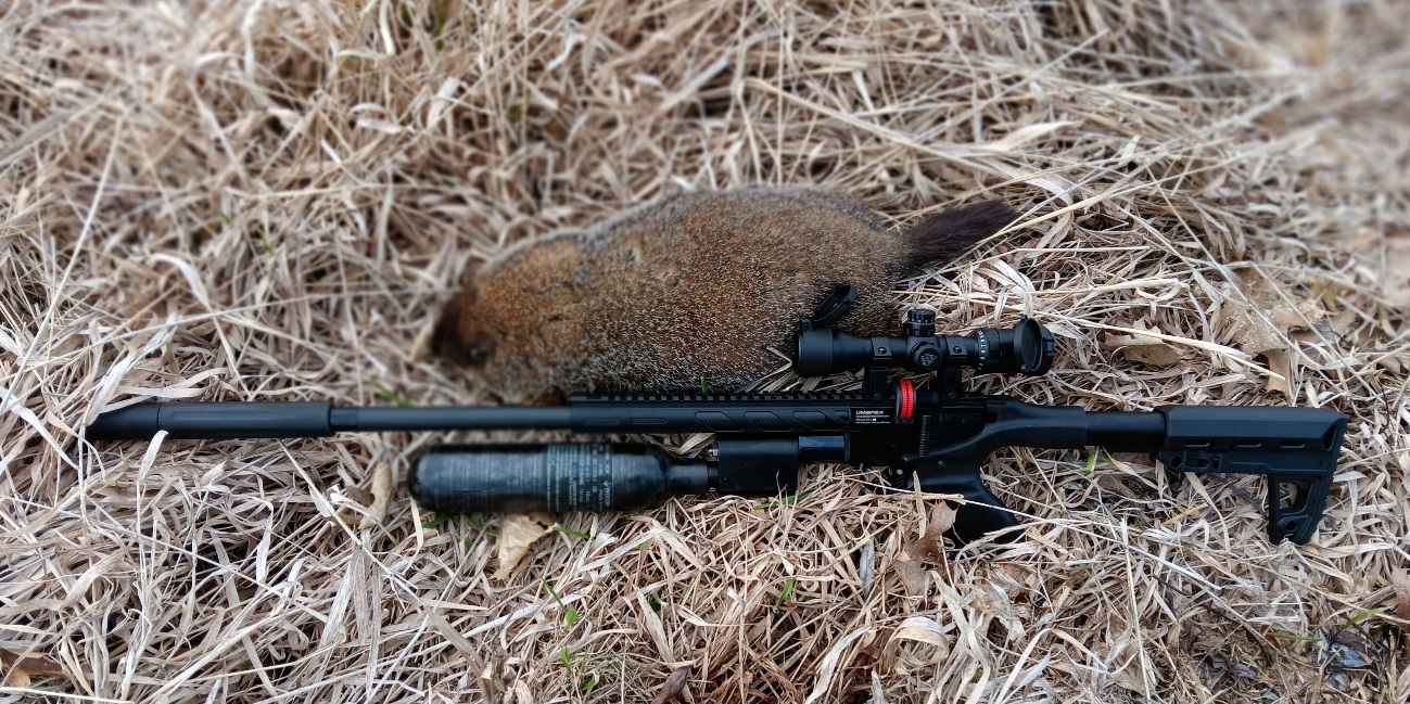

I just tried some JTS 21.5 semi-domes in my AA 500. Shot very well at 50 and killed a woodchuck real dead.
As far as safety, well you need to treat them all the same. The 21 passed through the chuck noggin and rattled through the trees 50 to 100 down range. A 16 would have done the same.
