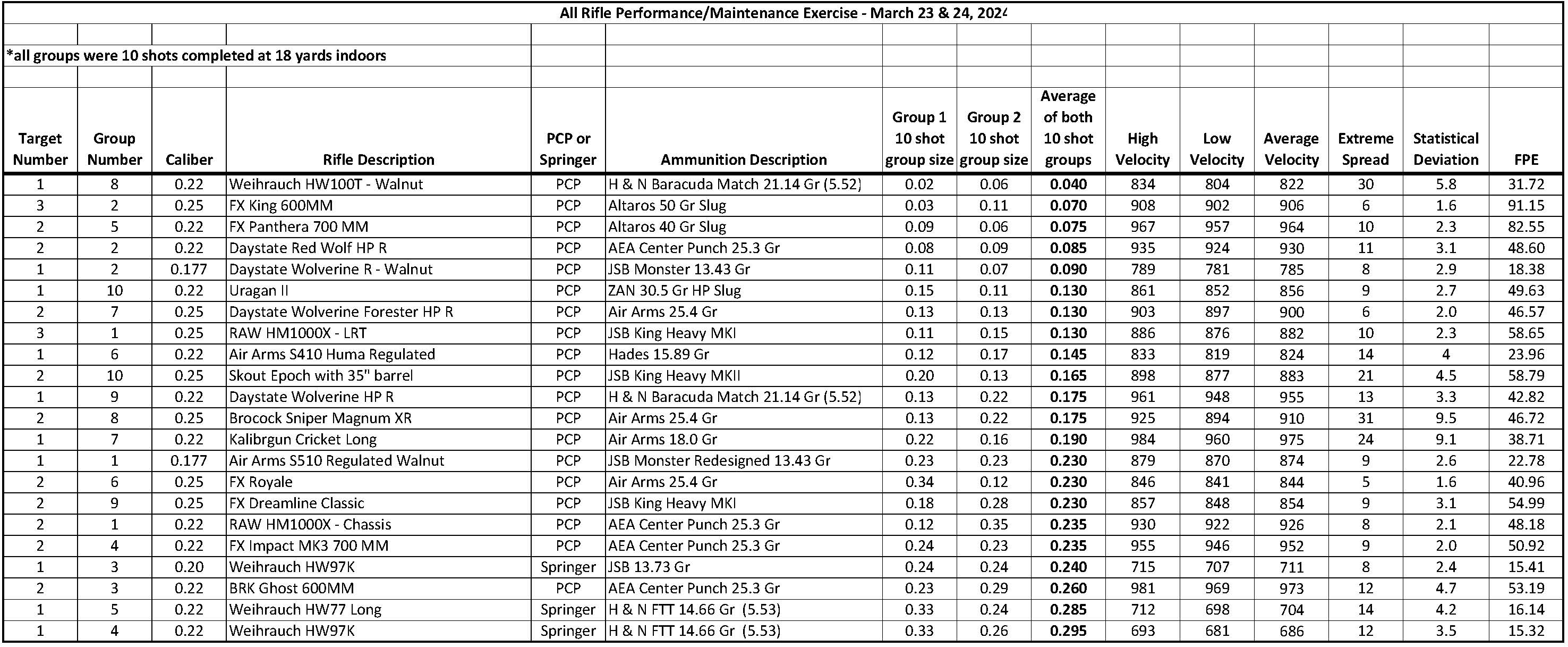

Below you will find a summary performance chart that shows each rifle, the corresponding target and group set, the size of each group (c-t-c), the average of the two groups, and the chronograph specs. Also included are three targets, showing the actual groups shot and the performance stats.

This exercise, completed a couple of times each year, always pays off in finding or learning something that I didn't really know about or expect.
