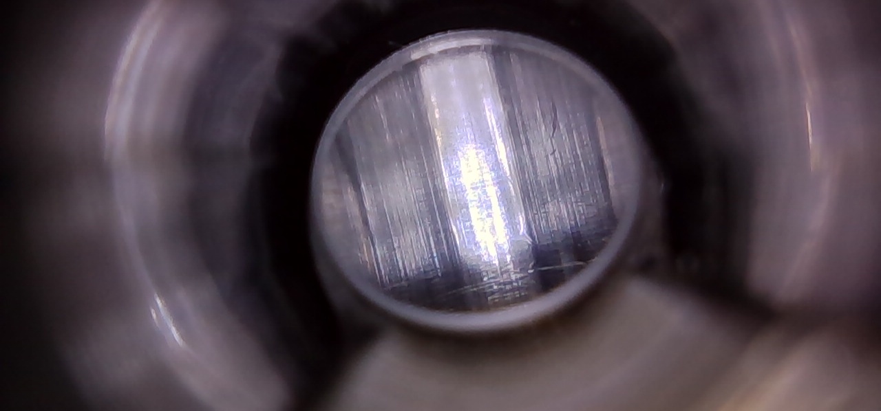

Didn’t clean during this session. No two barrels are the same in their needs. If you are getting flyers…you probably need to clean more often. Some barrels will need cleaning every 10 shots to keep flyers away. Thats not practical during a shooting match….so you would have to be creative.
Look for radial tooling marks in your barrel lead and transfer port, if you have one. Tooling marks collect lead. If you have a factory machined barrel….it was done in a CNC lathe and it’s a near guarantee that the leade or crown is not concentric with the bore. If it is concentric, you hit the lottery.

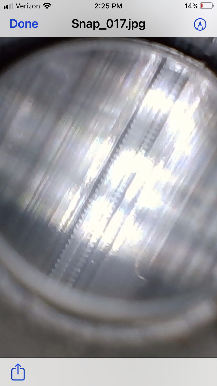

Here is a pic of some tooling marks on one land of a 6 groove barrel. The marks run about 2 inches of the land. This barrel will shoot lights out for 10 shots before throwing an ugly flyer….then it will go back to shooting again. The frequency varies….but it will continue to repeat the process.
