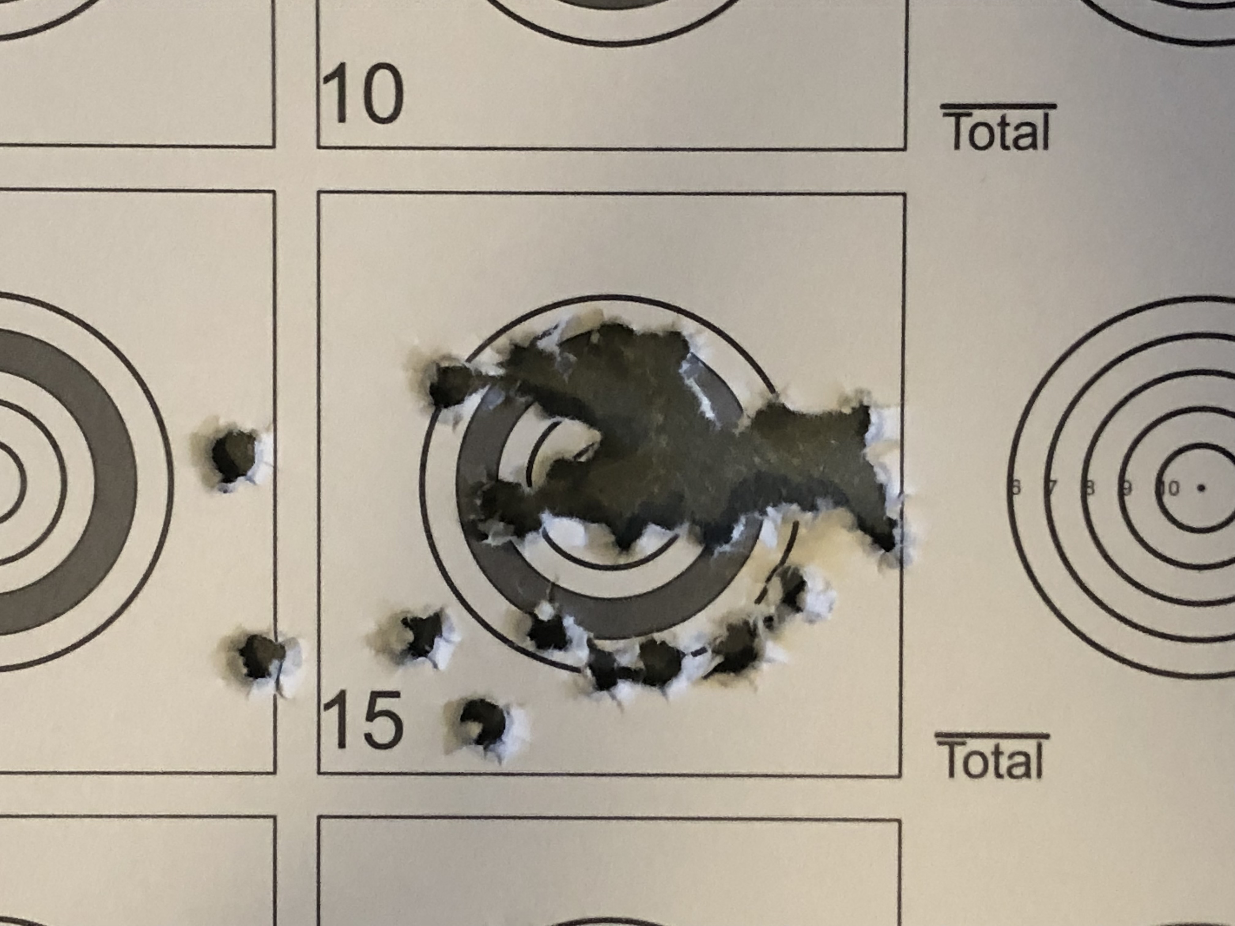

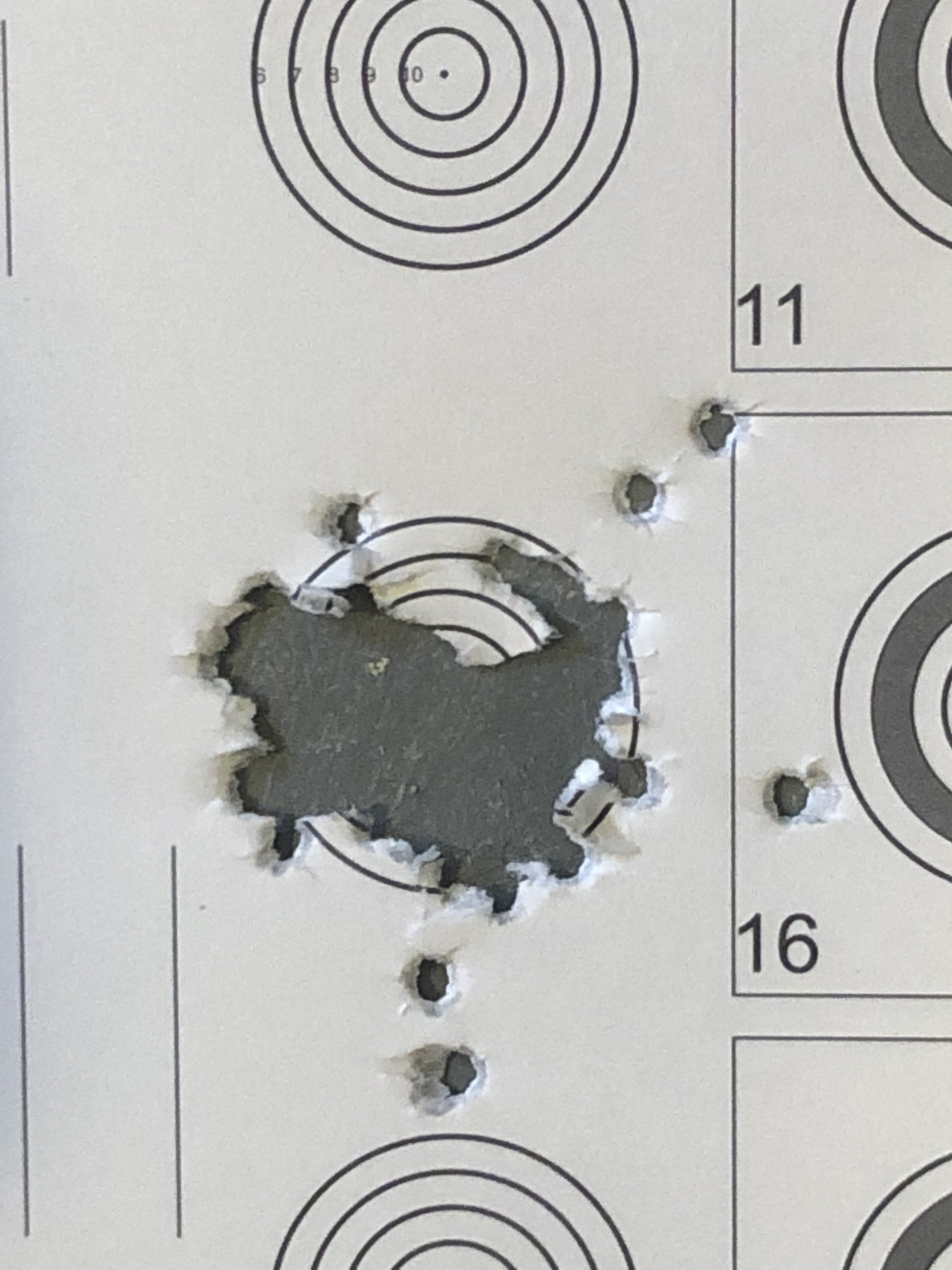

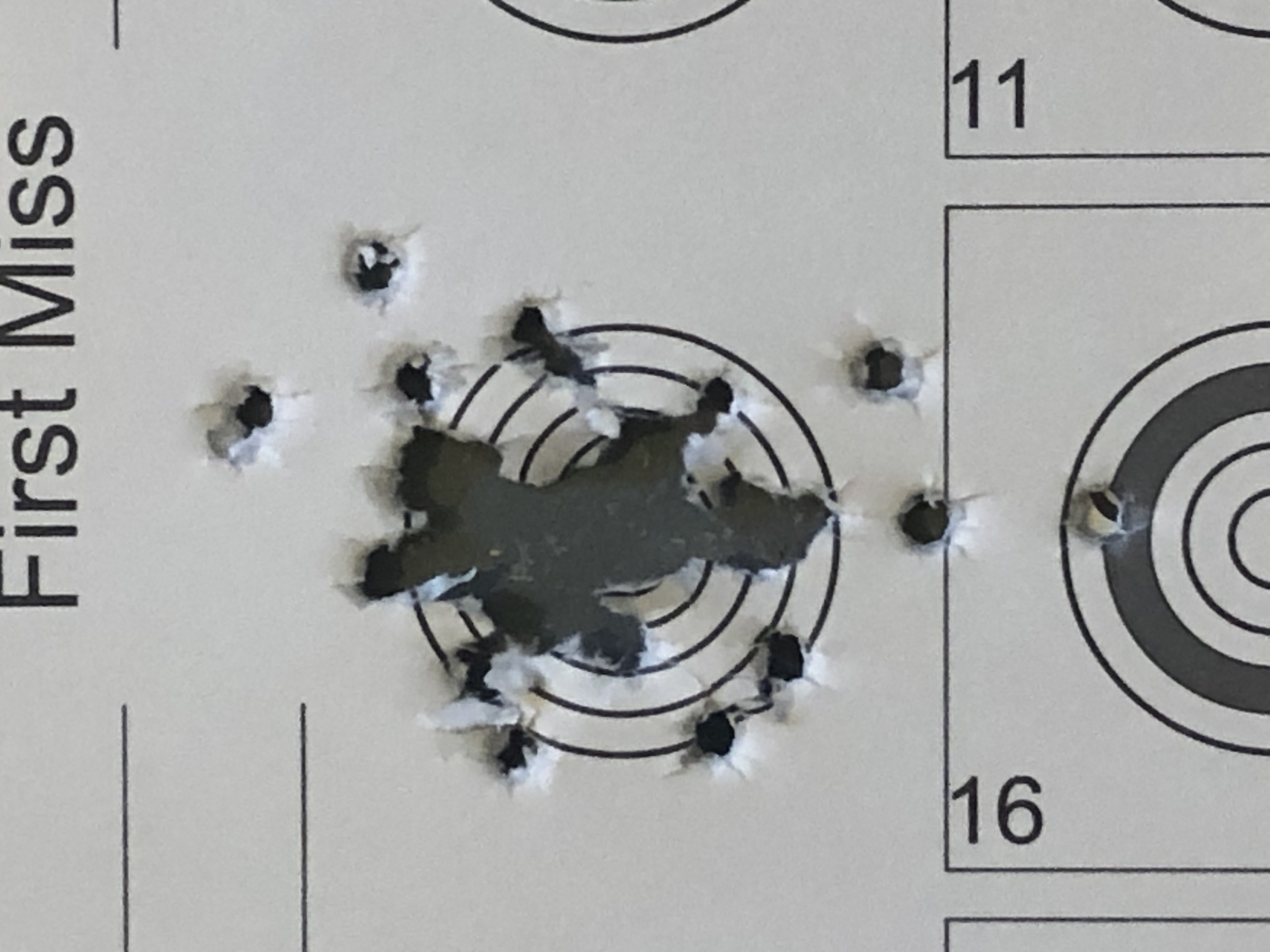

22 RD Monster comparison…..
A 95% barrel builds up lead slowly. As the build up takes place your poi will usually move very slightly each successive shot. ….then the build up releases when it becomes too great and you get your flier. If you are patient enough.. this can be seen with a bore scope down the barrel every shot till you reach a flyer. You have to locate the problem area first. Most barrels have multiple problem locations. Most barrels are less than they could be because of machining.
I don’t get any more flyers at 100 than I do at 50.

I had 5 tins of partial RD Monsters left over from N50 Nationals. I counted them and put them into 1 tin. 133 or 134 in total. I set up and shot this group at 100y using up all the pellets. The wind varied from straight left to right to near straight right to left with tailwinds included. My largest hold was around 3.5 MOA. I took about 5 or 6 sighters to get my elevation….but once I started the group I didn’t take any more. I made my adjustments based on the 3 flags. I would not call any of these shots flyers for a pellet gun at 100y. The furthest shot from center is 1.2 MOA. These pellets were purchased from Pyramyd maybe 3 weeks ago. No sorting and a mixture of 5 different tins.
