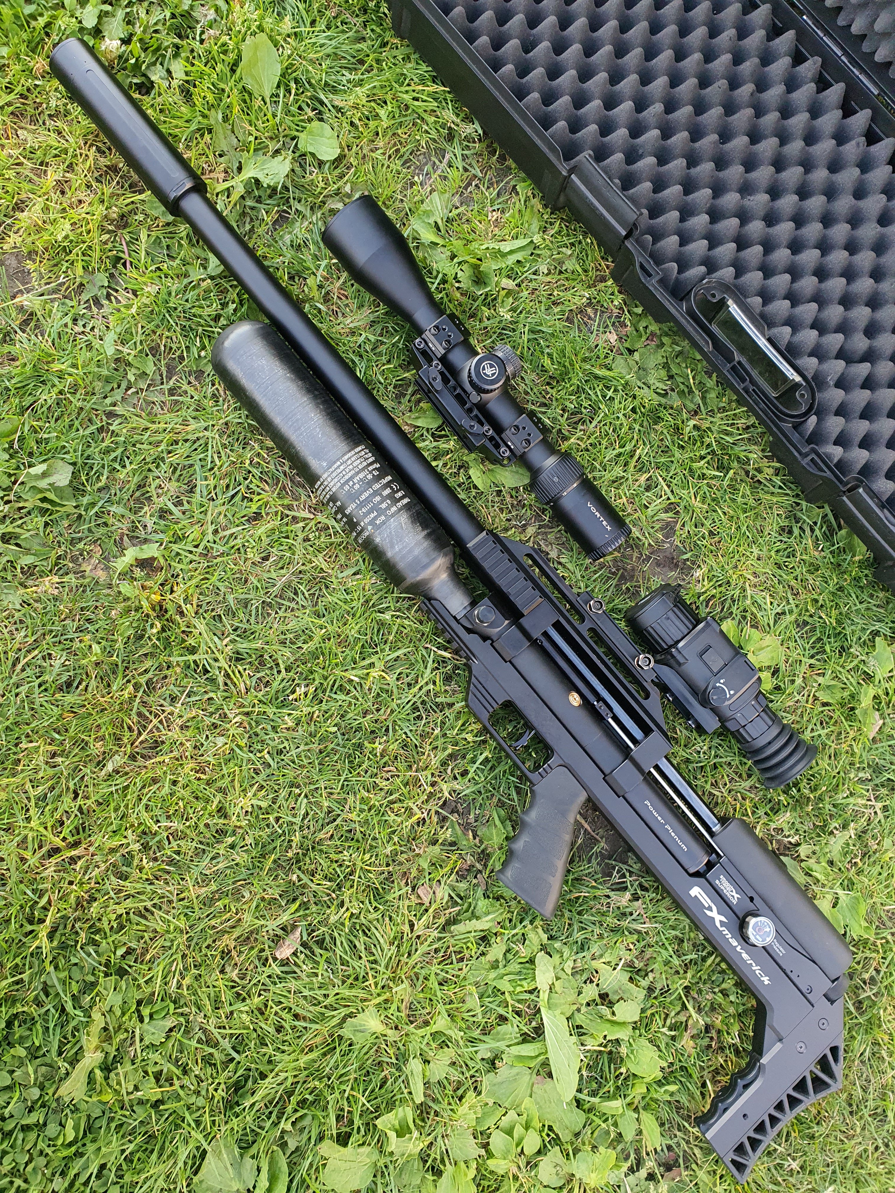

Ok been watching guys from Africa and they claim their. 22 impact is easily shooting over 80 ft lb. They also said the .25 can shoot over 95 ft lb. How the heck are they doing this? I have a mk2 with PP and bought huma high power reg, and huma dual port, and fx slug power kit pin probe. I set reg to 150 bar. Shooting 33.5gr (.25 cal) nsa slug. My hammer wheel is set to max. Valve adjustment is fully open. I'm pushing the 33.5gr nsa max up to 980 fps. I calculate that in PA calculator and it only give me about 71 ft lb. So how the heck am my .25 cal max out to only 71 ft lb, and they claim their .22 is easily over 80 ft lb. Isnt .25 suppose to be more powerful than a .22 cal? I'm not even close to that 95 ft lb they claim the .25 can do. What am I doing wrong here????

I have a fx maverick sniper .25 cal
Reg pressure 1e reg 200 bar reg pressure 2e reg 175 bar.
I have made myself a tungsten hammer and i have instal a slug liner and a slug powerkit.
It does now with a 38.5 grain NSA slug 96 ft/lbs and with a 44 grain ZAN slug 107 ft/lbs
By the way the tungsten hammer was my last attempt to increase power but it didnt chance anything, i am stil thinking how to get more power out of it but i dont know yet how to do.
Kind reagards Johan

I believe they are shooting .22 34gr slugs at about 1050fps.
As for .25 cal? Not sure because they can't have that Caliber in SA. Might be just a calculation?

Just a slight correction, they can have a .25 cal in South Africa. They can have any caliber they want up to 50BMG and bigger… But all powder burners and any air rifle over .22 needs a firearms licence. Air rifles of .22 or smaller do not require a firearms licence in SA, which makes them A LOT easier to work with, which is why they focus more on the .22’s.
