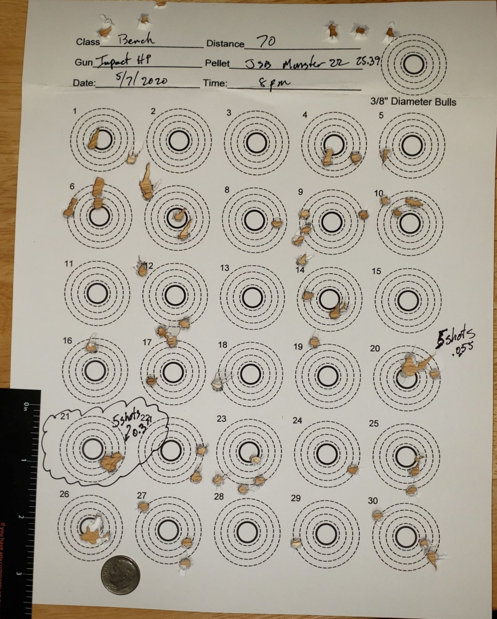

I am seeing that the 22 Monster ReDesigns seem to be much more sensitive to velocity changes - that is if the velocity changes by 5fps, the POI will change. That could explain the flyers with different weights/head sizes.
This is the first time I’ve ever heard of that, and no disrespect intended, but that would defy the laws of physics if it changed more or less than any other pellet at the same speeds...
I believe that what I was seeing was a problem with either the gun or the pellet shooting off-speeds, with that problem resulting in an accuracy issue. The speed was just a telltale sign that I attributed incorrectly. So, no physics laws harmed in the name of pseudo-science.
