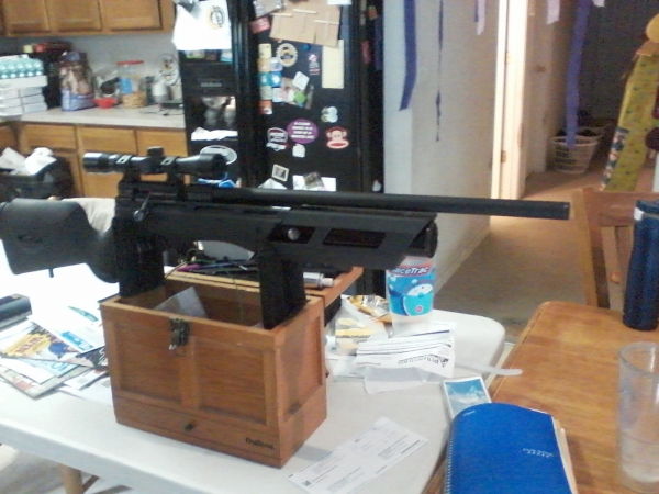

Only 4 modifications to the gun in just under a weeks time of owning this new gun and never have worked on this platform. I hate to buy aftermarket parts and would rather just do it myself. So, this is what I did,
1) Upped reg pressure to 1300psi
2) Removed .01" off poppet head
3) Opened throat to .221"
4 Shortened hammer spring .015"/.02"
3000psi to start with both runs and both runs were with 14.3 CHP's
100 shots using 14.3's at 21.5 fpe at a respectable 2.2 ES then opening that up coming off regulation to 860 fps for 23.5fpe, down to 802 fps for an additional 20 shots.
then
3000psi start and 1300psi end ( falling off reg )

Not too bad and I am starting to really like this Gauntlet. I would really like to shorten the barrel and turn it into a small light weight carbine.
