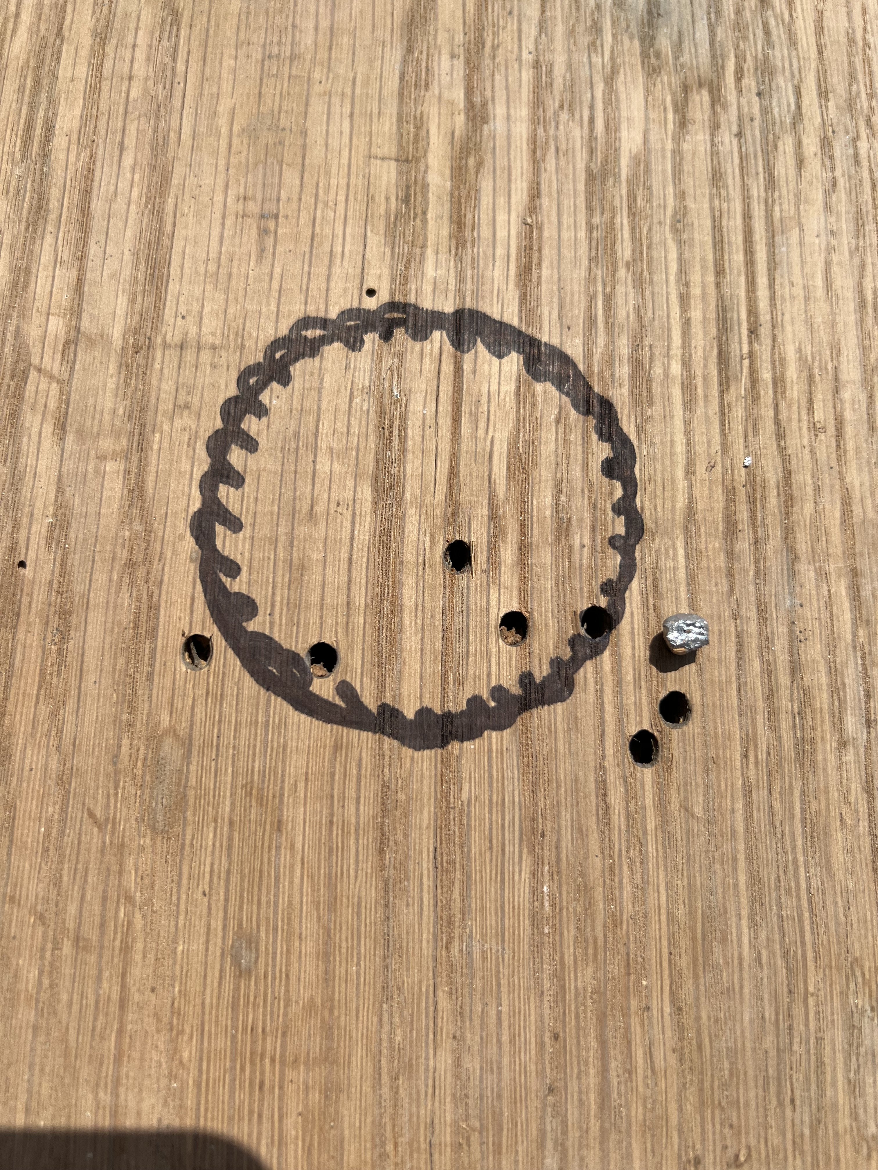

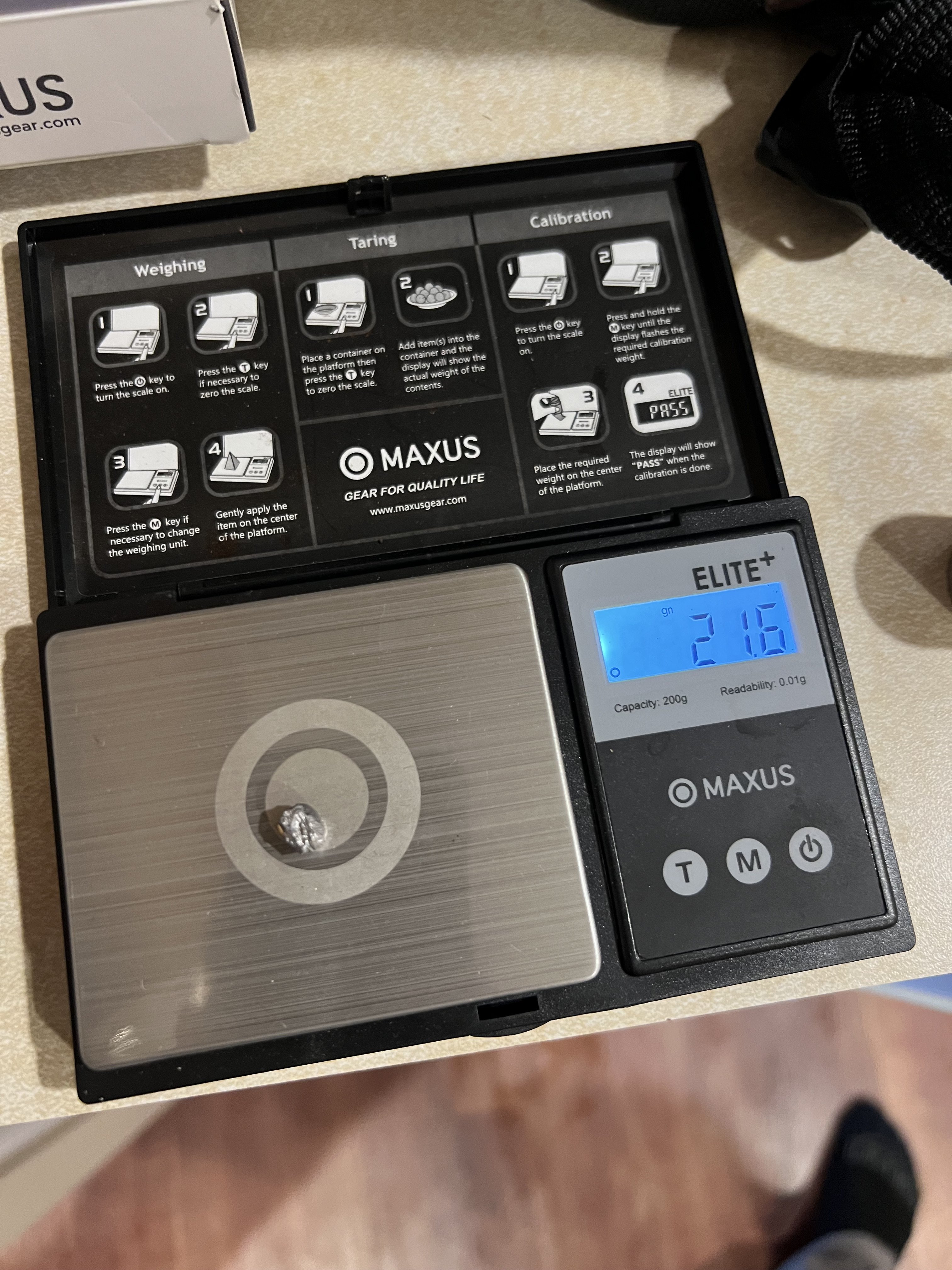

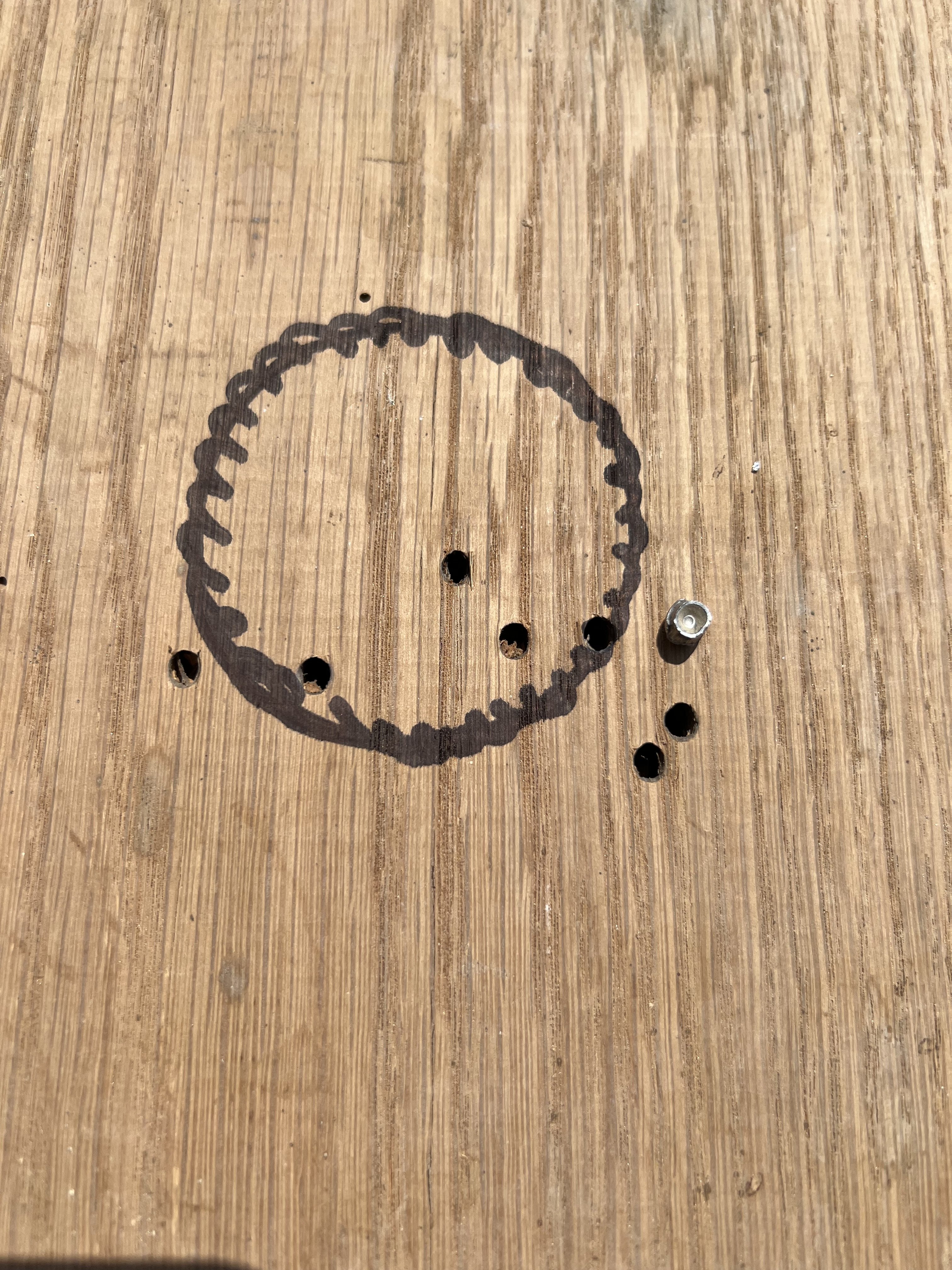

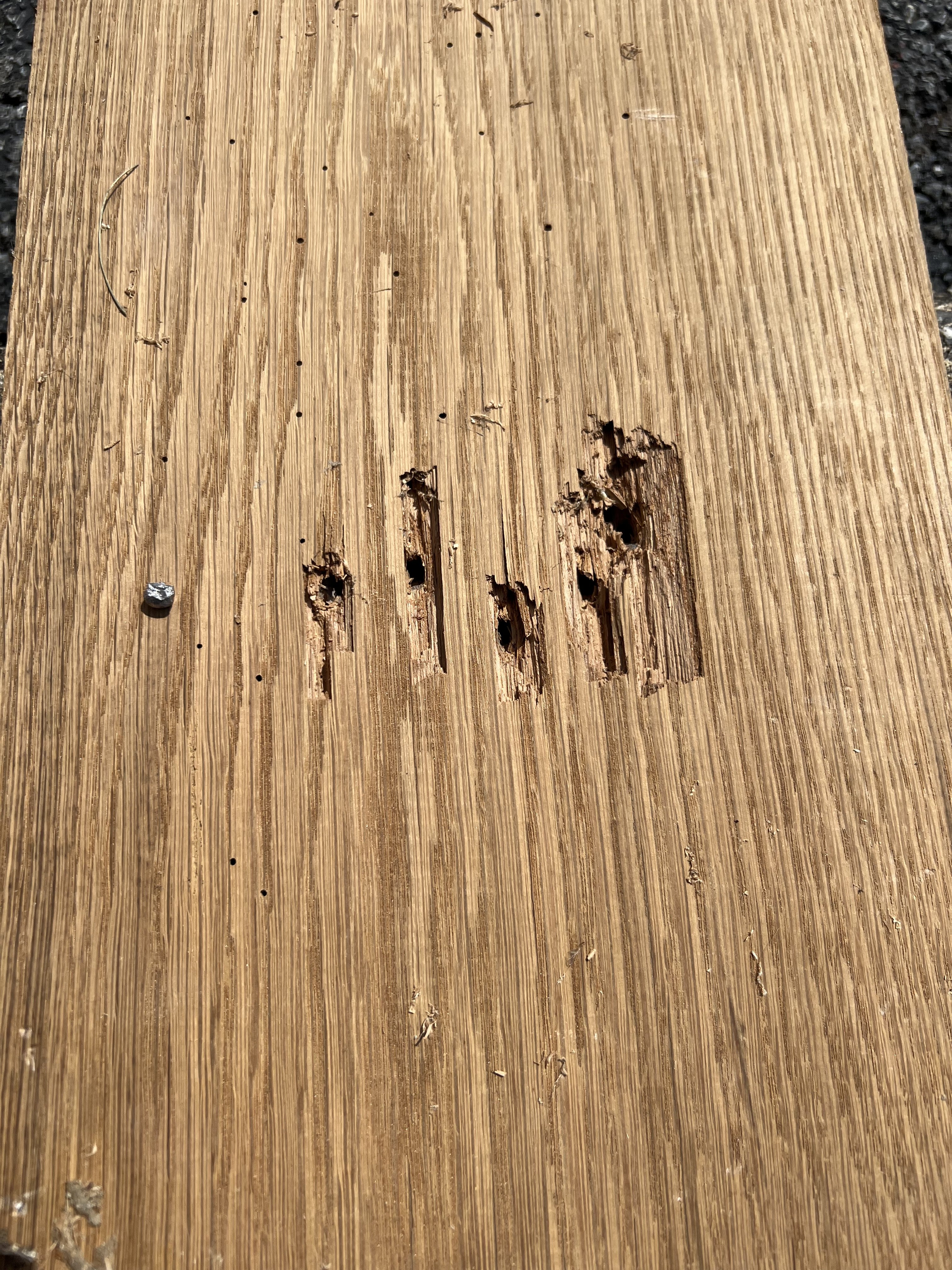

I put some .22 FX Hybrid's at 985 fps downrange to 80 meters to test there penetration. I was pleasantly surprised. All 7 fully penetrated a 3/4" oak board except one which was protruding through the far side. I'd say it's good for up to a coyote skull at 100+ meters. Good expansion and weight retention I would say!
By trying to prove to myself that they won't do well in penetration/mass retention I actually proved the opposite.
