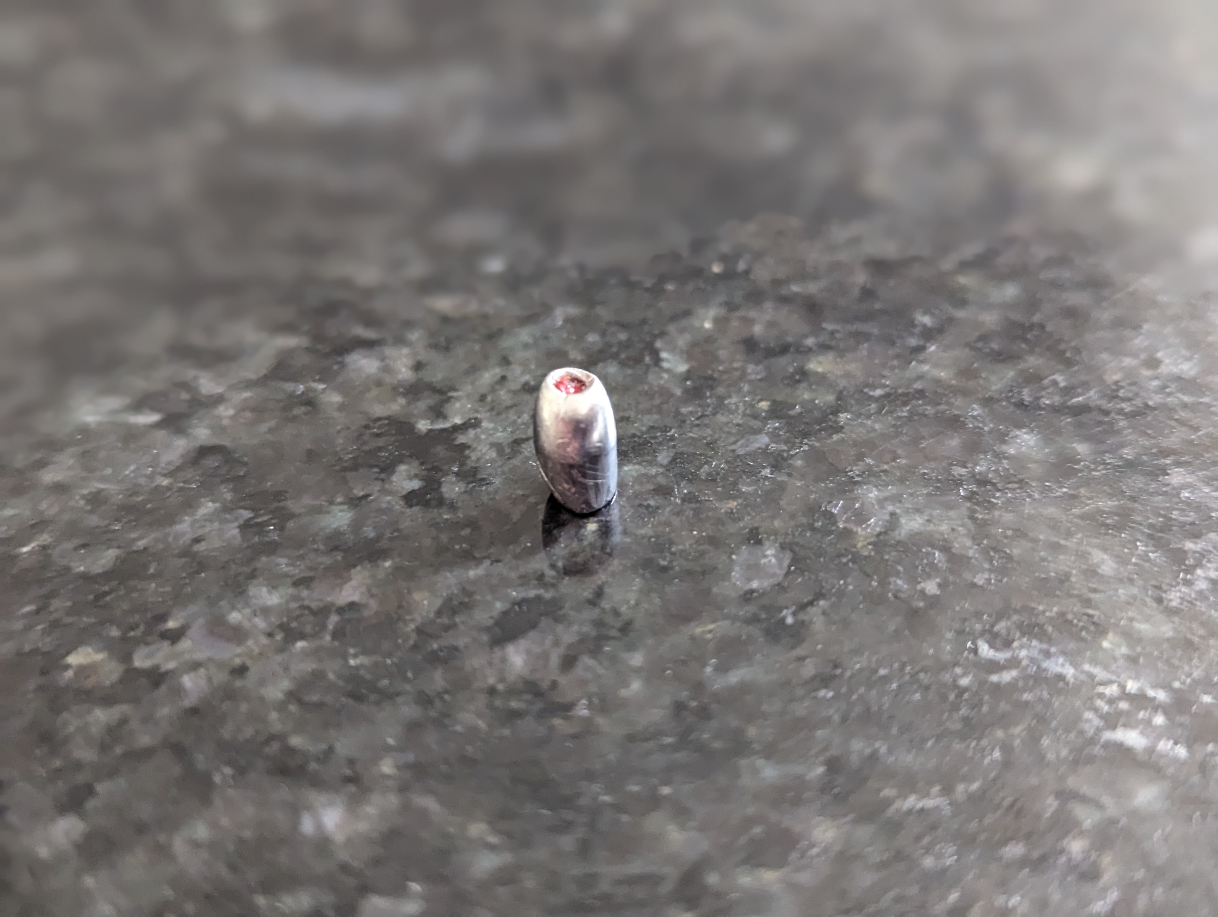

On another note, I have certainly felt like the .22 Hybrid's expand wonderfully on almost everything I've hit with them, which has been mostly birds. I definitely feel like they expand better at faster speeds(950-1000 fps) vs slower speeds(900-950 fps). They just transfer a bit more energy when pushed a bit faster in my experience. YMMV

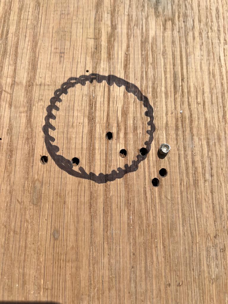

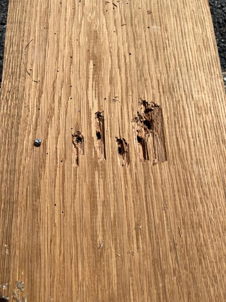

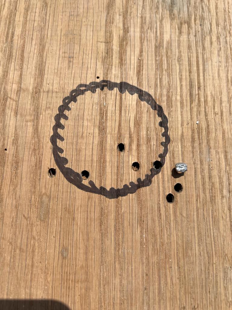

Recently, I shot a few rounds at 80 meters in some stiff wind to get an idea of what my windage hold should be...the target is a 3/4" solid oak board and only one of the 6 shots didn't fully penetrate although it was protruding from the far side. In trying to prove to myself that they wouldn't penetrate well and retain mass well I actually proved otherwise.
