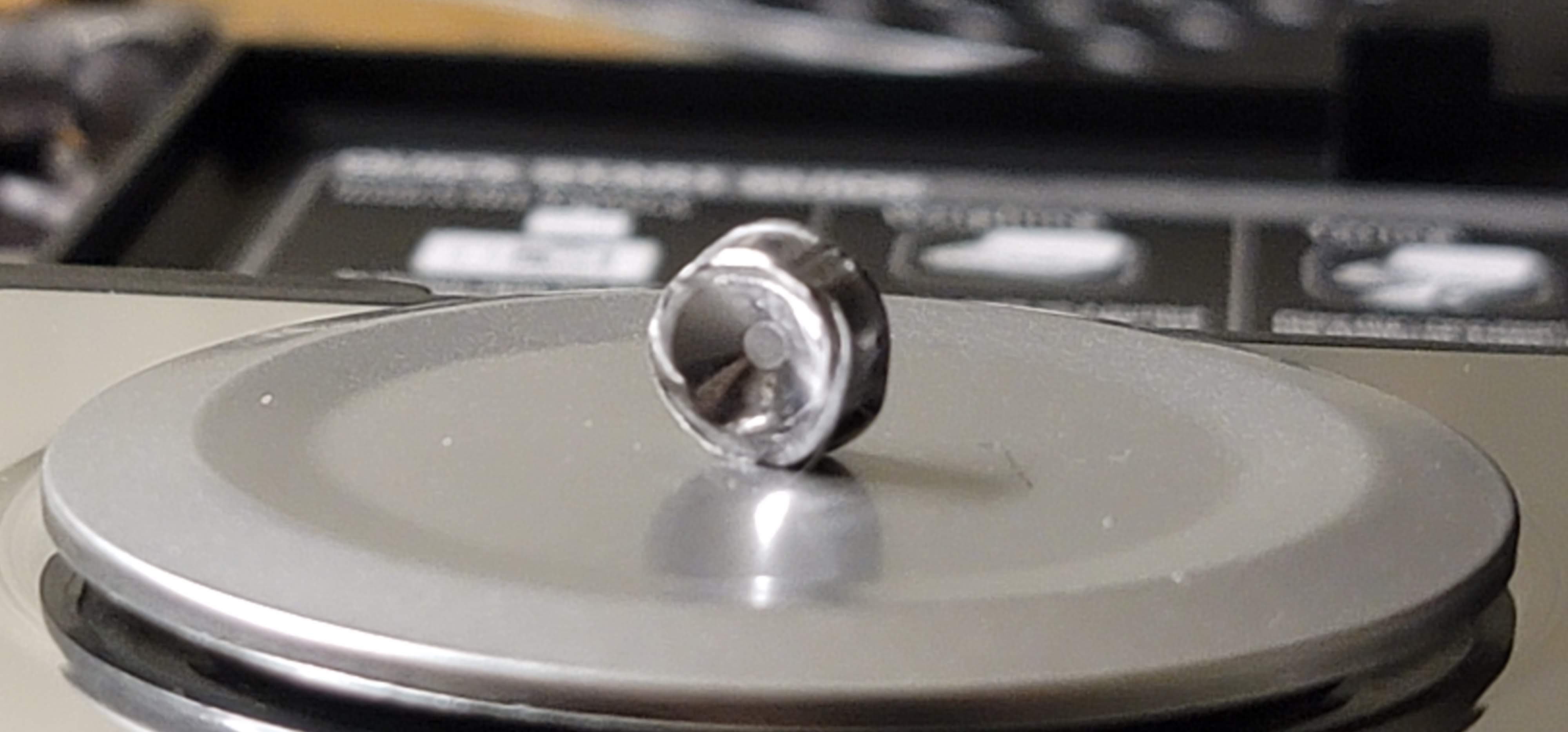

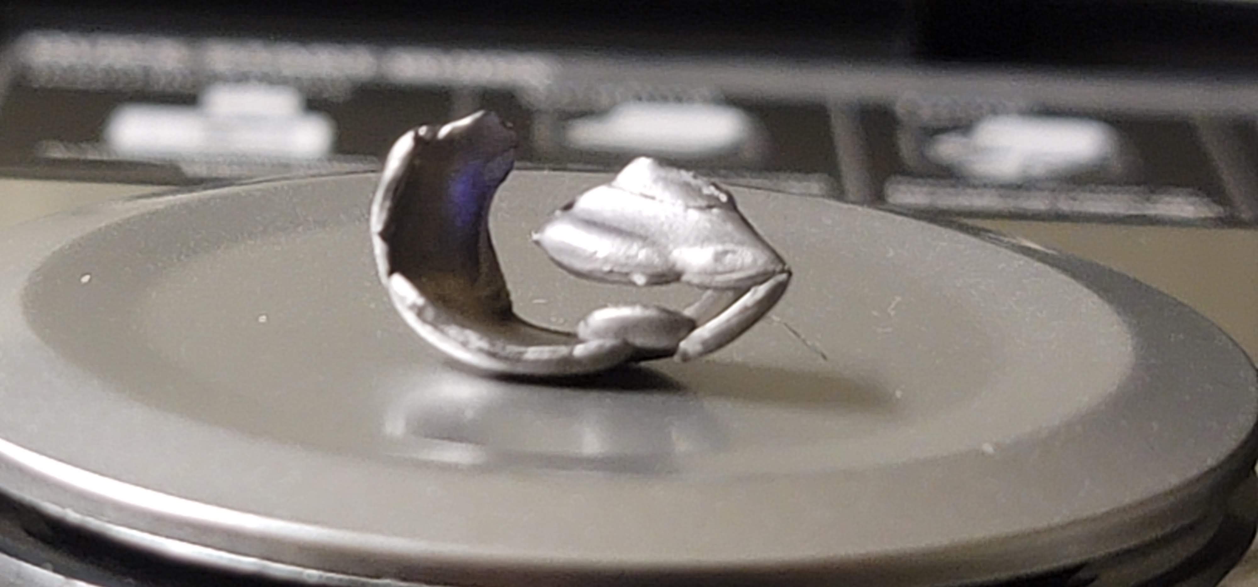

The .30 cal Hybrids expand very well. Expand any more than this and
You can watch a video of that shot here
Impressive. I wonder what the difference is, as even gel testing has shown the 25/30 Cal Hybrids wont expand. Buddy has shot more than a few critters with his, and so far we have only seen pass throughs with no signs of expansion. Maybe velocity is having an adverse affect. Its pretty rare, but sometimes slower is better for expansion.
That slug I showed was after a full passthrough. The velocity was 930fps.

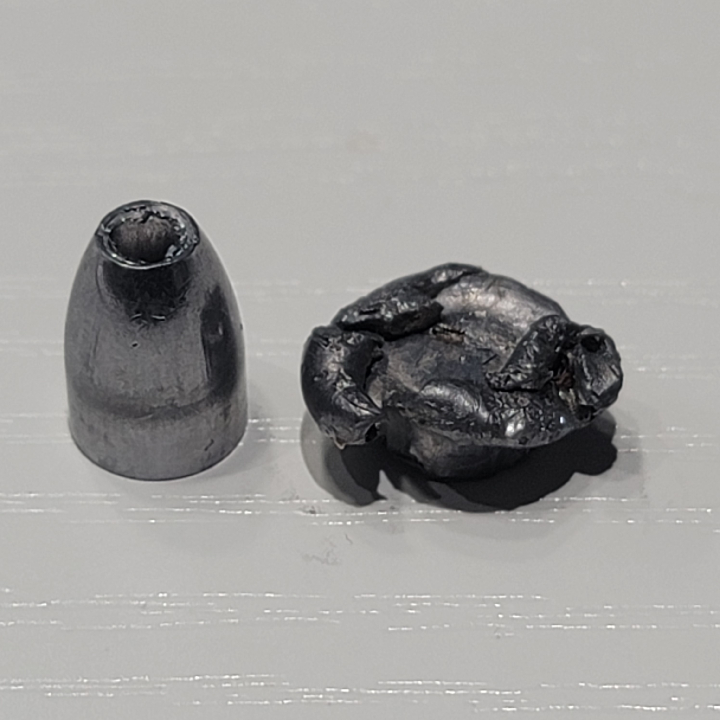

Here is a Hybrid Slug taken from 10% Clear Ballistics Gel. Here, the slug top stripped away from the base.
Not true. .30 expands like hell in a ballistic gel:
But CONSISTENT expansion on game is a different story.
Not trying to be argumentative but there are plenty of gel testing videos that show they dont reliably expand. And as you noted consistency is the key. Gel testing is showing the best case scenario for each ammo, but critters are much different. Here are 2 videos but there are more on the youtubes. Both videos pretty clearly show little to no deformation, let alone expansion. In clay they expand and fragment, but virtually everything does. This is in addition to first hand results that have shown pass throughs on critters with no signs of expansion. Maybe something like a coyote would improve our results. As I mentioned above it seems speed is very critical, and I think might they expand better at slower speeds. If we slowed them down to 800-850fps they might work better. Send them at the normal goal of 950-1050fps and the zip through. I have seen this in some target style centerfire bullets. If they go too fast they close up and act like an fmj, slow them down and they turn into little slicey bits. The 22 Cal FX Hybrids are very nice on the other hand, and my buddy has had great success with expansion.
