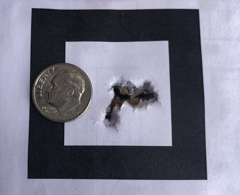

Very impressed with the regulator. The Mini has a 10” barrel and only a 135cc reservoir
That’s some dynamite
performance from the little fella! Here is an 11 shot - full mag group from 40 yards:
