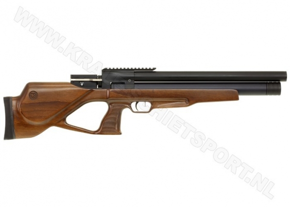

I think the addition of the plenum will help. Just look at the examples of two of my tunes; .22 Cricket Pup/17.7” barrel & .22 Cricket Carbine/21.26” barrel.
All tunes get new o’rings throughout, the lead, crown & bore polished as well as any needed adjustments to actuation system for the magazine. Rebuild and polished internals of the regulator. Lube where needed & properly rated hammer spring is also a must.
The pup has an added plenum. It received a radiused firing-valve with lighter valve-return spring & reg was adjusted to 150 bar. The action and barrel ports were not touched. The gun produces 44.7 FPE for 32 shots on a fill.
The carbine has no added plenum. It received a radiused firing-valve with lighter valve-return spring & reg was adjusted to 136 bar. All ports were opened up. The gun produces 44.2 FPE for 32 shots on a fill.
The plenum definitely is helping the pup above. It has a considerably shorter barrel but has overcome that with tuning. It is actually very efficient considering what it is and the power it’s producing. The carbine is no slouch either 😉. Both are super accurate with the 25.39 .22 RD Monsters at loooong distances to 100 yards.
