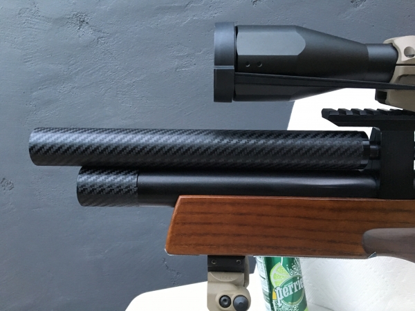

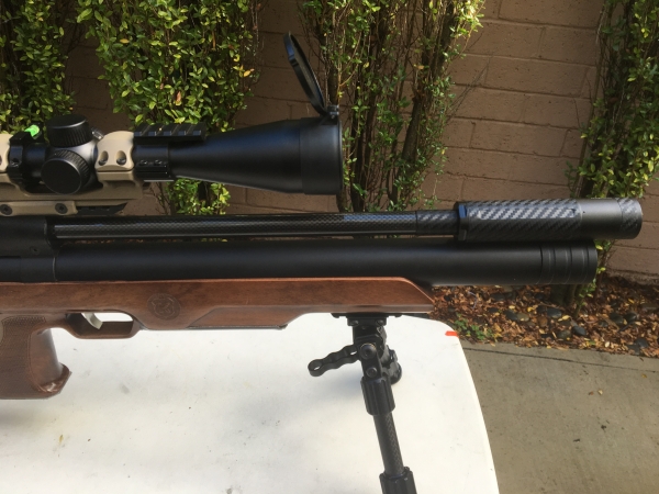

Decided I'd had enough of my POI changing every time I slightly tightened or loosened the shroud, or installed or removed my DonnyFL. So, I bought a section of carbon fiber tubing (16mm ID x 18mm OD), and used that as a non-functional shroud. The adaptor was purchased on eBay from EagleVision (model KGB-2), and the moderator is a DonnyFL .25 caliber Tanto. The gun is about as loud as it was with the stock shroud. FYI, I had tried the o-ring hack, and that was good for temperature changes and such, but the POI still changed when tighten or loosen the shroud or moderator. This way there is no tension at all on the barrel, and the gun is every bit as accurate as it was prior - which is to say, its a laser beam. Skinny shroud is CF. Adaptor and Tanto are CF wrap.

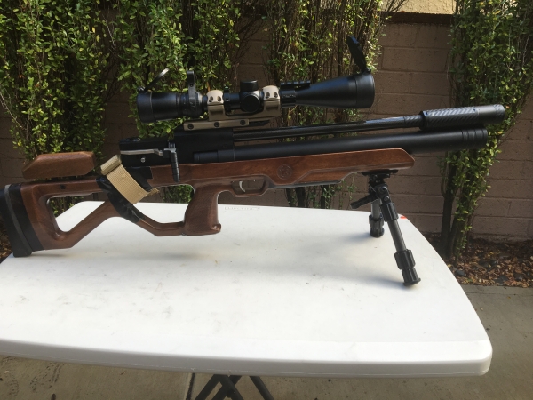

Christian,
That’s a butt pad extender. I needed the gun to be about 3/4 inch longer for off hand shooting. Nick cut out a piece of mahogany and I just drilled it out and installed it between the stock and butt pad with longer screws.
The accuracy issue with POI change wasn’t gross. I’m talking half inch at 45 yards when messing with shroud or moderator. But that’s the difference between a clean head shot or a miss at 90 yards.
The FDE color strap is for the one point sling I use when hunting. This is my primary ground squirrel rig, good out to about 125 yards.
@2manyairgunz, yes, I do own the Tactic in .25. The two guns are very similar. The Tactic is longer and heavier. Both very accurate, both have very good triggers but the Crickets trigger is as good as my Mutant. The Tactic just slightly less good. You can’t go wrong with either.
@stoti, yes, it is the Caldwell. I have two and also put one on Nicks Cricket mini. Very lightweight. Very stable and locks down well. Doesn’t have the 45 degree position. Either up or down. I recommend this one.
@douger, the CF wrap is pretty easy. Takes a little practice and you might mess up the first or second try, but it’s not too hard once you do it once or twice. Make sure you use heat like a hair dryer to make it stretch and stick better.
When I had the equipment out to CF wrap the Cricket, I also went a little CF crazy and wrapped my Taipan Mutant and the DonnyFL Tatsu, but I didn’t take a pic of it installed on the Mutant.
