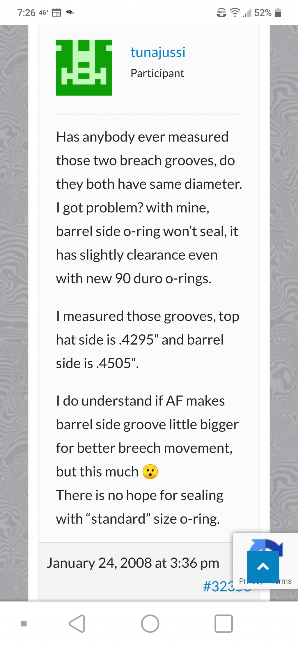

Something that could measure glands would be great as old ones taken out aren't true anymore.

JamesD. Member Dec 9, 2015 2,596 330 NE PA, United States Feb 17, 2021 Add bookmark #3 Feb 17, 2021 Add bookmark #3 Yeah I see #11 or 7.8x1.9 being closest. Might need to purposely swell some. A custom breech fit to a new barrel could fix any doubt as to if the seal could be any better. Upvote 0

shambozzie Member Jul 12, 2016 3,053 1 3,325 South carolina, United States Feb 17, 2021 Add bookmark #4 Feb 17, 2021 Add bookmark #4 You don't have to worry about seal. When the trigger is pulled the blast of air cause the orings to expand and seal . Upvote 0

JamesD. Member Dec 9, 2015 2,596 330 NE PA, United States Feb 25, 2021 Add bookmark #5 Feb 25, 2021 Add bookmark #5 It's a #011 5/16 x 7/16 x 1/16 70duro Reactions: RM.510bigbore Upvote 1
