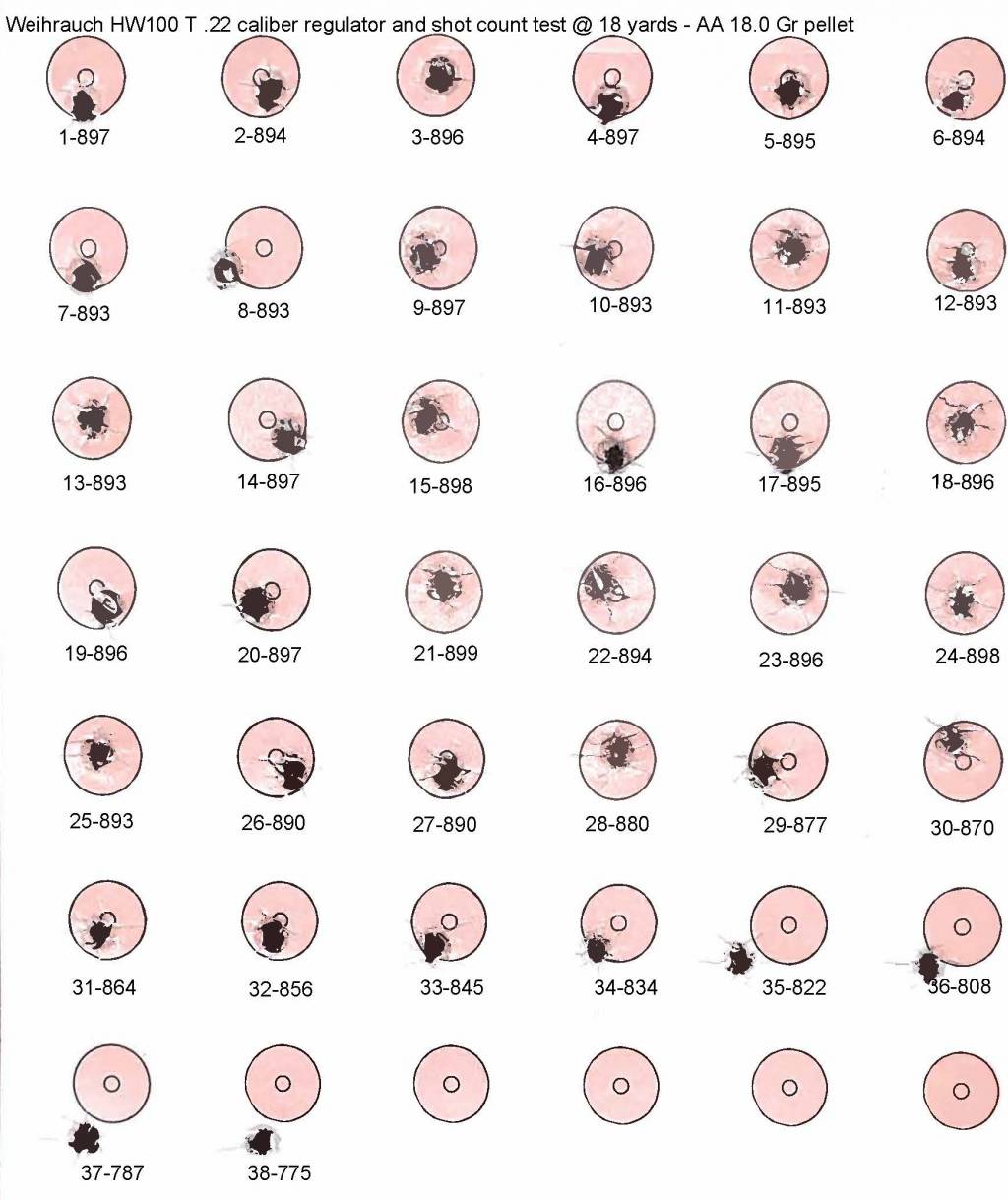

  • as you will see in the following exhibits, the regulator drops off on the 27th shot. Not much shot count, though as accurate as this platform is, for hunting use, I shouldn't ever need two magazines to take a limit of anything.

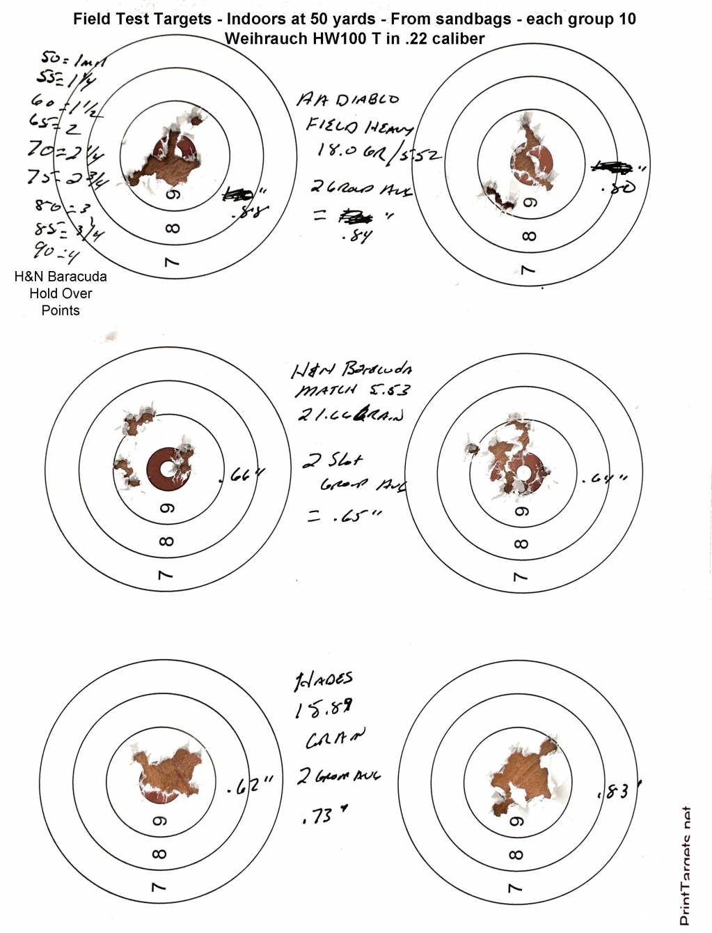

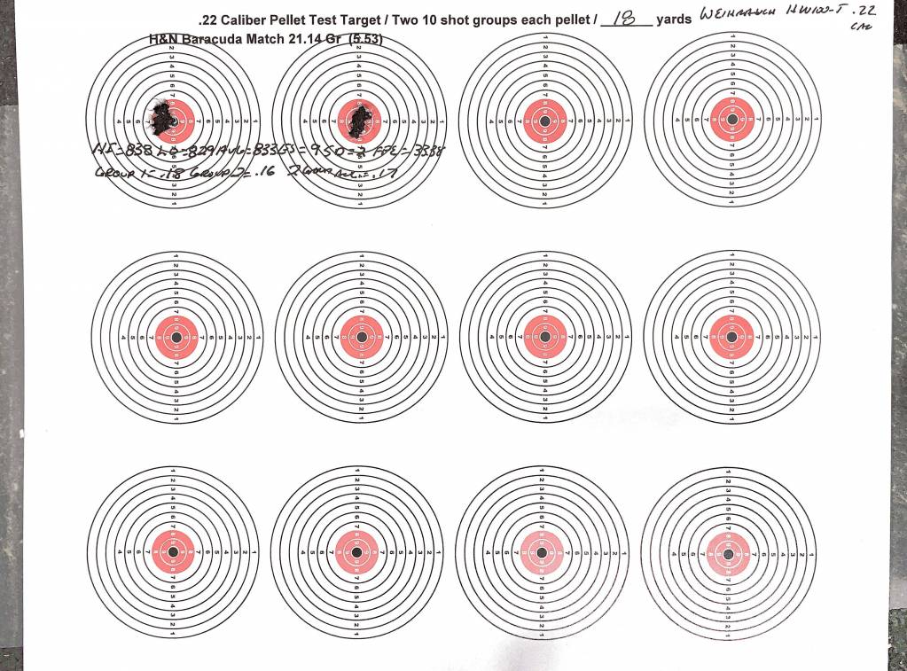

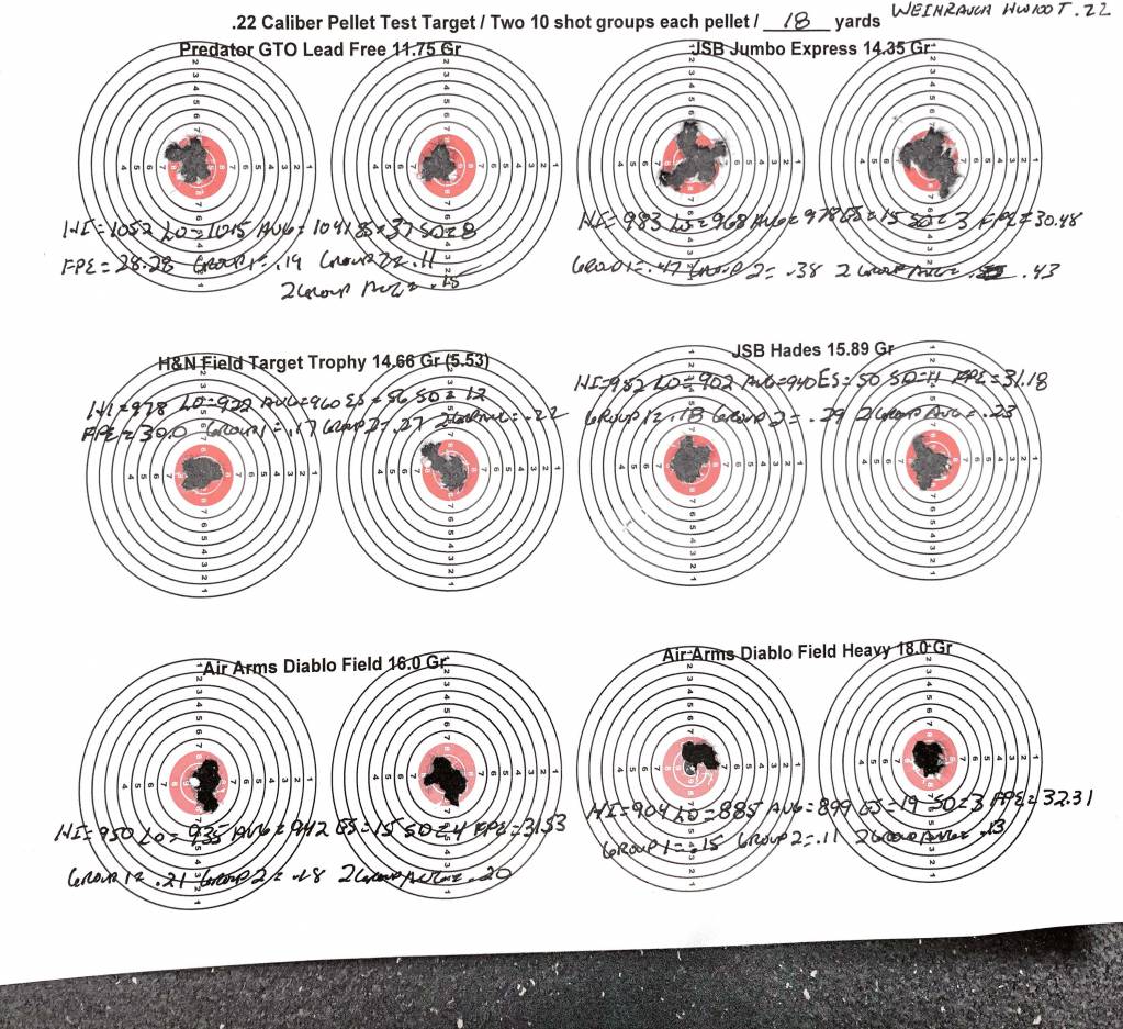

You can see how well it shoots by looking at the supplied images below. At 18 yards, all but one of the tested pellets 10 shot group averages of <.30 inches C-T-C. At 50 yards, the accuracy and core groups were very good. I even shot one group at 90 yards that measured approximately 1 1/4."
I'm certain the shot count could be increased if I would turn down the power, but the rifle is shooting so accurately, and even with the 21.66 Gr Baracuda Match the hold over is only 4M, so I believe I am content to live with the shot count.

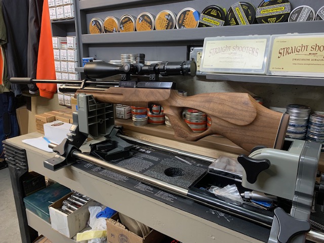

Shot count. Yes, like most European rifles, it is designed on a 12 fpe platform, so our demand for power becomes an issue for shot count. I recently detuned my .177 carbine, turning down both the reg and HST until I found a balanced tune at around 14 fpe. I haven't done a complete shoot down, but I know the count is significantly increased, I'm estimating 80+, from a fill to the reg set point. The good news, this rifle is easy to tune, so just grab your tool kit and chrono and have fun!
