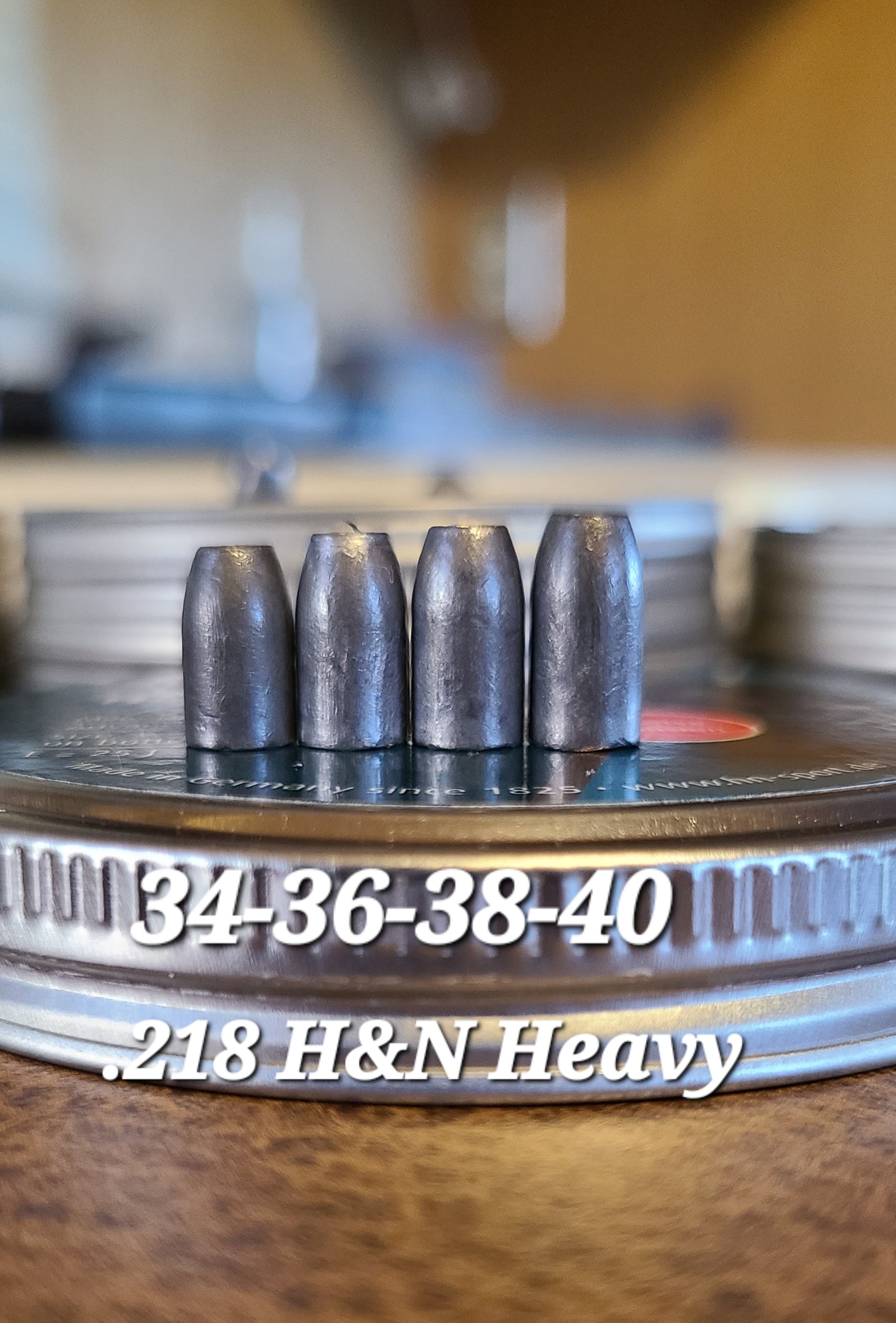

Maybe try some. 218 34gr H&N Heavy slugs.
Your Impact should easily shoot those 1000+fps
