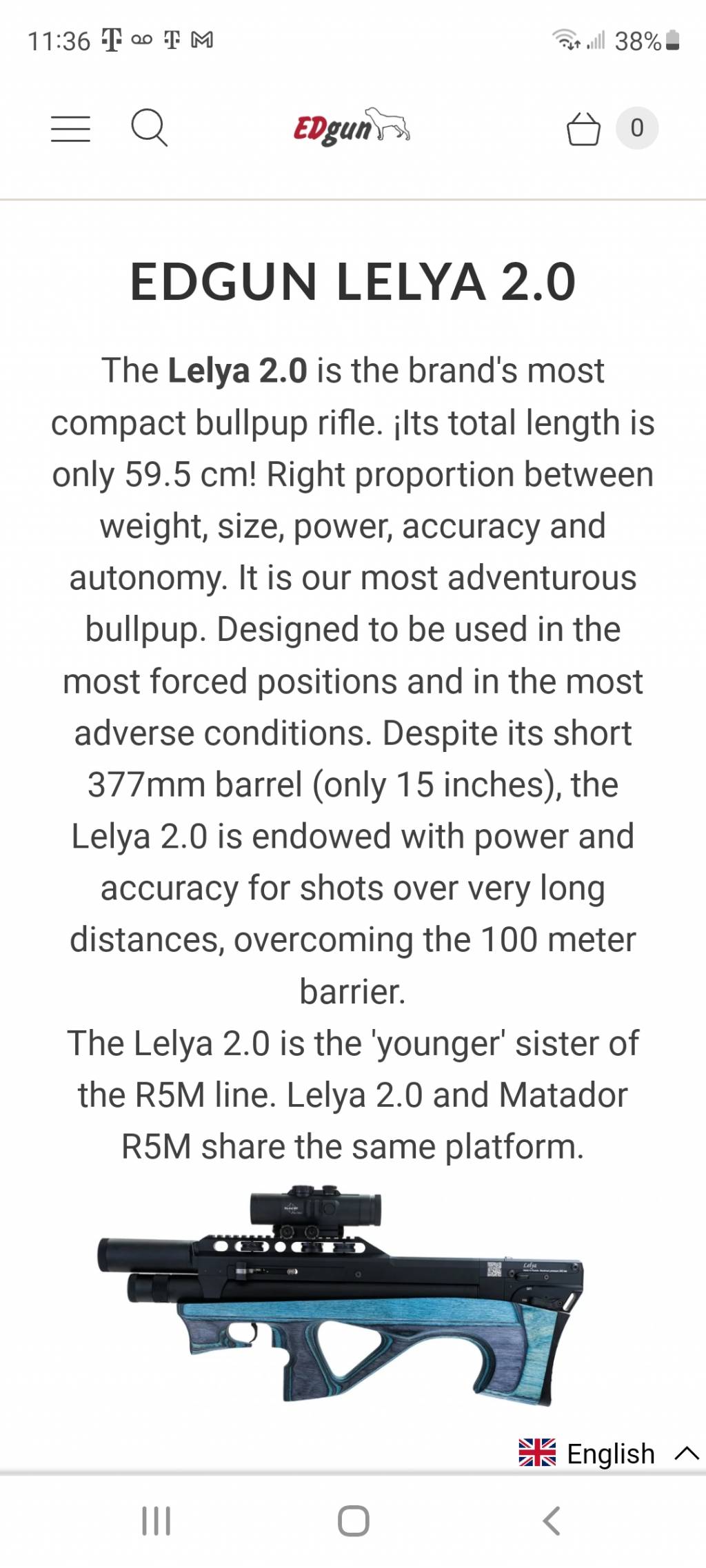

No a benchrest gun, but I was so impressed by the accuracy of this little guy with a 15" bbl I got one on the way in .22.
