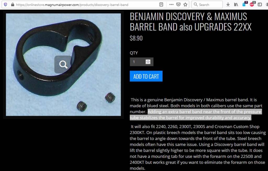

...and another video that I really didn't understand where the owner of TKO does something to the barrel band. What are the benefits of what they are doing?
Important that the barrel band is secured to the air tube, if it moves it will change to point of impact, could be he secured it with another screw or added an extra one
