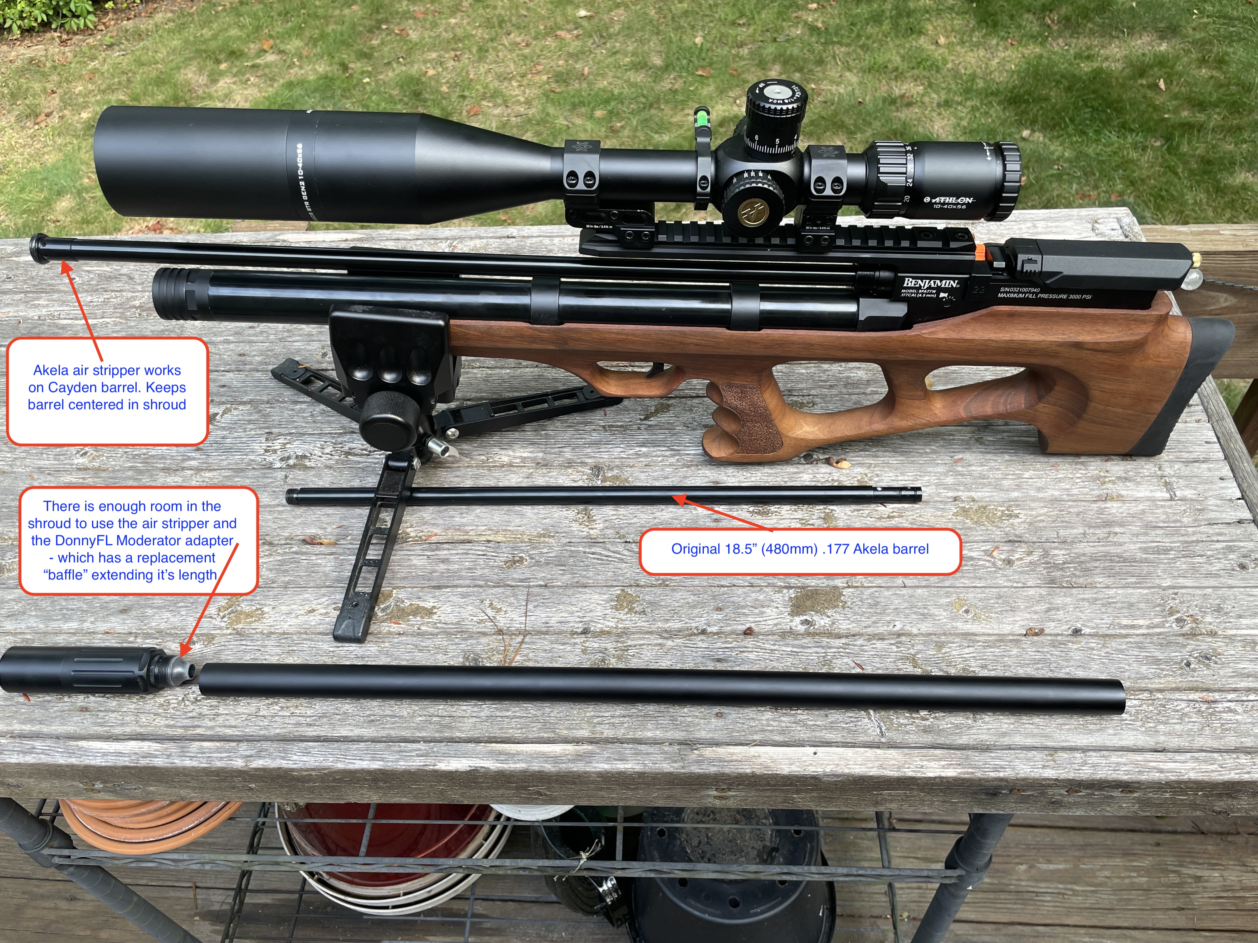

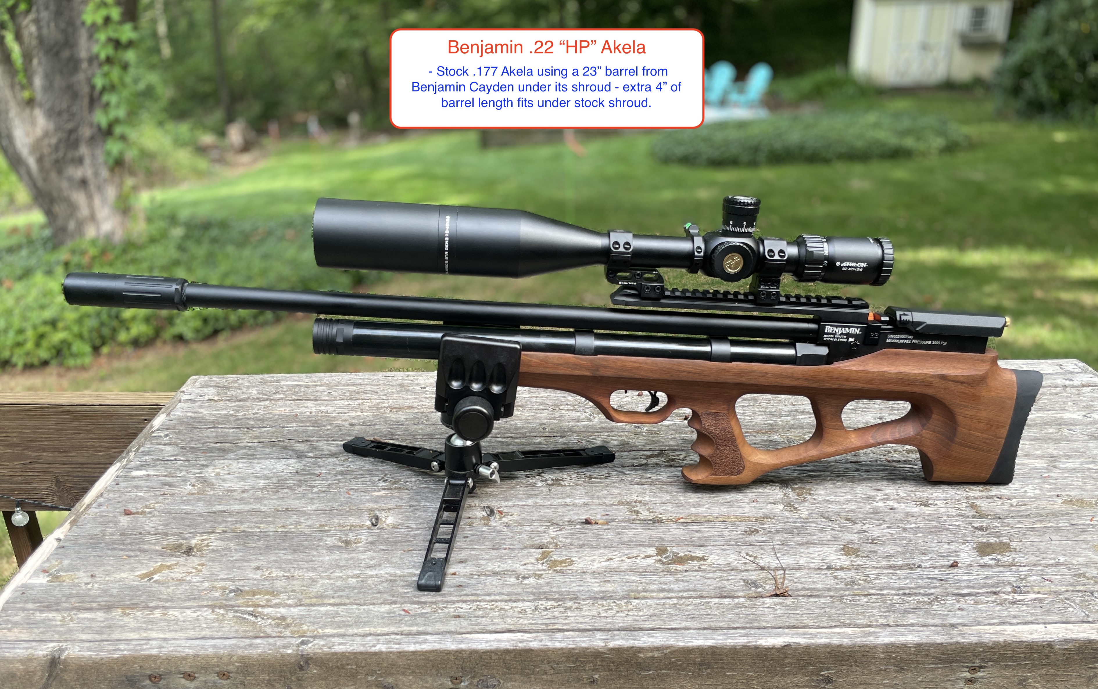

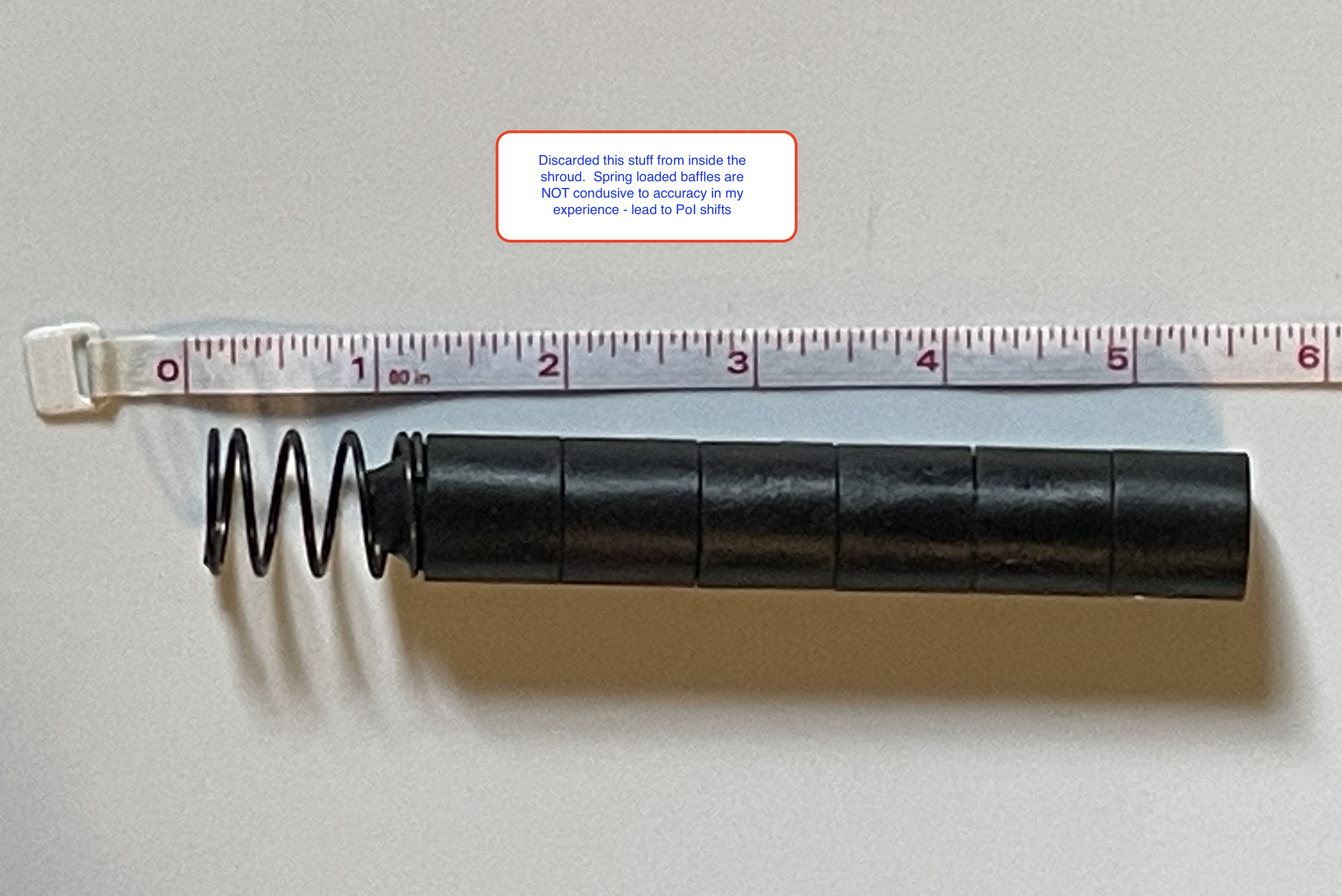

I had a refurb .177 Akela that I had not shot yet. I measured the barrels and the 4 inch longer Cayden barrel fits under the stock Akela shroud - once you discard the baffles and spring. It fits using both the Akela air stripper (to keep Cayden barrel centered in shroud) and with the DonnyFL moderator adapter for the Akela - which extends into the shroud a bit due to replacement "baffe" in its design.

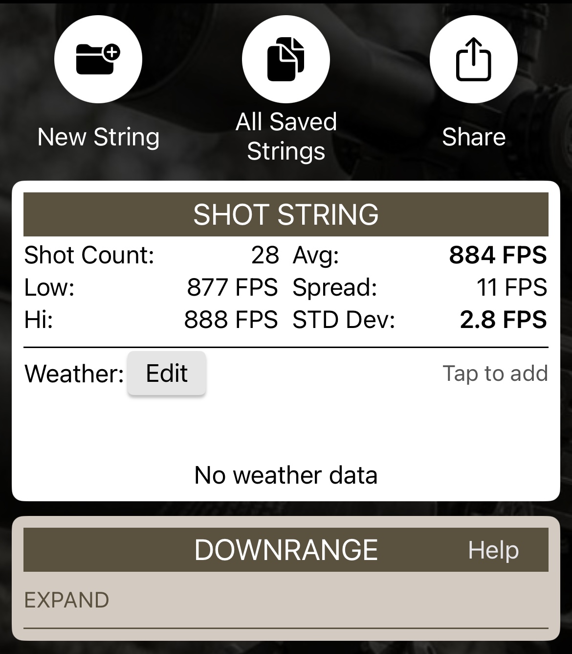

I'm using a stock Benjamin hammer spring - cut to 2.68". I guessed and turned in the hammer spring exactly 1 turn - and using my fill pressure of 2,600 psi, I was immediately at 880fps with AEA 15.9g (barrel when on Cayden liked AEA 15.9s). Lucky guess on setting the hammer spring, but I'd rather be lucky than good when anxious to try shooting a new build.
.22 Akela "HP" or is it a "Caydela" is now VERY quiet shooting 15.9g @ 880-890fps - using only 2 sections of a Huma Mod30.

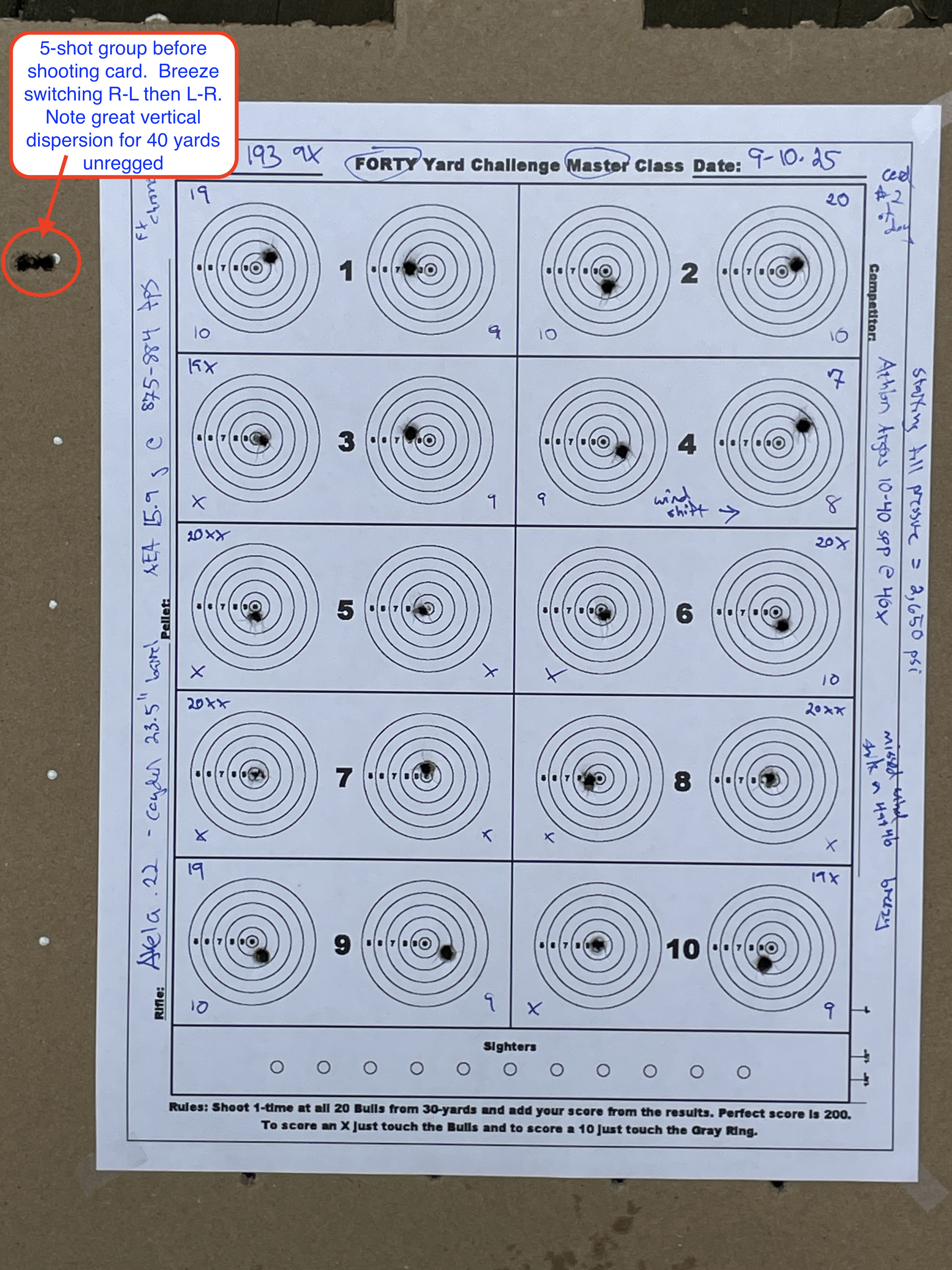

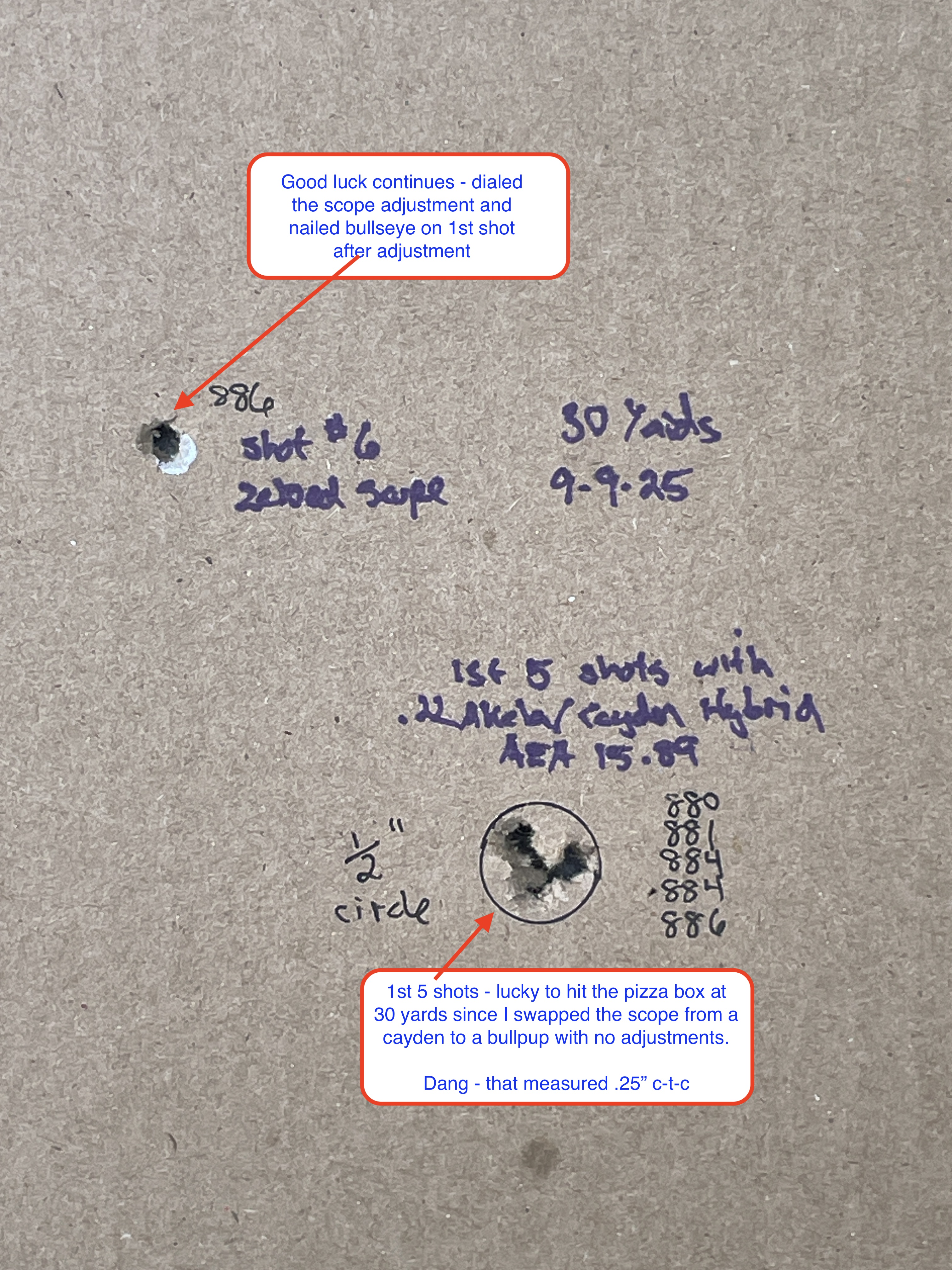

It immediately shot a 1/4 inch c-t-c 5-shot group at 30 yards. Took one shot to adjust scope. Then fired shots 7 to 26 at this 30-Masters card and shot 198 !! Dang - thats an unregulated "budget" rifle. If you are shooting 30-Masters cards with a $2,000 air rifle you know that 198 is a darn good score.

So, essentially I swapped the long (600mm) .22 Cayden barrel and .22 cocking level/probe into a .177 Akela. As I've shown in the previous build, the long Cayden barrel fits fine under the stock Akela (or Kratos) shroud - once you ditch the spring and baffles (they adversely effect accuracy anyways).
